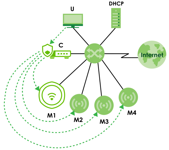

The following figure illustrates a wireless network managed by an APC. You (U) configure the APC (C), which then automatically updates the configurations of the managed APs (M1-M4).
Controller Managed AP Application

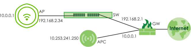

How the Zyxel Device find the APC
The figure below shows how the Zyxel Device find the APC.
The above topology shows a Gateway (GW) with 2 IP interfaces configured:
Interface 1 with IP address 10.0.0.1/255.0.0.0 connects to an Access Point Controller (APC)
Interface 2 with IP address 192.168.2.1/255.255.255.0 connects to a Switch (SW).
To allow the AP (the Zyxel Device) to be discoverable by the APC, do the following in the Zyxel Device Web Configurator:
1 Log into the Web Configurator and select controller managed mode.
2 Do one of the following:
Configure 10.253.241.250/255.0.0.0 as the IP address of APC Discovery on the AP. (see APC Discovery)
Configure 10.253.241.250/255.0.0.0 as the IP address of DHCP Server Option 138 on the GW. Refer to your gateway’s User Guide for instructions on configuring the IP address for DHCP Server Option 138.
DHCP Server Option 138 provides the IP address of an APC to the Zyxel Device, allowing the Zyxel Device to find and connect to the APC.
