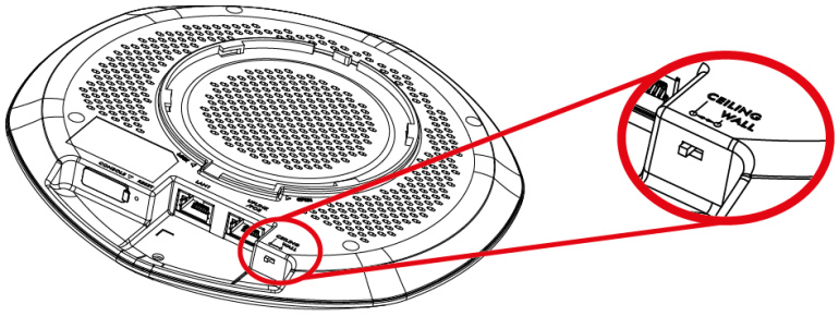

Physical Antenna Switch
*With the physical antenna switch, you apply the same antenna orientation settings to both radios. You can set the radios to have different settings while using the Web Configurator or the command line interface.
*The antenna switch in the Web Configurator has priority over the physical antenna switch after you Enable Software Control in the Maintenance > Antenna screen. By default, software control is disabled.
