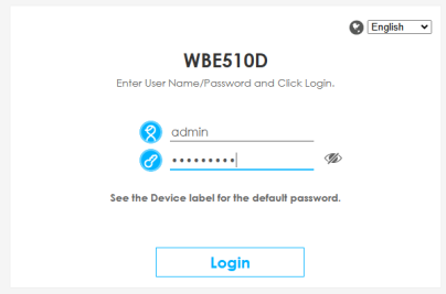

3 Enter the user name (default: “admin”) and default password. The default password is unique to each Zyxel Device and shown on the label. If your Zyxel Device does not have a password on the label, use “1234”.
4 Select the language you prefer for the Web Configurator. Click Login.

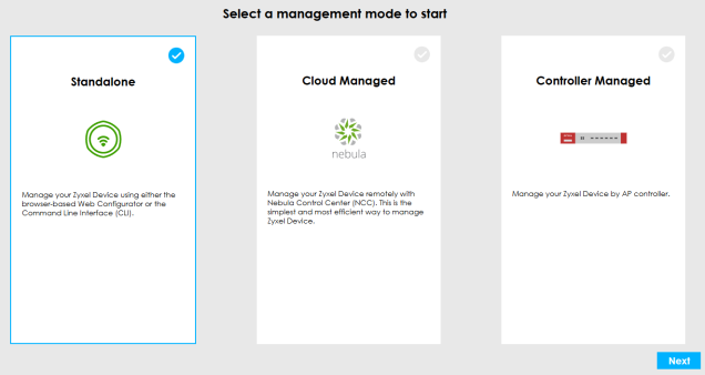

5 Select a management mode. Select
Standalone if you use the Web Configurator to manage your Zyxel Device. Select
Could Managed if you use NCC to manage your Zyxel Device. Select
Controller Managed if you use an APC to manage your Zyxel Device. Refer to
Management Mode for more information about management mode. Click
Next.

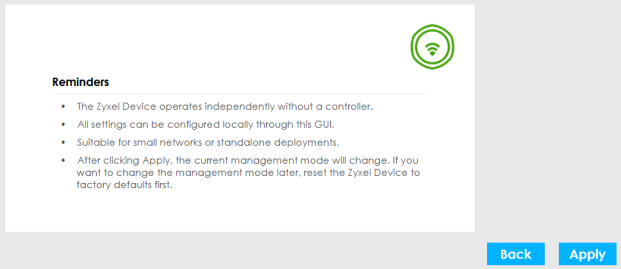

6 Check the
Reminders on the screen. Click
Apply. If you select
Cloud Managed or
Controller Managed, refer to Nebula Control Center (NCC) or your AP Controller (APC) to manage your Zyxel Device (see
Ways to Access the Zyxel Device for more information). If you select
Standalone, continue with the steps below.

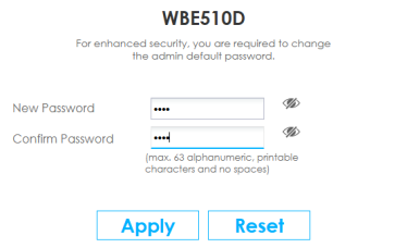

7 Set up a new password containing 4 to 63 printable characters. Spaces are not allowed. Click Apply.
8 Log in again with the user name (default: “admin”) and the new password. Click Login.

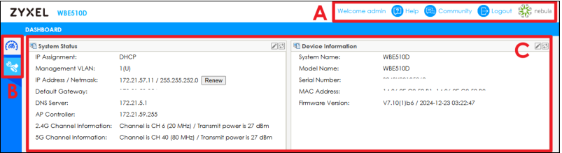

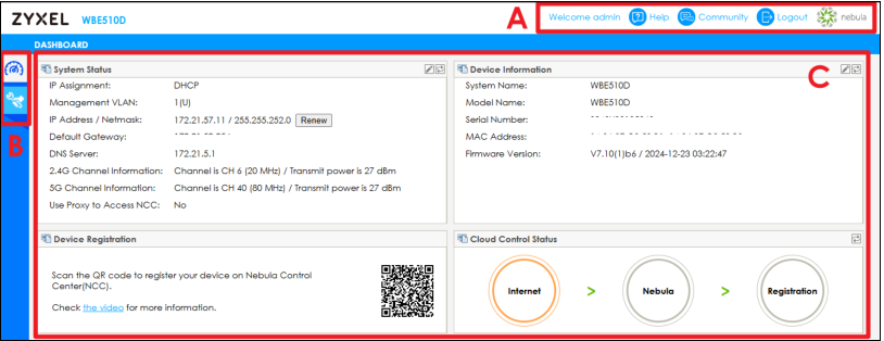

Navigating the Web Configurator

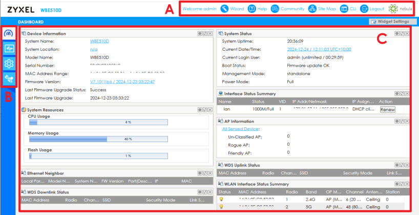

The following summarizes how to navigate the Web Configurator from the Dashboard screen. The figures below show the Dashboard screen in standalone mode, cloud managed mode, and controller managed mode. The screen layout may differ slightly depending on the mode and device model.
The Web Configurator’s main screen is divided into these parts:
• A - Title Bar
• B - Navigation Panel
• C - Main Window
Title Bar
The title bar provides some useful links that always appear over the screens below, regardless of how deep into the Web Configurator you navigate. If your Zyxel Device is in cloud managed mode or controller managed mode, not all icons will be available in the title Bar.
The icons provide the following functions.
Title Bar: Web Configurator Icons
Label | Description |
Wizard | Click this to open the wizard. See Accessing the Wizard for more information. |
Help | Click this to open the help page for the current screen. |
Community | Click this to log into the Zyxel forum to post questions, contribute to a discussion and get feedback on Zyxel Device. |
Site Map | Click this to see an overview of links to the Web Configurator screens. |
CLI | Click this to open a popup window that displays the CLI commands sent by the Web Configurator. |
Logout | Click this to log out of the Web Configurator. |
nebula | Click this to open the NCC web site login page in a new tab or window. |

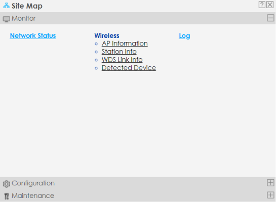

Site Map
Click Site MAP to see an overview of links to the Web Configurator screens. Click a screen’s link to go to that screen.

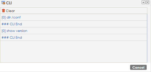

CLI Messages
Click CLI to look at the CLI commands sent by the Web Configurator. These commands appear in a popup window, such as the following.
Click Clear to remove the currently displayed information.
See the Command Reference Guide for information about the commands.

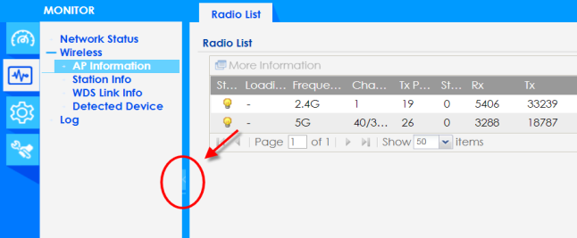

Navigation Panel
Use the menu items on the navigation panel to open screens to configure Zyxel Device features. Click the arrow in the middle of the right edge of the navigation panel to hide the navigation panel menus or drag it to resize them. The following sections introduce the Zyxel Device’s navigation panel menus and their screens.
Standalone Mode Navigation Panel Menus
The following are the screens available in standalone mode. Note that some screens may not be available for your Zyxel Device model. See
Zyxel Device Product Feature Comparison to see which features your Zyxel Device model supports.

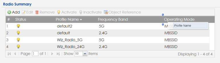

The Web Configurator tables and lists are quite flexible and provide several options for how to display their entries.

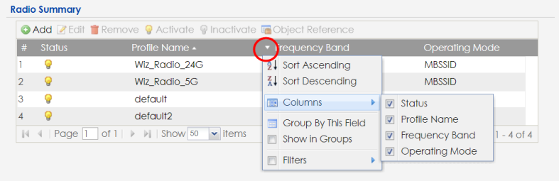

Manipulating Table Display
Here are some of the ways you can manipulate the Web Configurator tables.

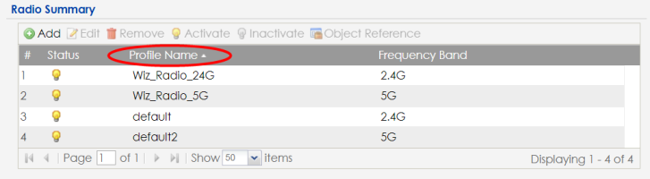

1 Click a column heading to sort the table’s entries according to that column’s criteria.
2 Click the down arrow next to a column heading for more options about how to display the entries. The options available vary depending on the type of fields in the column. Here are some examples of what you can do:

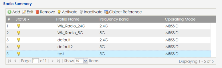

Working with Table Entries
The tables have icons for working with table entries. A sample is shown next. You can often use the [Shift] or [Ctrl] key to select multiple entries to remove, activate, or deactivate.
Here are descriptions for the most common table icons.
Common Table Icons
Add | Click this to create a new entry. For features where the entry’s position in the numbered list is important (features where the Zyxel Device applies the table’s entries in order like the firewall for example), you can select an entry and click Add to create a new entry after the selected entry. |
Edit | Double-click an entry or select it and click Edit to open a screen where you can modify the entry’s settings. In some tables you can just click a table entry and edit it directly in the table. For those types of tables small red triangles display for table entries with changes that you have not yet applied. |
Remove | To remove an entry, select it and click Remove. The Zyxel Device confirms you want to remove it before doing so. |
Activate | To turn on an entry, select it and click Activate. |
Inactivate | To turn off an entry, select it and click Inactivate. |
Object Reference | Select an entry and click Object Reference to open a screen that shows which settings use the entry. |
