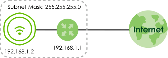

This describes how you can configure the management IP address and VLAN settings of your Zyxel Device.
IP Setup
IP Setting
Use this screen to configure the IP address for your Zyxel Device.
Each field is described in the following table.
Configuration > Network > IP Setting

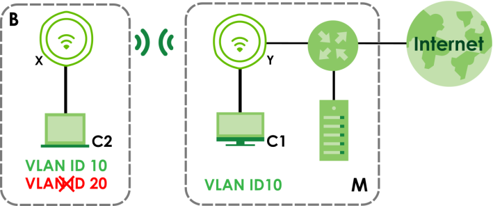

Wireless Bridge VLAN ID
Wireless bridge VLAN allows you to have clients in different WiFi networks appear to be in the same virtual network using VLAN IDs. VLAN IDs are sent across the wireless bridge so that only clients with the same VLAN ID receive that network traffic. See Zyxel Device Roles for more information on the wireless bridge.
In the figure below, a client (C2) in the branch office (B) wants to connect to the main office (M). The branch office client (C2) can connect to the main office network using the VLAN ID 10. However, the branch office client (C2) cannot connect to the to the main office network using the VLAN ID 20 because that VLAN ID does not exist in the main office network. To bridge the branch office network and the main office network, the VLAN IDs you set on the Zyxel Device (X) should be the same as the VLAN IDs you set on the root AP (Y).
Wireless Bridge VLAN ID Example
