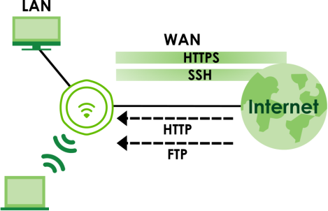

WWW
The following figure shows secure and insecure management of the Zyxel Device coming in from the WAN. HTTPS and SSH access are secure. HTTP and FTP management access are not secure.
Secure and Insecure Service Access From the WAN
*If you disable HTTP in the WWW screen, then the Zyxel Device blocks all HTTP connection attempts.

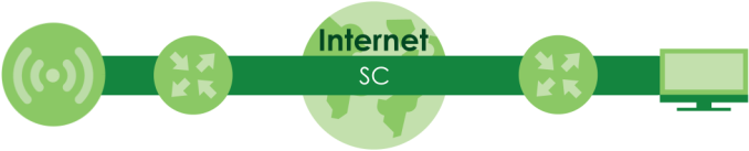

SSH Communication Over the WAN Example
How SSH Works
The following figure is an example of how a secure connection is established between two remote hosts using SSH v1.

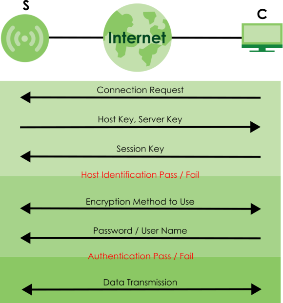

How SSH v1 Works Example
1 Host Identification
The SSH client (C) sends a connection request to the SSH server (S). The server identifies itself with a host key. The client encrypts a randomly generated session key with the host key and server key and sends the result back to the server.
The client automatically saves any new server public keys. In subsequent connections, the server public key is checked against the saved version on the client computer.
2 Encryption Method
Once the identification is verified, both the client and server must agree on the type of encryption method to use.
3 Authentication and Data Transmission
After the identification is verified and data encryption activated, a secure tunnel is established between the client and the server. The client then sends its authentication information (user name and password) to the server to log in to the server.
