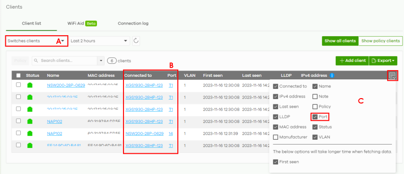

Method 1:
1 Go to Site-wide > Clients > Client list tab and select Switches clients (A) to filter the list of clients based on the type of Nebula Device.
2 Locate the Port column (B) to know the port to which the client is connected.
*If you do not find the Port column (B), click the icon (C) and select Port to display the Port column (B).

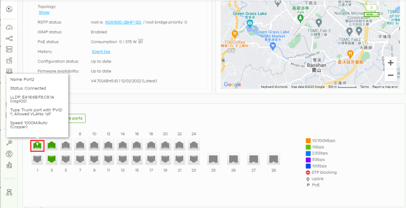

Method 2:

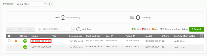

1 Go to Site-wide > Devices > Switches and click the Name of the Switch to go to the Switch details screen.
2 Scroll down to the Ports section and hover the mouse over a port to know which client is connected.

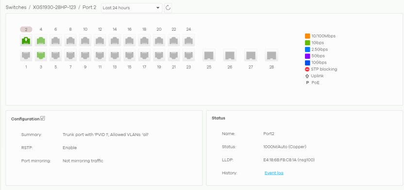

3 Click the port to go to the Switch port details screen to view the individual Nebula Device port statistics.
