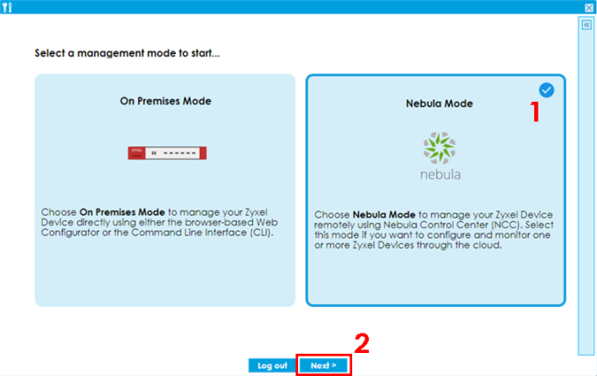

1 Log into the SF Web Configurator (see the SF user’s guide for more information). When you log into the Web Configurator, the Initial Setup Wizard screen displays.
2 Select Nebula Mode and click Next.

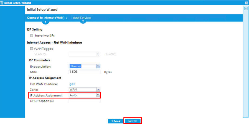

3 Configure the WAN settings and click Next.

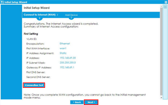

4 Click Connection Test to check that you can access the Internet and then click Next.

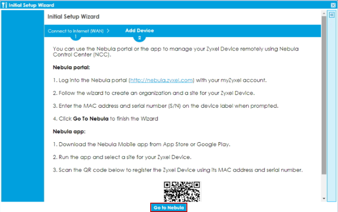

5 Click Go to Nebula.

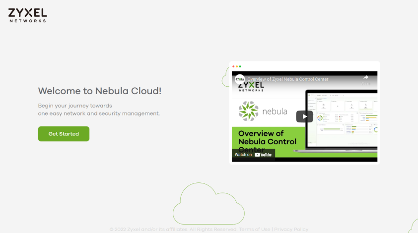

Nebula Configuration

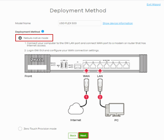

1 You will be redirected to the Nebula portal. Click Get Started.
2 Use the Setup Wizard to create an organization and a site, and add the Nebula Device. See Setup Wizard for more information on using the wizard.
*Make sure to select Nebula native mode as the Deployment Method in the Setup Wizard.

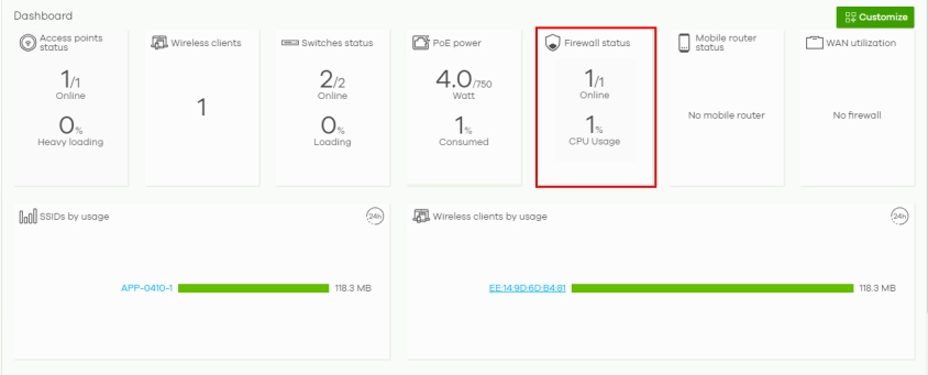

3 After configuring the Setup Wizard, close the Nebula Control Center welcome message to go to the Nebula portal dashboard. 1/1 Online will show on Firewall Status. This means that one SF is registered in Nebula and is online.
