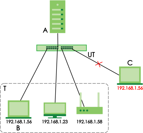

The following figure demonstrates a scenario with DHCP snooping and ARP inspection enabled. In this scenario, we connect an authorized DHCP server (A) and the client devices on the ARP trusted ports (T). A client device (B) is assigned the IP address 192.168.1.56 by the authorized DHCP server (A). A malicious host (C) on an untrusted port (UT) puts a wrong MAC address with the IP address 192.168.1.56 in an ARP reply packet pretending to be client device (B) (192.168.1.56). The Nebula Device snoops DHCP packets sent from the authorized DHCP server (A) and creates bindings in the binding table. When the Nebula Device receives ARP packets from an untrusted port (UT), it compares the IP and MAC addresses with the existing bindings. Since the IP and MAC binding is different from the existing bindings, the Nebula Device blocks the unauthorized ARP packets sent from the malicious host (C). The malicious host (C) therefore cannot disguise as client device (B) to build connections with other client devices on your network.

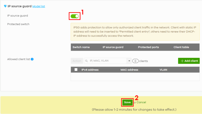

1 Go to Site-wide > Configure > Switches > Switch settings. Slide the switch to enable IP source guard for the Nebula Devices in your site. Then click Save. The Protected switch and Allowed client list will appear. The Protected switch information synchronizes with the port’s IPSG Protected setting in Site-wide > Configure > Switches > Switch ports. It will display the enabled ports.

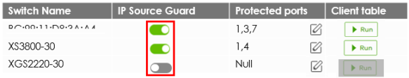

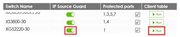

2 Click the IP Source Guard switch to enable/disable IP source guard for the specific registered Nebula Device(s) in your site.

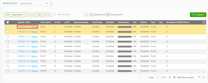

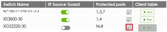

3 Click the edit icon to go to Site-wide > Configure > Switches > Switch ports to configure Protected ports for the Nebula Device. A port is protected if IPSG protected is enabled on this port.
4 Click to select the port you want to enable IP source guard.
*Do NOT configure IPSG on an uplink port as this may cause disconnection between the client device and Nebula.
To restore connection on an uplink port, go to Site-wide > Configure > Switches > Switch ports to select the uplink port. In the Update 1 port screen select Disabled in IPSG protected. Then reset the Nebula Device to its factory-default setting (see the Nebula Device’s User’s Guide for more information).

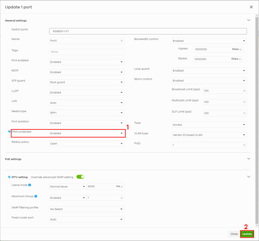

5 In the Update port screen, select Enabled in IPSG protected. The IPSG protected field in the Site-wide > Configure > Switches > Switch ports table for the updated port will display Enabled.
6 Click Run.

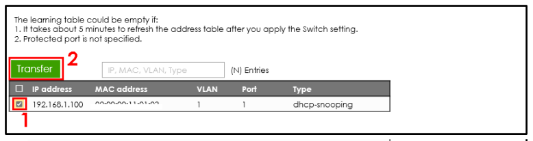

7 A merged list window appears. Click to select the port and then click Transfer.

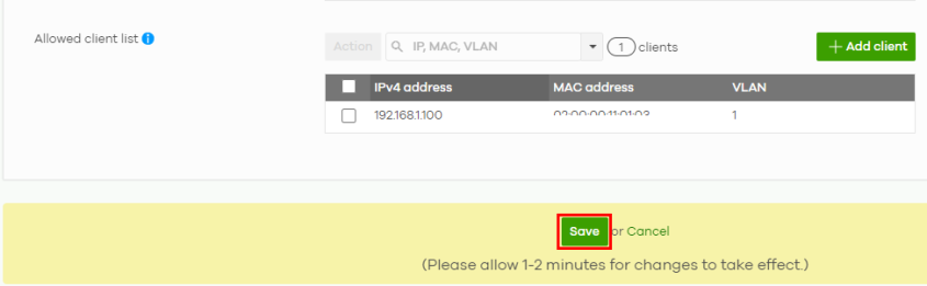

8 The port with the particular IP and MAC addresses is added to the Allowed client list. Click Save.
