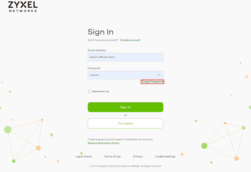

1 In the Nebula portal Sign In page, click Forgot Password.

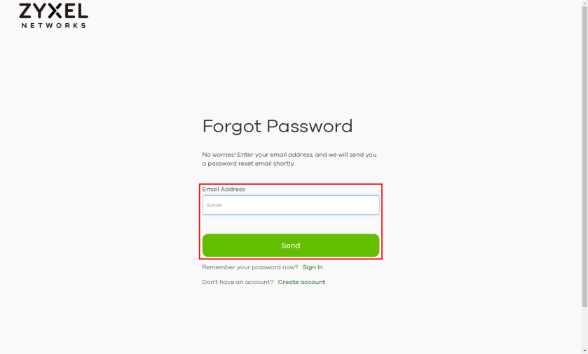

2 Enter your Zyxel Account’s email address, and then click Send.

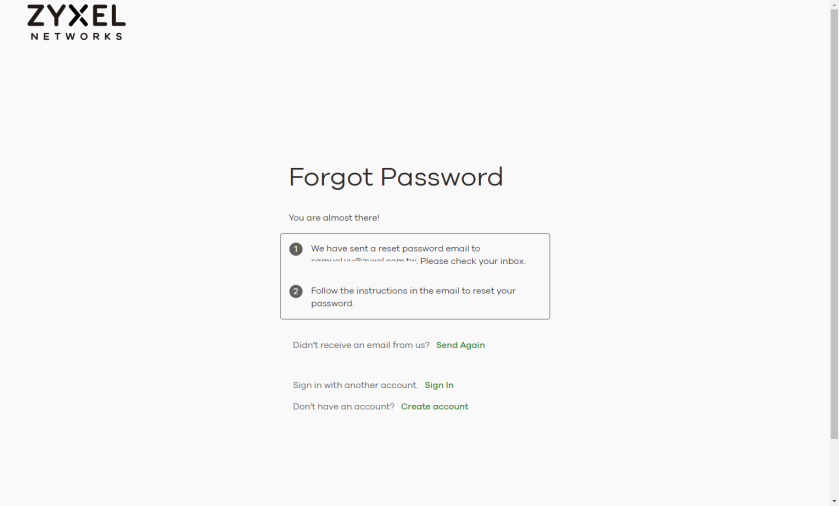

A reset password email has been sent notification appears.

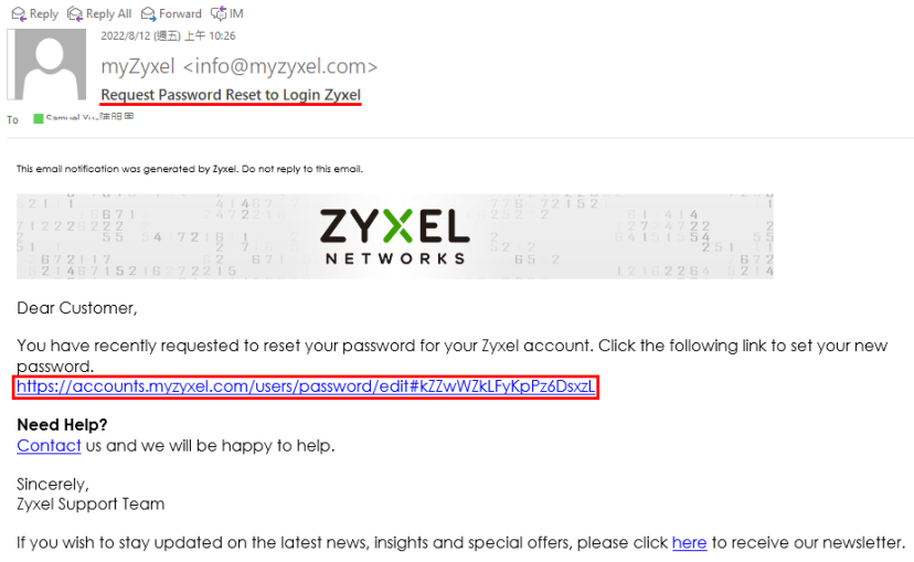

3 Click the link in the Request Password Reset to Login Zyxel email.

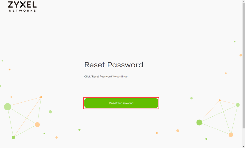

4 The following screen appears. Click Reset Password.

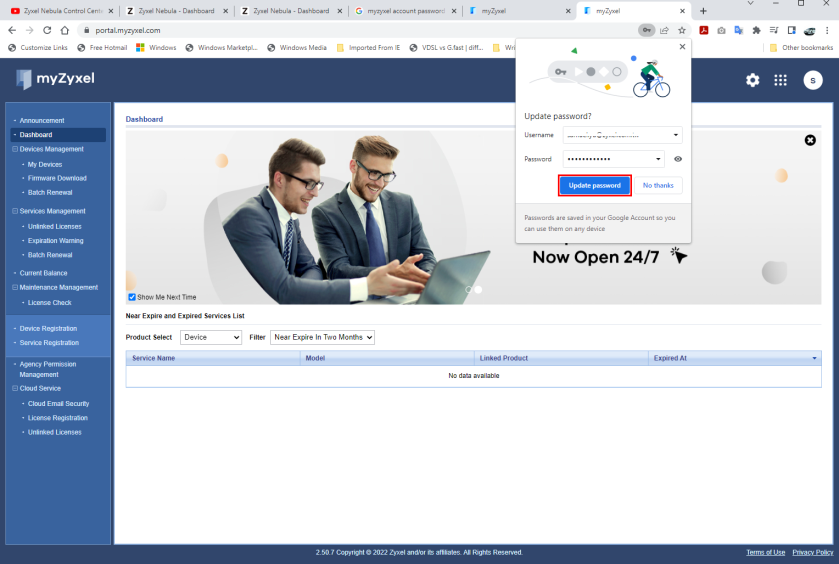

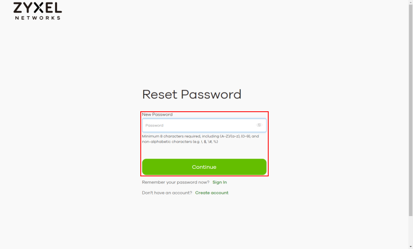

5 Enter the New Password. Use a minimum of 8 characters, including 0–9 a–z A–Z `~!@#$%&*(_+-={}|[];'"./<> ?). Then click Continue.
6 You will be transferred to the myZyxel portal. Click Update password.

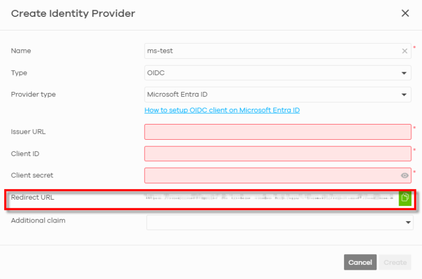

1 Go to Organization-wide > Organization-wide manage > Nebula identity federation service > Identity provider. In the configured Identity Provider, copy the Redirect URL. You will need this later.

4 Configure the Identity Provider in NCC. Go to Create Identity Provider in NCC as shown above and enter the following details:
• Issuer URL: https://login.microsoftonline.com/<tenant_id>/v2.0
• Client ID: <Application (client) ID>
• Client Secret: <Client Secret Value>
Click Save to complete the Identity Provider configuration.
