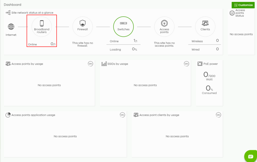

1 Use the Setup Wizard to create an organization and a site, and add the Nebula Device. See Setup Wizard for more information on using the wizard.
2 After configuring the Setup Wizard, close the Nebula Control Center welcome message to go to the Nebula portal dashboard. 0/1 Online will show on Broadband router. This means that one Nebula Device (broadband router) is registered in Nebula but not yet online.

Check the Connection in Nebula
1 Go to Site-wide > Dashboard. 1/1 Online will show in Broadband router. This means that one Nebula Device (broadband router) is registered in Nebula and is online.
2 Click Broadband router to monitor the Nebula Device’s status.
