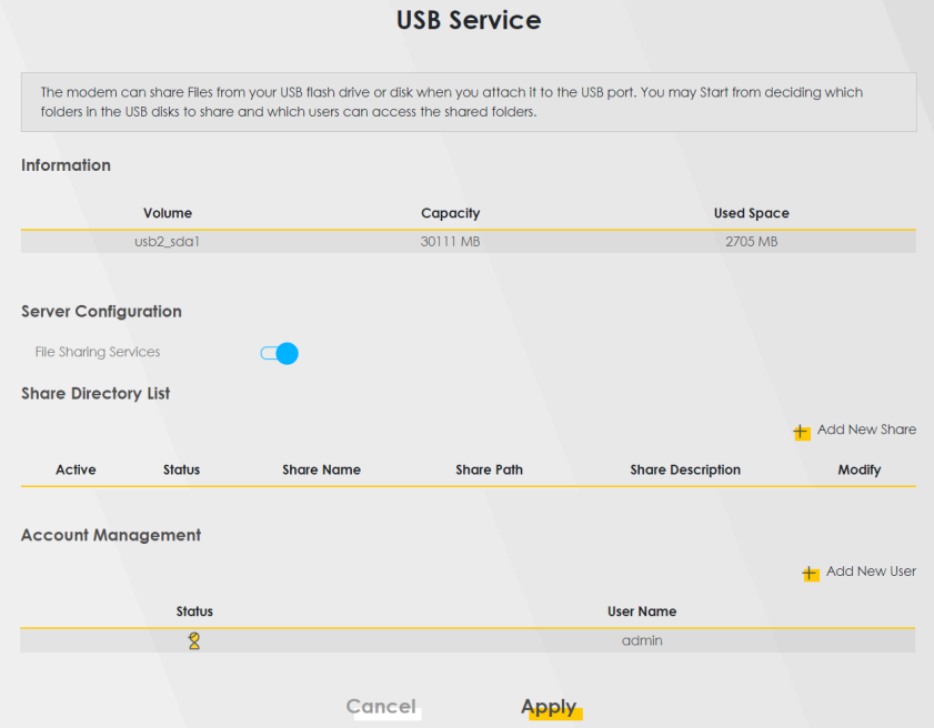

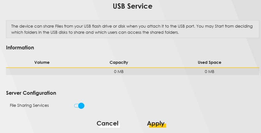

USB Service
Use this screen to set up file sharing through the Zyxel Device. The Zyxel Device’s LAN users can access the shared folder (or share) from the USB device inserted in the Zyxel Device. To access this screen, click Network Setting > USB Service > File Sharing.
*The Share Directory List is only visible when you connect a USB device.
Each field is described in the following table.
LABEL
DESCRIPTION
Information
Volume
This is the volume name the Zyxel Device gives to an inserted USB device.
Capacity
This is the total available memory size (in megabytes) on the USB device.
Used Space
This is the memory size (in megabytes) already used on the USB device.
Server Configuration
File Sharing Services
Click this switch to enable file sharing through the Zyxel Device.
This only appears when you have inserted a USB device.
Add New Share
Click this to set up a new share on the Zyxel Device.
Active
Select this to allow the share to be accessed.
Status
This field displays the status of the share.
: The share is not activated.
: The share is activated.
Share Name
This field displays the name of the file you shared.
Share Path
This field displays the location in the USB of the file you shared.
Share Description
This field displays a description of the file you shared.
Modify
Click the Edit icon to change the settings of an existing share.
Click the Delete icon to delete this share in the list.
Account Management
Add New User
Click this button to create a user account to access the secured shares. This button redirects you to Maintenance > User Account.
Status
This field displays the status of the user.
: The user account is not activated for the share.
: The user account is activated for the share.
User Name
This is the name of a user who is allowed to access the secured shares on the USB device.
Cancel
Click this to restore your previously saved settings.
Apply
Click this to save your changes to the Zyxel Device.

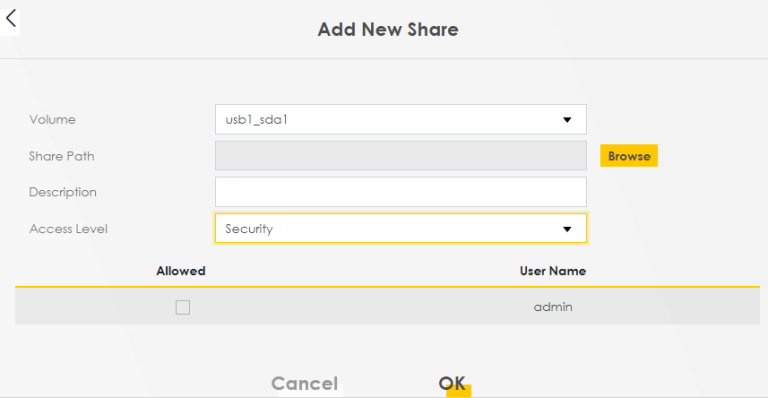

Add New Share
Use this screen to set up a new share or edit an existing share on the Zyxel Device. Click Add New Share in the File Sharing screen or click the Edit or Modify icon next to an existing share.
Please note that you need to set up shared folders on the USB device before enabling file sharing in the Zyxel Device. Spaces and the following special characters, [ " ], [ ` ], [ ' ], [ < ], [ > ], [ ^ ], [ $ ], [ | ], [ & ], [ ; ], are not allowed for the USB share name.
Network Setting > USB Service > Add New Share
The following table describes the labels in this menu.
LABEL
Description
Volume
Select the volume in the USB storage device that you want to add as a share in the Zyxel Device.
This field is read-only when you are editing the share.
Share Path
Manually enter the file path for the share, or click the Browse button and select the folder that you want to add as a share.
Description
You can either enter a short description of the share, or leave this field blank. You can use up to 128 printable characters except [ " ], [ ` ], [ ' ], [ < ], [ > ], [ ^ ], [ $ ], [ | ], [ & ], or [ ; ]. Spaces are allowed.
Access Level
Select Public if you want the share to be accessed by users connecting to the Zyxel Device. Otherwise, select Security.
Allowed
If Security is selected in the Access Level field, select this checkbox to allow/prohibit access to the share.
User Name
This field specifies the user for which the Allowed setting applies. Users can be added or modified in Maintenance > User Account.
Cancel
Click Cancel to return to the previous screen.
OK
Click OK to save your changes.
