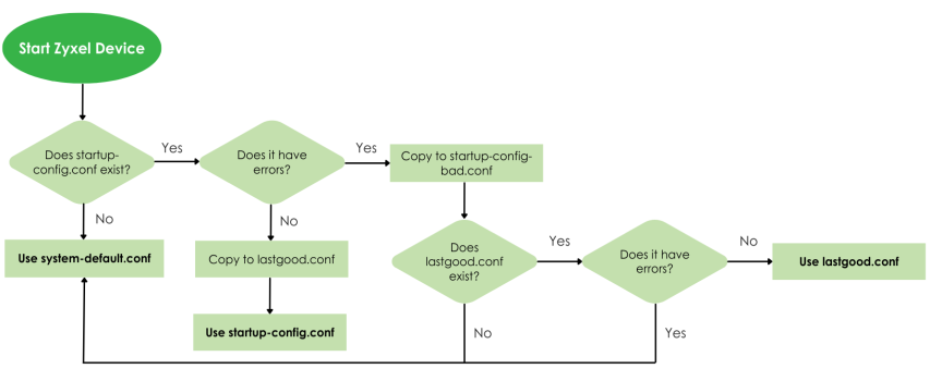

Configuration File Flow at Restart
You can manually restart the Zyxel Device through a management interface or by physically turning the power off and back on.
The Zyxel Device restarts automatically when you upload new firmware.
The Zyxel Device always checks for errors in any configuration file when rebooting. The Zyxel Device generates a log for any errors.
If there is not a startup-config.conf when you restart the Zyxel Device, the Zyxel Device uses the system-default.conf configuration file with the Zyxel Device’s default settings. The Zyxel Device will apply the system-default.conf when it boots without a startup-config.conf, even if you have a lastgood.conf.
If there is a startup-config.conf, the Zyxel Device checks it for errors and applies it if there are no errors. The Zyxel Device also copies it to the lastgood.conf configuration file as a back up file.
If there is an error in startup-config.conf, the Zyxel Device generates a log and copies startup-config.conf to startup-config-bad.conf and then tries the existing lastgood.conf configuration file.
If there isn’t a lastgood.conf configuration file or it also has an error, the Zyxel Device applies the system-default.conf configuration file.
Zyxel Device Start-up Flow

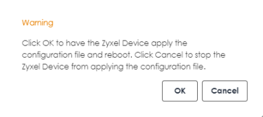

Apply
Use this button to have the Zyxel Device use a specific configuration file.
Click a configuration file’s row to select it and click Apply to have the Zyxel Device use that configuration file. The following screen displays. Click OK to have the Zyxel Device start applying the configuration file or click Cancel to close the screen.
Apply a Configuration File
*This button is not available when Device HA is enabled. To apply a configuration file, first disable Device HA in System > Device HA > HA Configuration.

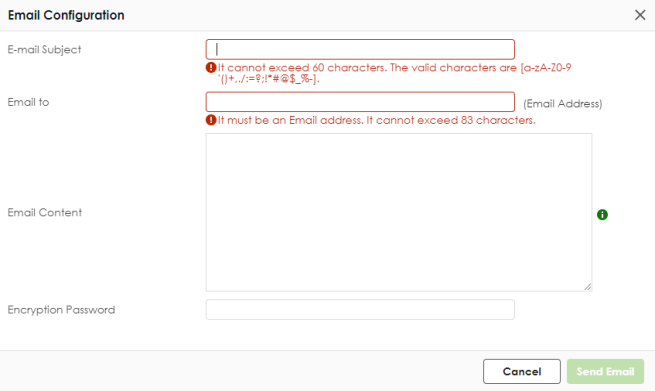

Email
Use this button to have the Zyxel Device send the selected configuration file to a valid email address.
Click a configuration file’s row to select it and click Email to have the Zyxel Device mail that configuration file. The following screen displays.
E-mail Subject
Enter a email subject text with 1-60 characters. It may consist of letters, numbers, and the following special characters: ‘()+,./:=?;!*#@$%-
Email To
Enter up to 83 characters for the email address of the receiver.
Email Content
Enter the backup email body text using 1 to 251 single-byte characters, including 0-9a-zA-Z!”#$%&’()*+,-./:;<=>@[\]^_‘{|} and spaces are allowed.
? is not allowed.
Encryption Password
Configuration files are zipped when they are emailed. For security, enter an unzip password to require the recipient to use this password to unzip the configuration file. The password cannot exceed 128 characters. Valid characters are [0-9a-zA-Z~!@#$%^&*()_-+={}|;:<>,./].
If you do not set a password here, then none is needed to unzip the configuration file.
Send Email
Click this to send the email to the email address you configured.

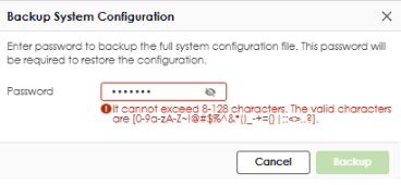

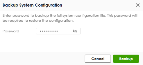

Click the Backup button to set up the recovery file. The following screen appears.
Password
Enter a password for the recovery file. You will need this password to restore the recovery file on the replacement Zyxel Device. It can contain 8 to 128 single-byte characters, including 0-9, a-z, A-Z, and the following characters: ~!@#$%^&*()_-+={}|;:<>,.? Spaces are not allowed. This field cannot be blank.
Cancel
Click Cancel to exit this screen without saving.
Backup
Click Backup to save the recovery file to the Zyxel Device.
