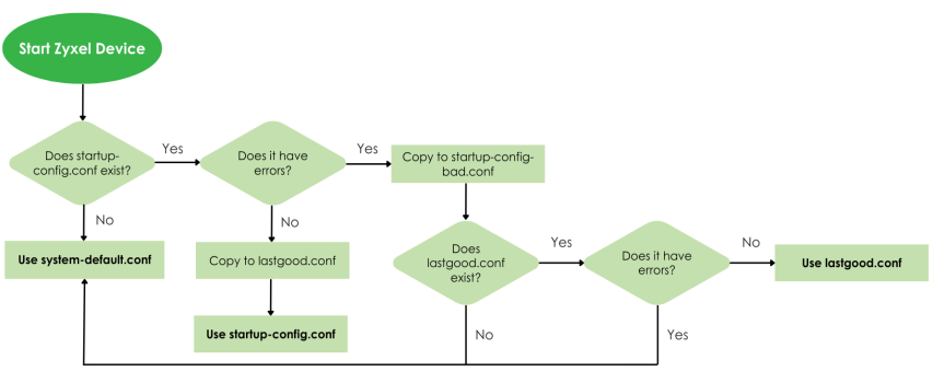

Configuration File Flow at Restart
You can manually restart the Zyxel Device through a management interface or by physically turning the power off and back on.
The Zyxel Device restarts automatically when you upload new firmware.
The Zyxel Device always checks for errors in any configuration file when rebooting. The Zyxel Device generates a log for any errors.
If there is not a startup-config.conf when you restart the Zyxel Device, the Zyxel Device uses the system-default.conf configuration file with the Zyxel Device’s default settings. The Zyxel Device will apply the system-default.conf when it boots without a startup-config.conf, even if you have a lastgood.conf.
If there is a startup-config.conf, the Zyxel Device checks it for errors and applies it if there are no errors. The Zyxel Device also copies it to the lastgood.conf configuration file as a back up file.
If there is an error in startup-config.conf, the Zyxel Device generates a log and copies startup-config.conf to startup-config-bad.conf and then tries the existing lastgood.conf configuration file.
If there isn’t a lastgood.conf configuration file or it also has an error, the Zyxel Device applies the system-default.conf configuration file.
Zyxel Device Start-up Flow

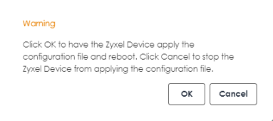

Apply
Use this button to have the Zyxel Device use a specific configuration file.
Click a configuration file’s row to select it and click Apply to have the Zyxel Device use that configuration file. The following screen displays. Click OK to have the Zyxel Device start applying the configuration file or click Cancel to close the screen.
Apply a Configuration File
*This button is not available when Device HA is enabled. To apply a configuration file, first disable Device HA in System > Device HA > HA Configuration.

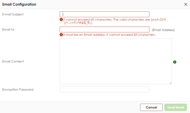

Email
Use this button to have the Zyxel Device send the selected configuration file to a valid email address.
Click a configuration file’s row to select it and click Email to have the Zyxel Device mail that configuration file. The following screen displays.
E-mail Subject
Enter a email subject text with 1-60 characters. It may consist of letters, numbers, and the following special characters: ‘()+,./:=?;!*#@$%-
Email To
Enter up to 83 characters for the email address of the receiver.
Email Content
Enter the backup email body text using 1 to 251 single-byte characters, including [0-9a-zA-Z!”#$%&’()*+,-./:;<=>@[\]^_‘{|}] and spaces are allowed. ? is not allowed.
Encryption Password
Configuration files are zipped when they are emailed. For security, enter an unzip password to require the recipient to use this password to unzip the configuration file. The password cannot exceed 128 characters. Valid characters are [0-9a-zA-Z~!@#$%^&*()_-+={}|;:<>,./].
If you do not set a password here, then none is needed to unzip the configuration file.
Send Email
Click this to send the email to the email address you configured.
Cancel
Click this to close the screen.

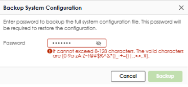

Recovery Manager
Use this to create a complete recovery file of the Zyxel Device that can be used if the Zyxel Device needs to be replaced or you want to sell it to someone else. You should save a backup or recovery file to your computer each time you make a configuration change. The recovery file can then be restored on a replacement Zyxel Device. You must set a password for the recovery file. The password must be 8 to 128 characters long, and can contain [0-9a-zA-Z~!@#$%^&*()_-+={}|;:<>,.?]. Write this password down in a safe place as it will be required if you want to restore this configuration on a replacement Zyxel Device later.
The Zyxel Device automatically names the recovery file to ‘Hostname_Recovery_YYYY-MM-DD.rbf’, where YYYY-MM-DD is the date created. This is an example file name: ‘MyUSGFLEX500H_Recovery_2025-07-28.rbf​’. You set the Host Name for this Zyxel Device in System > Settings.
You can only upload recovery files with an ‘.rbf’ extension.
The recovery file includes the following:
Configuration files
Contains all configuration files from the Maintenance > Firmware/File Manager > Configuration File screen.
Certificates
My Certificates (Site-to-Site VPN, Remote access VPN)
SSL VPN Certificates
Trusted Certificates: Certificates that you have set the Zyxel Device to accept as trusted.
Google Authenticator File
Contains two-factor authentication (2FA) information. Google Authenticator adds an extra layer of security for local users accessing the Zyxel Device or a secured network behind the Zyxel Device through a VPN tunnel.
Status
This displays the status of the file backup. You must first back up the file to the Zyxel Device and then download it to your computer. This recovery file does not display in the Configuration list.
Done - The recovery file has been successfully saved to the Zyxel Device.
None - No backup of the recovery file has been made.
Failed - The backup of the recovery file failed. Ensure the Internet is working.

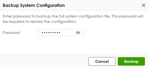

Click the Backup button to set up the recovery file. The following screen appears.
Password
Enter a password for the recovery file. You will need this password to restore the recovery file on the replacement Zyxel Device. It can contain 8 to 128 single-byte characters, including 0-9, a-z, A-Z, and the following characters: ~!@#$%^&*()_-+={}|;:<>,.? Spaces are not allowed. This field cannot be blank.
Cancel
Click Cancel to exit this screen without saving.
Backup
Click Backup to save the recovery file to the Zyxel Device.

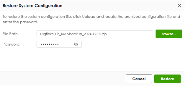

Restore
Click Restore to upload a recovery file to the replacement Zyxel Device. Check that the replacement Zyxel Device has firmware version 1.31 or later. The following screen appears.
*The replacement Zyxel Device must be the same model with the exact same firmware version as the one on which the backup was done. You must use the password that you configured when you downloaded the recovery file.
File Path
Click Browse to select a recovery file on your computer that you want to upload.
Password
Enter the password for the recovery file created during the backup.
Cancel
Restore
Click Restore to upload the recovery file to the replacement Zyxel Device. The Zyxel Device automatically reboots when you apply the new recovery file.
