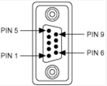

Signal | Console Port RJ-45 Pin | DB-9 Pin | Signal |
RTS | 1 | 8 | CTS |
DTR | 2 | 6 | DSR |
TxD | 3 | 2 | RxD |
GND | 4 | 5 | GND |
GND | 5 | 5 | GND |
RxD | 6 | 3 | TxD |
DSR | 7 | 4 | DTR |
CTS | 8 | 7 | RTS |
1, 9 | NC |
Signal | Signal Name |
RXD | Receive Data |
TXD | Transmit Data |
DTR | Data Terminal Ready |
GND | Ground |
DSR | Data Set Ready |
RTS | Request to Send |
CTS | Clear to Send |
RI | Ring Indicator |
NC | Not Connected |
