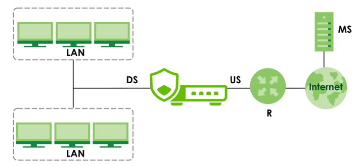

Internet Group Management Protocol (IGMP) proxy is used for multicast routing. IGMP proxy enables the Zyxel Device to issue IGMP host messages on behalf of hosts that the Zyxel Device discovered on its IGMP-enabled interfaces. The Zyxel Device acts as a proxy for its hosts. Refer to the following figure.
• DS: Downstream traffic
• US: Upstream traffic
• R: Router
• MS: Multicast Server
• Enable IGMP Upstream (US) on the Zyxel Device interface that connects to a router (R) running IGMP that is closer to the multicast server (MS).
• Enable IGMP Downstream on the Zyxel Device interface which connects to the multicast hosts.

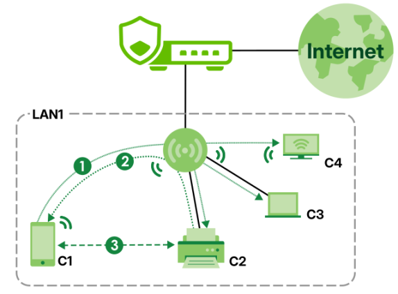

Multicast DNS (mDNS) is a protocol that sends discovery packets to resolve hostnames to IP addresses on a local network without using a DNS server. It is commonly used by zero-configuration services that require no manual IP or DNS setup, such as printers, TVs, AirPlay, Chromecast, and IoT devices.
mDNS uses a query and response exchange to allow devices to find each other and then establish a communication session. In the following scenario, the mobile phone (C1) connects to the printer (C2) on the same LAN.
Step1: Query
C1 sends out multicast discovery packets with host name C2 to multicast address 224.0.0.251 on port 5353 used for the mDNS queries.
Step 2: Response
C2 receives the multicast query and responds with its IP address.
Step 3: Session Established
C1 receives the response from C2 and obtains its IP address. C1 and C2 have established a communication session.

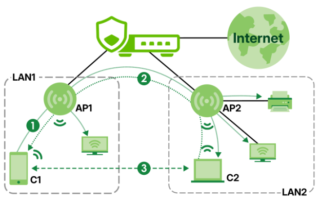

mDNS Proxy
mDNS discovery is only sent to a local network multicast address (224.0.0.251:5353). The Zyxel Device supports mDNS Proxy that allows the Zyxel Device to act as a the mDNS reflector to transmit the multicast discovery packets across subnets.
The examples below show how the mobile phone (C1) on LAN1 connects to the laptop (C2) on LAN2 through the Zyxel Device by using the mDNS Proxy feature.

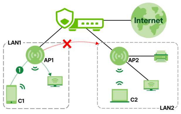

With mDNS Proxy Disabled
When mDNS Proxy is disabled, the multicast discovery packets cannot be sent out of LAN1. Therefore, C2 does not receive the query.
mDNS Proxy Disabled
With mDNS Proxy Enabled
When the mDNS Proxy is enabled and the LAN1 and LAN2 interfaces are configured as Allowed Interfaces, the connection between C1 and C2 is successful.
mDNS Proxy Enabled
