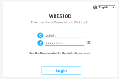

3 Enter the user name (default: “admin”) and default password. The default password is unique to each Zyxel Device and shown on the label. If your Zyxel Device does not have a password on the label, use “1234”.
4 Select the language you prefer for the Web Configurator. Click Login.

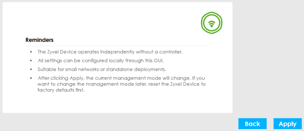

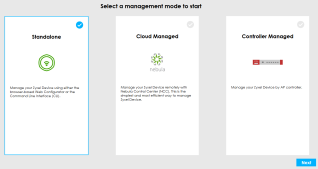

5 Select a management mode. Select Standalone if you use the Web Configurator to manage your Zyxel Device. Select Could Managed if you use NCC to manage your Zyxel Device. Select Controller Managed if you use an APC to manage your Zyxel Device. Refer to Management Mode for more information about management mode. Click Next.
6 Check the Reminders on the screen. Click Apply. If you select Cloud Managed or Controller Managed, refer to Nebula Control Center (NCC) or your AP Controller (APC) to manage your Zyxel Device (see Ways to Access the Zyxel Device for more information). If you select Standalone, continue with the steps below.

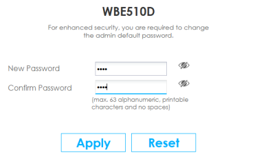

7 Set up a new password containing 4 to 63 printable characters. Spaces are not allowed. Click Apply.

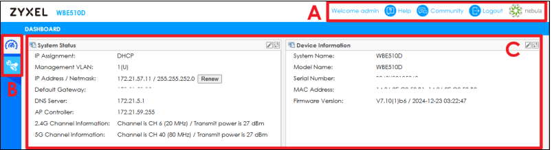

Navigating the Web Configurator

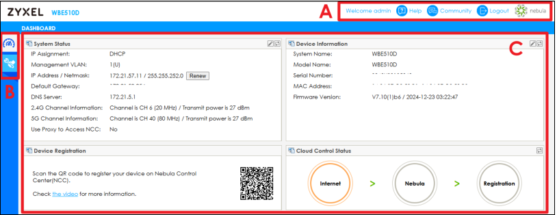

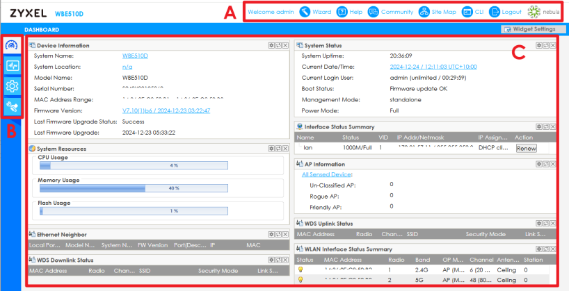

The following summarizes how to navigate the Web Configurator from the Dashboard screen. The figures below show the Dashboard screen in standalone mode, cloud managed mode, and controller managed mode. The screen layout may differ slightly depending on the mode and device model.
The Web Configurator’s Dashboard for Standalone Mode
The Web Configurator’s Dashboard for Cloud Managed Mode
The Web Configurator’s Dashboard for Controller Managed Mode
The Web Configurator’s main screen is divided into these parts:
A - Title Bar
B - Navigation Panel
C - Main Window
Title Bar
The title bar provides some useful links that always appear over the screens below, regardless of how deep into the Web Configurator you navigate. If your Zyxel Device is in cloud managed mode or controller managed mode, not all icons will be available in the title Bar.
Title Bar
The icons provide the following functions.
Title Bar: Web Configurator Icons
Label
Description
Wizard
Click this to open the wizard. See Accessing the Wizard for more information.
Help
Click this to open the help page for the current screen.
Community
Click this to log into the Zyxel forum to post questions, contribute to a discussion and get feedback on Zyxel Device.
Site Map
Click this to see an overview of links to the Web Configurator screens.
CLI
Click this to open a popup window that displays the CLI commands sent by the Web Configurator.
Logout
Click this to log out of the Web Configurator.
nebula
Click this to open the NCC web site login page in a new tab or window.

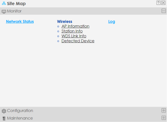

Site Map
Click Site MAP to see an overview of links to the Web Configurator screens. Click a screen’s link to go to that screen.

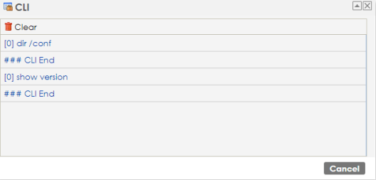

CLI Messages
Click CLI to look at the CLI commands sent by the Web Configurator. These commands appear in a popup window, such as the following.
CLI Messages
Click Clear to remove the currently displayed information.
*See the Command Reference Guide for information about the commands.

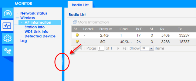

Navigation Panel
Use the menu items on the navigation panel to open screens to configure Zyxel Device features. Click the arrow in the middle of the right edge of the navigation panel to hide the navigation panel menus or drag it to resize them. The following sections introduce the Zyxel Device’s navigation panel menus and their screens.
Navigation Panel
Standalone Mode Navigation Panel Menus
The following are the screens available in standalone mode. Note that some screens may not be available for your Zyxel Device model. See Zyxel Device Product Feature Comparison to see which features your Zyxel Device model supports.

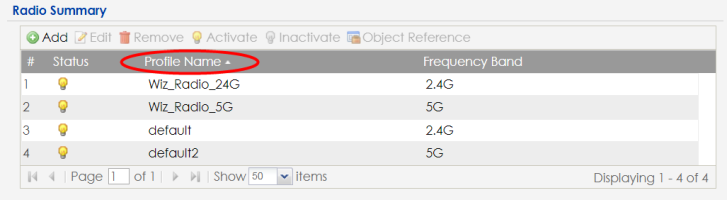

Tables and Lists

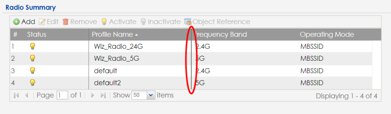

The Web Configurator tables and lists are quite flexible and provide several options for how to display their entries.

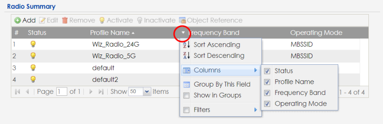

Manipulating Table Display
Here are some of the ways you can manipulate the Web Configurator tables.
1 Click a column heading to sort the table’s entries according to that column’s criteria.
2 Click the down arrow next to a column heading for more options about how to display the entries. The options available vary depending on the type of fields in the column. Here are some examples of what you can do:
Sort in ascending alphabetical order
Sort in descending (reverse) alphabetical order
Select which columns to display
Group entries by field
Show entries in groups
Filter by mathematical operators (<, >, or =) or searching for text.
3 Select a column heading cell’s right border and drag to re-size the column.
4 Select a column heading and drag and drop it to change the column order. A green check mark displays next to the column’s title when you drag the column to a valid new location.
5 Use the icons and fields at the bottom of the table to navigate to different pages of entries and control how many entries display at a time.

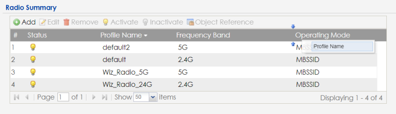

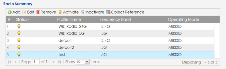

Working with Table Entries
The tables have icons for working with table entries. A sample is shown next. You can often use the [Shift] or [Ctrl] key to select multiple entries to remove, activate, or deactivate.
Common Table Icons
Here are descriptions for the most common table icons.
Common Table Icons
Label
Description
Add
Click this to create a new entry. For features where the entry’s position in the numbered list is important (features where the Zyxel Device applies the table’s entries in order like the firewall for example), you can select an entry and click Add to create a new entry after the selected entry.
Edit
Double-click an entry or select it and click Edit to open a screen where you can modify the entry’s settings. In some tables you can just click a table entry and edit it directly in the table. For those types of tables small red triangles display for table entries with changes that you have not yet applied.
Remove
To remove an entry, select it and click Remove. The Zyxel Device confirms you want to remove it before doing so.
Activate
To turn on an entry, select it and click Activate.
Inactivate
To turn off an entry, select it and click Inactivate.
Object Reference
Select an entry and click Object Reference to open a screen that shows which settings use the entry.
