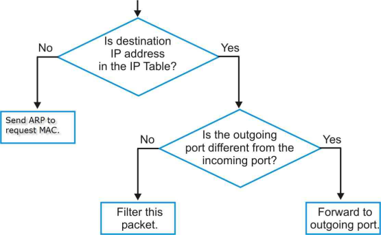

IP Table Overview
The IP Table screen shows how packets are forwarded or filtered across the Switch’s ports. When a device (which may belong to a VLAN group) sends a packet which is forwarded to a port on the Switch, the IP address of the device is shown on the Switch’s IP Table. The IP Table also shows whether the IP address is dynamic (learned by the Switch) or static (belonging to the Switch).
The Switch uses the IP Table to determine how to forward packets. See the following figure.
1 The Switch examines a received packet and learns the port from which this source IP address came.
2 The Switch checks to see if the packet's destination IP address matches a source IP address already learned in the IP Table.
If the Switch has already learned the port for this IP address, then it forwards the packet to that port.
If the Switch has not already learned the port for this IP address, then the packet is flooded to all ports. Too much port flooding leads to network congestion then the Switch sends an ARP to request the MAC address. The Switch then learns the port that replies with the MAC address.
If the Switch has already learned the port for this IP address, but the destination port is the same as the port it came in on, then it filters the packet.
IP Table Flowchart

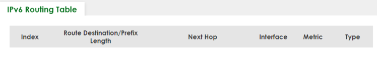

IPv6 Routing Table
Use this screen to view IPv6 routing table information.
MONITOR > Routing Table > IPv6 Routing Table
label
description
Index
This field displays the index number.
Route Destination/Prefix Length
This field displays the IPv6 subnet prefix and prefix length of the final destination.
Next Hop
This field displays the IPv6 address of the gateway that helps forward the packet to the destination.
Interface
This field displays the descriptive name of the IPv6 interface that is used to forward the packets to the destination.
Metric
This field displays the cost of the route.
Type
This field displays the method used to learn the route.
STATIC – added as a static entry.
Connect – added as a local interface entry.
