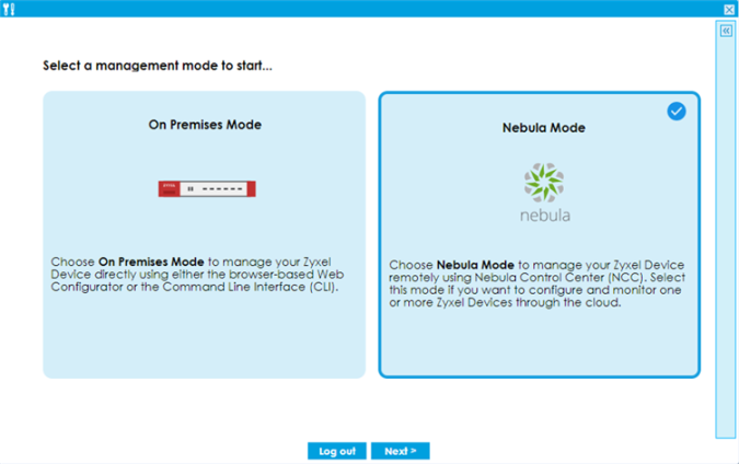

Nebula Mode to Cloud Monitoring Mode
1 Remove the Zyxel Device from the organization and site.
2 If the Zyxel Device is connected to Nebula, the Zyxel Device will automatically reset after you remove the Zyxel Device from the organization and site. If the Zyxel Device is not connected to Nebula, press the reset button.
3 After the PWR LED turns steady green, log into the Zyxel Device, select On Premises Mode, go to Configuration > Mgmt. & Analytics > Nebula, select Cloud Monitoring Mode and then follow the screen prompts.
Cloud Monitoring Mode to Nebula Mode
1 Remove the Zyxel Device in cloud monitoring mode from the organization and site.
2 Back up your current configuration in Maintenance > File Manager > Configuration File.
3 Reset the Zyxel Device to the factory default by pushing the Reset button until the port connection LEDs turn off (after about 5 seconds). Your Zyxel Device will reboot to the factory defaults.
4 Log into the Zyxel Device. Run the wizard and choose Nebula Mode.

Apply & Go to Nebula
Click this button to pass your Zyxel Device management to Nebula. Your Zyxel Device will automatically reset to factory defaults (except for the WAN settings) and restart.
