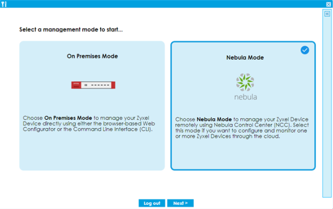

Cloud Monitoring Mode to Nebula Mode
1 Remove the Zyxel Device in cloud monitoring mode from the organization and site.
2 Back up your current configuration in Maintenance > File Manager > Configuration File.
3 Reset the Zyxel Device to the factory default by pushing the Reset button until the port connection LEDs turn off (after about 5 seconds). Your Zyxel Device will reboot to the factory defaults.
4 Log into the Zyxel Device. Run the wizard and choose Nebula Mode.
