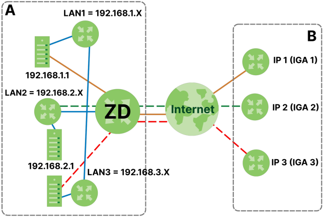

Inside/Outside and Global/Local
Inside/outside denotes where a host is located relative to the Zyxel Device, for example, the computers of your subscribers are the inside hosts, while the web servers on the Internet are the outside hosts.
Global/local denotes the IP address of a host in a packet as the packet traverses a router, for example, the local address refers to the IP address of a host when the packet is in the local network, while the global address refers to the IP address of the host when the same packet is traveling in the WAN side.

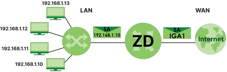

NAT
In the simplest form, NAT changes the source IP address in a packet received from a subscriber (the inside local address) to another (the inside global address) before forwarding the packet to the WAN side. When the response comes back, NAT translates the destination address (the inside global address) back to the inside local address before forwarding it to the original inside host.

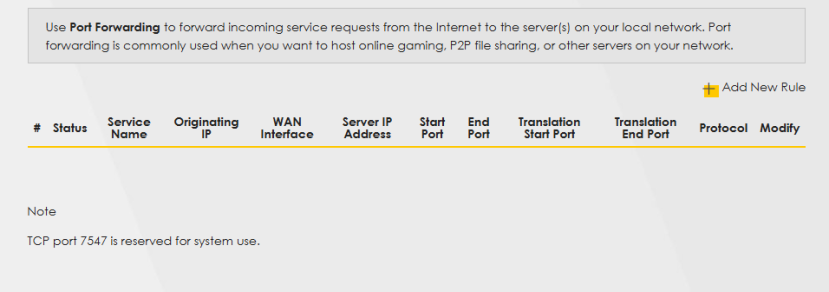

Port Forwarding
Use Port Forwarding to forward incoming service requests from the Internet to the servers on your local network. Port forwarding is commonly used when you want to host online gaming, P2P file sharing, or other servers on your network.
You may enter a single port number or a range of port numbers to be forwarded, and the local IP address of the desired server. The port number identifies a service; for example, web service is on port 80 on port 21. In some cases, such as for unknown services or where one server can support more than one service (for example web service), it might be better to specify a range of port numbers. You can allocate a server IP address that corresponds to a port or a range of ports. Please refer to RFC 1700 for further information about port numbers.
*Many residential broadband ISP accounts do not allow you to run any server processes (such as a Web server) from your location. Your ISP may periodically check for servers and may suspend your account if it discovers any active services at your location. If you are unsure, refer to your ISP.

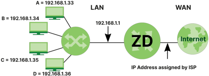

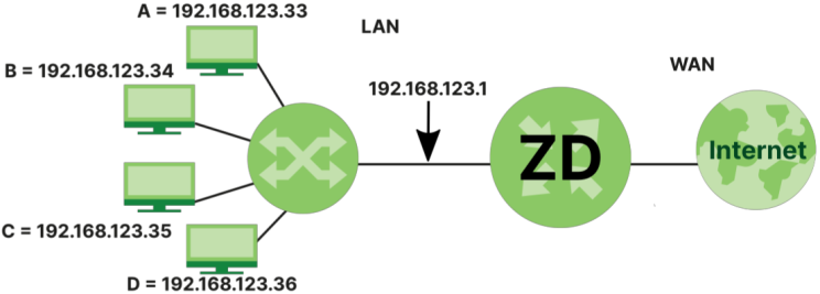

Configure Servers Behind Port Forwarding (Example)
Let's say you want to assign ports 21-25 to one Telnet and SMTP server (A in the example), port 80 to another (B in the example), a default server IP address of 192.168.1.35 to a third (C in the example), and a default server IP address of 192.168.1.36 to a fourth (D in the example). You assign the LAN IP addresses and the ISP assigns the WAN IP address. The NAT network appears as a single host on the Internet.
Multiple Servers Behind NAT Example
Port Forwarding
Click Network Setting > NAT to open the Port Forwarding screen.
*TCP port 7547 is reserved for system use.
Network Setting > NAT > Port Forwarding
The following table describes the fields in this screen.
LABEL
Description
Add New Rule
Click this to add a new port forwarding rule.
This is the index number of the entry.
Status
This field indicates whether the rule is active or not.
A yellow bulb signifies that this rule is active. A gray bulb signifies that this rule is not active.
Service Name
This is the service’s name. This shows User Defined if you manually added a service. You can change this by clicking the edit icon.
Originating IP
This is the source’s IP address.
WAN Interface
Select the WAN interface for which to configure NAT port forwarding rules.
Server IP Address
This is the server’s IP address.
Start Port
This is the first external port number that identifies a service.
End Port
This is the last external port number that identifies a service.
Translation Start Port
This is the first internal port number that identifies a service.
Translation End Port
This is the last internal port number that identifies a service.
Protocol
This field displays the protocol (TCP, UDP, TCP+UDP) used to transport the packets for which you want to apply the rule.
Modify
Click the Edit icon to edit the port forwarding rule.
Click the Delete icon to delete an existing port forwarding rule. Note that subsequent address mapping rules move up by one when you take this action.

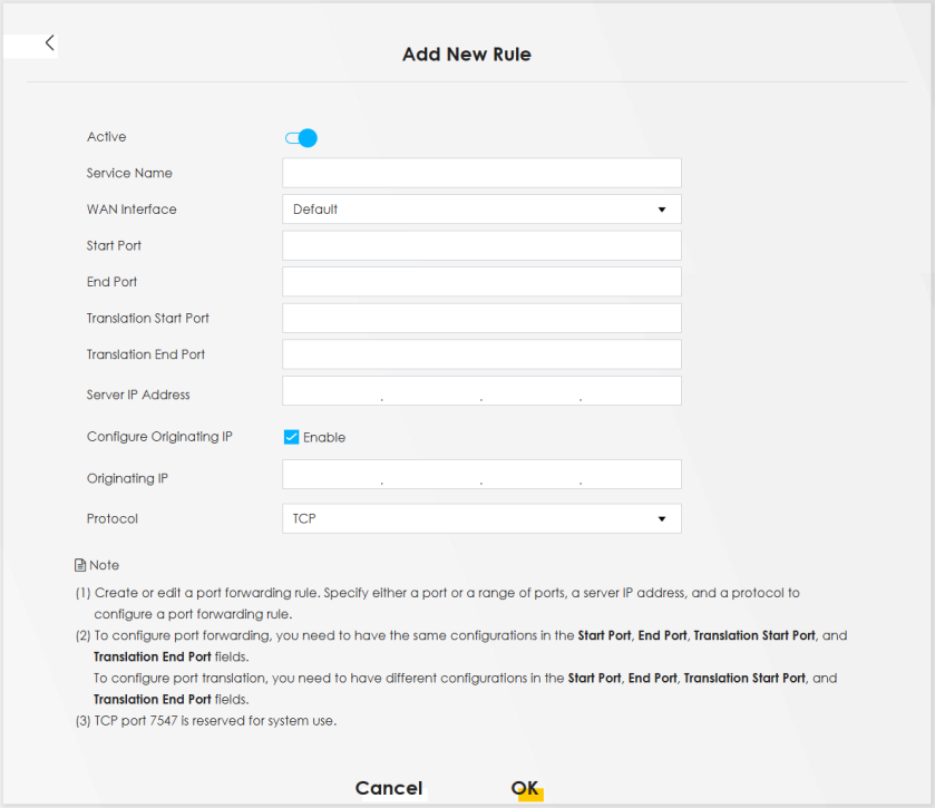

Add or Edit Port Forwarding
Create or edit a port forwarding rule. Specify either a port or a range of ports, a server IP address, and a protocol to configure a port forwarding rule. Click Add New Rule in the Port Forwarding screen or the Edit icon next to an existing rule to open the following screen.
Network Setting > NAT > Port Forwarding: Add or Edit
*To configure port forwarding, you need to have the same configurations in the Start Port, End Port, Translation Start Port, and Translation End Port fields.
To configure port translation, you need to have different configurations in the Start Port, End Port, Translation Start Port, and Translation End Port fields.
Here is an example to configure port translation. Configure Start Port to 100, End Port to 120, Translation Start Port to 200, and Translation End Port to 220.
Label
Description
Active
Click to turn the port forwarding rule on or off.
Service Name
Enter a name for the service to forward. You can use up to 256 printable characters except [ " ], [ ` ], [ ' ], [ < ], [ > ], [ ^ ], [ $ ], [ | ], [ & ], or [ ; ]. Spaces are allowed.
WAN Interface
Start Port
Configure this for a user-defined entry. Enter the original destination port for the packets.
To forward only one port, enter the port number again in the End Port field.
To forward a series of ports, enter the start port number here and the end port number in the End Port field.
End Port
Configure this for a user-defined entry. Enter the last port of the original destination port range.
To forward only one port, enter the port number in the Start Port field above and then enter it again in this field.
To forward a series of ports, enter the last port number in a series that begins with the port number in the Start Port field above.
Configure this for a user-defined entry. This shows the port number to which you want the Zyxel Device to translate the incoming port. For a range of ports, enter the first number of the range to which you want the incoming ports translated.
Configure this for a user-defined entry. This shows the last port of the translated port range.
Server IP Address
Enter the inside IP address of the virtual server here.
Configure Originating IP
Click the Enable checkbox to enter the source IP in the next field.
Originating IP
Enter the source IP address here.
Protocol
Select the protocol supported by this virtual server. Choices are TCP, UDP, or TCP/UDP.
OK
Click this to save your changes.
Cancel
Click this to exit this screen without saving.

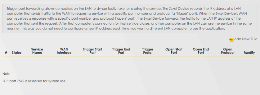

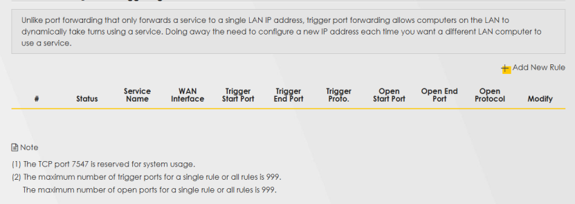

Port Triggering
Some services use a dedicated range of ports on the client side and a dedicated range of ports on the server side. With regular port forwarding, you set a forwarding port in NAT to forward a service (coming in from the server on the WAN) to the IP address of a computer on the client side (LAN). The problem is that port forwarding only forwards a service to a single LAN IP address. In order to use the same service on a different LAN computer, you have to manually replace the LAN computer's IP address in the forwarding port with another LAN computer's IP address.
Trigger port forwarding allows computers on the LAN to dynamically take turns using the service.
The Zyxel Device records the IP address of a LAN computer that sends traffic to the WAN to request a service with a specific port number and protocol (a \"trigger\" port). When the Zyxel Device's WAN port receives a response with a specific port number and protocol (\"open\" port), the Zyxel Device forwards the traffic to the LAN IP address of the computer that sent the request. After that computer’s connection for that service closes, another computer on the LAN can use the service in the same manner. This way you do not need to configure a new IP address each time you want a different LAN computer to use the application.

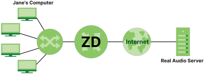

For example:
Trigger Port Forwarding Process: Example
1 Jane requests a file from the Real Audio server (port 7070).
2 Port 7070 is a “trigger” port and causes the Zyxel Device to record Jane’s computer IP address. The Zyxel Device associates Jane's computer IP address with the "open" port range of 6970 – 7170.
3 The Real Audio server responds using a port number ranging between 6970 – 7170.
4 The Zyxel Device forwards the traffic to Jane’s computer IP address.
5 Only Jane can connect to the Real Audio server until the connection is closed or times out. The Zyxel Device times out in 3 minutes with UDP (User Datagram Protocol) or 2 hours with TCP/IP (Transfer Control Protocol/Internet Protocol).
Click Network Setting > NAT > Port Triggering to open the following screen. Use this screen to view your Zyxel Device’s trigger port settings.
*The sum of trigger ports in all rules must be less than 1000 and every open port range must be less than 1000. When the protocol is TCP/UDP, the ports are counted twice.
Label
Description
Add New Rule
Click this to create a new rule.
Status
This field displays whether the port triggering rule is active or not. A yellow bulb signifies that this rule is active. A gray bulb signifies that this rule is not active.
Service Name
This field displays the name of the service used by this rule.
WAN Interface
This field shows the WAN interface through which the service is forwarded.
Trigger Start Port
The trigger port is a port (or a range of ports) that causes (or triggers) the Zyxel Device to record the IP address of the LAN computer that sent the traffic to a server on the WAN.
This is the first port number that identifies a service.
Trigger End Port
This is the last port number that identifies a service.
Trigger Proto.
This is the trigger transport layer protocol.
Open Start Port
The open port is a port (or a range of ports) that a server on the WAN uses when it sends out a particular service. The Zyxel Device forwards the traffic with this port (or range of ports) to the client computer on the LAN that requested the service.
Open End Port
Open Protocol
This is the open transport layer protocol.
Modify
Click the Edit icon to edit this rule.
Click the Delete icon to delete an existing rule.

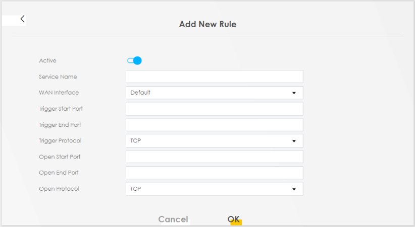

Add or Edit Port Triggering Rule
This screen lets you create new port triggering rules. Click Add New Rule in the Port Triggering screen or click a rule’s Edit icon to open the following screen. Use this screen to configure a port or range of ports and protocols for sending out requests and for receiving responses.
Network Setting > NAT > Port Triggering: Add or Edit
Label
Description
Active
Click this switch to activate this rule.
Service Name
Enter a name to identify this rule. You can use up to 256 printable characters except [ " ], [ ` ], [ ' ], [ < ], [ > ], [ ^ ], [ $ ], [ | ], [ & ], or [ ; ]. Spaces are allowed.
WAN Interface
Select a WAN interface for which you want to configure port triggering rules.
Trigger Start Port
Enter a port number or the starting port number in a range of port numbers.
Trigger End Port
Enter a port number or the ending port number in a range of port numbers.
Trigger Protocol
Select the transport layer protocol from TCP, UDP, or TCP/UDP.
Open Start Port
Open End Port
Open Protocol
Cancel
Click Cancel to exit this screen without saving.
OK
Click OK to save your changes.

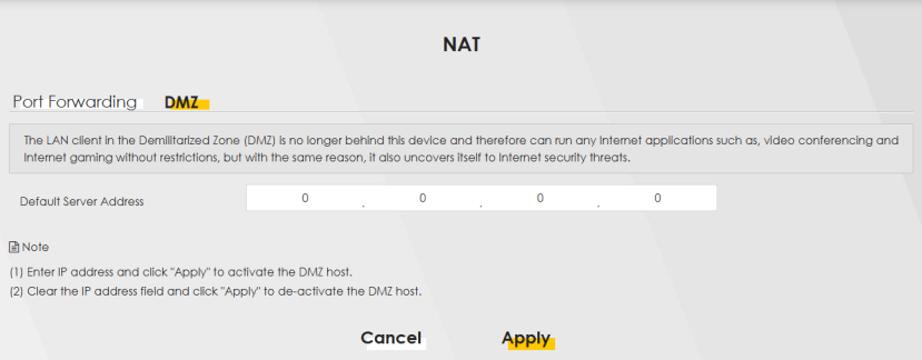

DMZ
Use this screen to specify the IP address of a default server to receive packets from ports not specified in the Port Triggering screen. The DMZ (DeMilitarized Zone) is a network between the WAN and the LAN that is accessible to devices on both the WAN and LAN with firewall protection. Devices on the WAN can initiate connections to devices on the DMZ but not to those on the LAN.
You can put public servers, such as email and web servers, on the DMZ to provide services on both the WAN and LAN. To use this feature, you first need to assign a DMZ host. Click Network Setting > NAT > DMZ to open the DMZ screen.
*Use an IPv4 address for the DMZ server.
*Enter the IP address of the default server in the Default Server Address field, and click Apply to activate the DMZ host. Otherwise, clear the IP address in the Default Server Address field, and click Apply to deactivate the DMZ host.
LABEL
Description
Enter the IP address of the default server which receives packets from ports that are not specified in the Port Forwarding screen.
*If you do not assign a default server, the Zyxel Device discards all packets received for ports not specified in the virtual server configuration.
Apply
Click this to save your changes back to the Zyxel Device.
Cancel
Click Cancel to restore your previously saved settings.

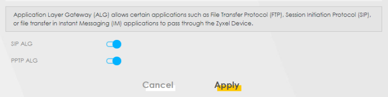

ALG
Application Layer Gateway (ALG) allows customized NAT traversal filters to support address and port translation for certain applications such as Session Initiation Protocol (SIP) or file transfer in Instant Messaging (IM) applications. It allows SIP calls to pass through the Zyxel Device. When the Zyxel Device registers with the SIP register server, the SIP ALG translates the Zyxel Device’s private IP address inside the SIP data stream to a public IP address. You do not need to use STUN or an outbound proxy if your Zyxel Device is behind a SIP ALG.
Click Network Setting > NAT > ALG to open the ALG screen. Use this screen to enable and disable the NAT Application Layer Gateway (ALG) in the Zyxel Device.
Application Layer Gateway (ALG) allows certain applications such as Session Initiation Protocol (SIP) or file transfer in Instant Messaging (IM) applications to pass through the Zyxel Device.
Label
Description
SIP ALG
Click this switch to enable SIP ALG to make sure SIP (VoIP) works correctly with port-forwarding and address-mapping rules.
PPTP ALG
Click this switch to enable the PPTP ALG on the Zyxel Device to detect PPTP traffic and help build PPTP sessions through the Zyxel Device’s NAT.

In the simplest form, NAT changes the source IP address in a packet received from a subscriber (the inside local address) to another (the inside global address) before forwarding the packet to the WAN side. When the response comes back, NAT translates the destination address (the inside global address) back to the inside local address before forwarding it to the original inside host. Note that the IP address (either local or global) of an outside host is never changed.
The global IP addresses for the inside hosts can be either static or dynamically assigned by the ISP. In addition, you can designate servers, for example, a web server and a telnet server, on your local network and make them accessible to the outside world. If you do not define any servers (for Many-to-One and Many-to-Many Overload mapping), NAT offers the additional benefit of firewall protection. With no servers defined, your Zyxel Device filters out all incoming inquiries, thus preventing intruders from probing your network. For more information on IP address translation, refer to RFC 1631, The IP Network Address Translator (NAT).
How NAT Works
Each packet has two addresses – a source address and a destination address. For outgoing packets, the ILA (Inside Local Address) is the source address on the LAN, and the IGA (Inside Global Address) is the source address on the WAN. For incoming packets, the ILA is the destination address on the LAN, and the IGA is the destination address on the WAN. NAT maps private (local) IP addresses to globally unique ones required for communication with hosts on other networks. It replaces the original IP source address (and TCP or UDP source port numbers for Many-to-One and Many-to-Many Overload NAT mapping) in each packet and then forwards it to the Internet. The Zyxel Device keeps track of the original addresses and port numbers so incoming reply packets can have their original values restored. The following figure illustrates this.

NAT Application
The following figure illustrates a possible NAT application, where three inside LANs (logical LANs using IP alias) behind the Zyxel Device can communicate with three distinct WAN networks.

Port Forwarding Example
Let's say you want to assign ports 21 – 25 to one Telnet and SMTP server (A in the example), port 80 to another (B in the example) and assign a default server IP address of 192.168.1.35 to a third (C in the example). You assign the LAN IP addresses and the ISP assigns the WAN IP address. The NAT network appears as a single host on the Internet.
