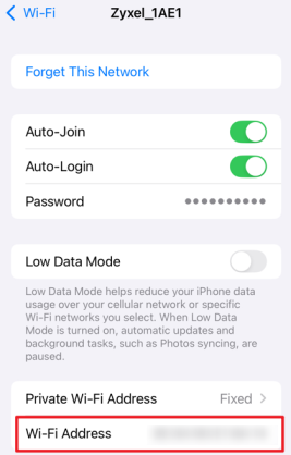

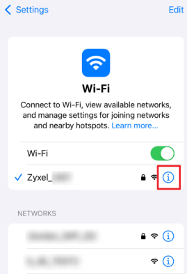

I do not know the IP address of the Zyxel Device.
1 The default IP address is 192.168.1.1.
2 If you changed the IP address, you might be able to find the IP address of the Zyxel Device by looking up the IP address of your computer’s default gateway. To do this in Microsoft Windows, click Start > Run, enter cmd, and then enter ipconfig. The IP address of the Default Gateway might be the IP address of the Zyxel Device, depending on your network environment.
3 If this does not work, reset the Zyxel Device to its factory defaults.

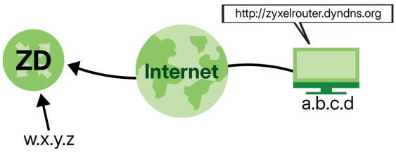

I cannot log into the Zyxel Device using DDNS.
If you connect your Zyxel Device to the Internet and it uses a dynamic WAN IP address, it is inconvenient for you to manage the Zyxel Device from the Internet. The Zyxel Device’s WAN IP address changes dynamically. Dynamic DNS (DDNS) allows you to access the Zyxel Device using a domain name.
To use this feature, you have to apply for DDNS service at www.dyndns.org.
*If you have a private WAN IP address, then you cannot use DDNS.
Here are the three steps to use a domain name to log in the Web Configurator:
Step 1 Register for a DDNS Account on www.dyndns.org
1 Open a browser and enter http://www.dyndns.org.
2 Apply for a user account. This tutorial uses UserName1 and 12345 as the username and password.
3 Log into www.dyndns.org using your account.
4 Add a new DDNS host name. This tutorial uses the following settings as an example.
• Hostname: zyxelrouter.dyndns.org
• Service Type: Host with IP address
• IP Address: Enter the WAN IP address that your Zyxel Device is currently using. You can find the IP address on the Zyxel Device’s Web Configurator Status page.
Then you will need to configure the same account and host name on the Zyxel Device later.
Step 2 Configure DDNS on Your Zyxel Device
Configure the following settings in the Network Setting > DNS > Dynamic DNS screen.
• Select Enable Dynamic DNS.
• Select www.DynDNS.com as the service provider.
• Enter zyxelrouter.dyndns.org in the Host Name field.
• Enter the user name (UserName1) and password (12345). Click Apply.
Step 3 Test the DDNS Setting
Now you should be able to access the Zyxel Device from the Internet. To test this:
1 Open a web browser on the computer (using the IP address a.b.c.d) that is connected to the Internet.
2 Enter http://zyxelrouter.dyndns.org and press [Enter].
3 The Zyxel Device’s login page should appear. You can then log into the Zyxel Device and manage it.

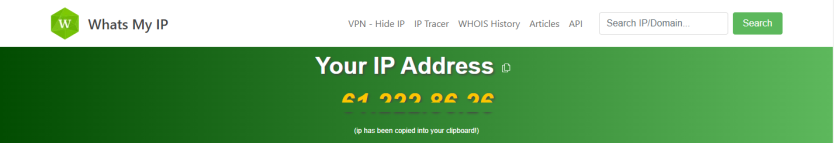

To test if this is due to CGNAT, follow these steps:
1 Log in to your Zyxel Device’s Web Configurator using the default IPv4 address (for example, 192.168.1.1).
2 Locate the WAN IP address on the Dashboard screen. You can find this information in the Network or WAN settings.
3 Go to a website that can show you the public IP address of your network (for example, https://whatsmyip.com). When you access this site, it will display your public IP address.
4 Compare the WAN IP address displayed on the Dashboard screen with the public IP address shown on the https://whatsmyip.com website.
• If both IP addresses are the same, your ISP is not using Carrier-Grade NAT, and you should be able to access your Zyxel Device from the WAN (outside).
• If the IP addresses are different, it indicates that your ISP is using Carrier-Grade NAT, and your Zyxel Device has a shared public IP address. As a result, remote access to your Zyxel Device from the WAN will not be possible.

I blocked a smartphone using the MAC Authentication screen, but it can still access the Zyxel Device’s Wi-Fi network. Why?
Nowadays, many smartphones use a private (randomized) MAC address for each Wi-Fi network instead of the device’s actual MAC address.
To block a smartphone effectively, you need to find the private MAC address it uses for the specific Wi-Fi network. Follow the steps below to locate it:
1 For iOS devices, go to Settings > Wi-Fi, click the information icon next to the Wi-Fi network you want to block.
2 Look for the Wi-Fi Address. This is the private MAC address that the smartphone is using to connect to that Wi-Fi network. Add this address to the MAC Authentication deny list to block the device.
