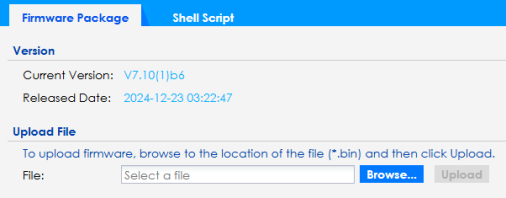

Firmware Package
Click Maintenance > File Manager > Firmware Package to open this screen. Use the Firmware Package screen to check your current firmware information and upload firmware to the Zyxel Device. You can manually download the new firmware from the Zyxel website.
*The Web Configurator is the recommended method for uploading firmware. You only need to use the command line interface if you need to recover the firmware. See the CLI Reference Guide for how to determine if you need to recover the firmware and how to recover it.
The firmware update can take up to five minutes. Do not turn off or reset the Zyxel Device while the firmware update is in progress!
Label
Description
Version
Current Version
This is the firmware version.
Released Date
This is the date that the version of the firmware was created.
Upload File
File Path
Enter the location of the file you want to upload in this field or click Browse... to find it.
Browse...
Click Browse... to find the .bin file you want to upload. Remember that you must decompress compressed (.zip) files before you can upload them.
Upload
Click Upload to begin the upload process. This process may take up to two minutes.

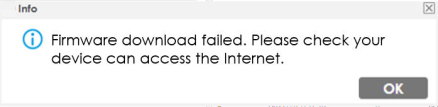

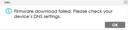

Firmware Download Failed
The following pop-up messages display the causes and solutions for firmware download failure.
Firmware download failed due to an Internet error. Refer to Internet Access for more information.
Firmware Download Failed. Check Internet Access.
Firmware download failed due to a DNS problem. Please check your device's DNS settings.
Firmware Download failed. Check DNS Settings.
Firmware download failed. Download the new firmware manually from the Zyxel website. Then, go to the Maintenance > File Manager > Firmware Package screen to upload the new firmware.
Firmware Download Failed. Download Manually.

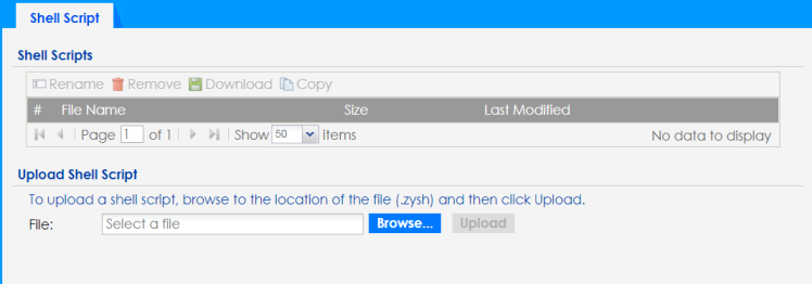

Shell Script

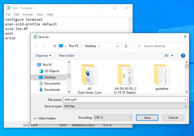

A shell script is a list of commands to manage the Zyxel Device. Use a text editor to create the shell script files. They must use a “.zysh” filename extension. For example, test.zysh.
Click Maintenance > File Manager > Shell Script to open this screen. Use the Shell Script screen to store, name, download, and upload shell script files. You can store multiple shell script files on the Zyxel Device at the same time.
See What you Need to Know for information about shell scripts.
1 In the text editor, save the shell script with a .zysh filename extension. Select All Files as the file type.

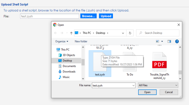

2 Go to the Maintenance > File Manager > Shell Script screen. Click Browse... to upload the .zysh file.

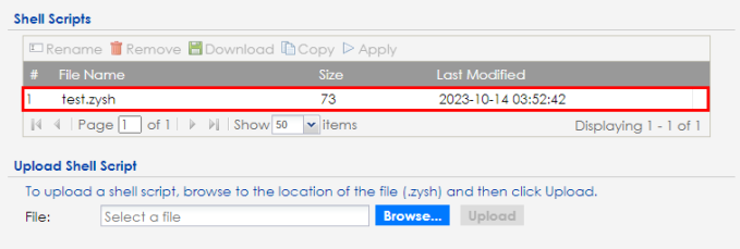

3 Click Upload. The uploaded shell script will be shown in the Shell Scripts field.
Each field is described in the following table.
Label
Description
Shell Scripts
Rename
Use this button to change the label of a shell script file on the Zyxel Device.
You cannot rename a shell script to the name of another shell script in the Zyxel Device.
Click a shell script’s row to select it and click Rename to open the Rename File screen.
Specify the new name for the shell script file. Use up to 25 characters (including a-zA-Z0-9;‘~!@#$%^&()_+[]{}’,.=-).
Click OK to save the renamed file or click Cancel to close the screen without saving a renamed file.
Remove
Click a shell script file’s row to select it and click Delete to delete the shell script file from the Zyxel Device.
A pop-up window asks you to confirm that you want to delete the shell script file. Click OK to delete the shell script file or click Cancel to close the screen without deleting the shell script file.
Download
Click a shell script file’s row to select it and click Download to save the configuration to your computer.
Copy
Use this button to save a duplicate of a shell script file on the Zyxel Device.
Click a shell script file’s row to select it and click Copy to open the Copy File screen.
Specify a name for the duplicate file. Use up to 25 characters (including a-zA-Z0-9;‘~!@#$%^&()_+[]{}’,.=-).
Click OK to save the duplicate or click Cancel to close the screen without saving a duplicate of the configuration file.
Apply
Use this button to have the Zyxel Device use a specific shell script file.
Click a shell script file’s row to select it and click Apply to have the Zyxel Device use that shell script file. You may need to wait awhile for the Zyxel Device to finish applying the commands.
This column displays the number for each shell script file entry.
File Name
This column displays the label that identifies a shell script file.
Size
This column displays the size (in KB) of a shell script file.
Last Modified
This column displays the date and time that the individual shell script files were last changed or saved.
Upload Shell Script
File
Browse...
Click Browse... to find the .zysh file you want to upload.
Upload
Click Upload to begin the upload process. This process may take up to several minutes.

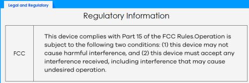

Legal and Regulatory
Use this screen to view the information on legal and regulatory. This screen may not display depending on the Zyxel Device model you are using.

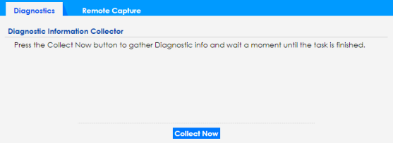

This screen provides an easy way for you to generate a file containing the Zyxel Device’s configuration and diagnostic information. You may need to generate this file and send it to customer support during troubleshooting. All categories of settings and shell script files stored on the Zyxel Device will be included in the diagnostic file.
Click Maintenance > Diagnostics > Diagnostics to open the Diagnostics screen. Click Collect Now to have the Zyxel Device create a new diagnostic file.

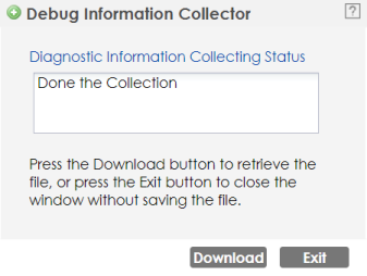

The Debug Information Collector screen then displays showing whether the collection is in progress, was successful, or has failed. When the data collection is done, click Download to save the most recent diagnostic file to a computer.
Maintenance > Diagnostics > Diagnostics: Debug Information Collector

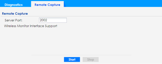

Remote Capture
Use this screen to capture network traffic going through the Zyxel Device and output the captured packets to a packet analyzer (also known as network or protocol analyzer) such as Wireshark. If the Zyxel Device is connected to the Zyxel gateway or ZyWALL, you might need to configure the Zyxel gateway or ZyWALL to allow remote capture on the Zyxel Device.
*Not all models support wireless remote capture. See Zyxel Device Product Feature Comparison for the models that support remote capture on wireless interfaces.
Click Maintenance > Diagnostics > Remote Capture to open the Remote Capture screen.
Maintenance > Diagnostics > Remote Capture (Zyxel Device that supports Wireless Remote Capture)

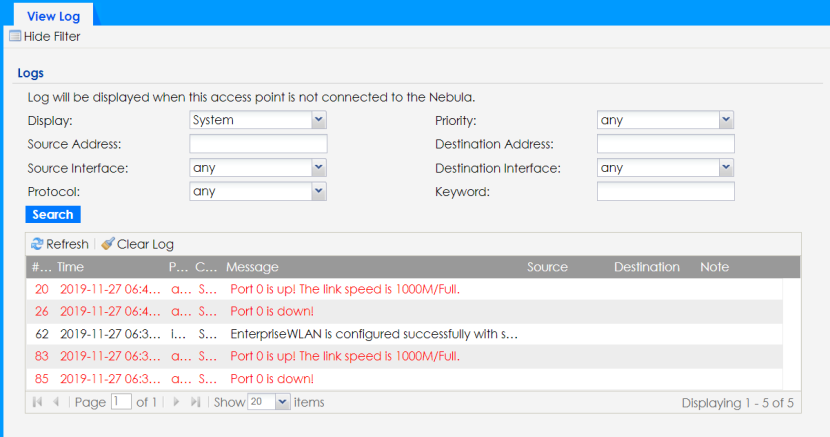

View Log
The NCC periodically gathers log files from the devices being managed by it. Before the NCC pulls logs from the Zyxel Device or when the Zyxel Device is disconnected from the NCC, you can use this screen to view its current log messages. To access this screen, click Maintenance > Log > View Log.
*When a log reaches the maximum number of log messages, new log messages automatically overwrite existing log messages, starting with the oldest existing log message first.
Events that generate an alert (as well as a log message) display in red. Regular logs display in black. Click a column’s heading cell to sort the table entries by that column’s criteria. Click the heading cell again to reverse the sort order.

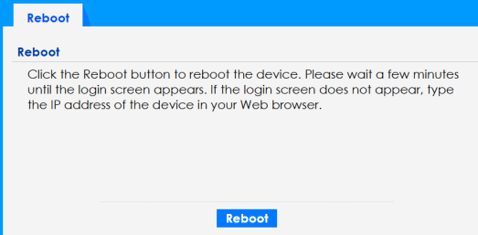

Reboot
This screen allows users to restart the Zyxel Device. To access this screen, click Maintenance > Reboot > Reboot.
If you made changes in the CLI, you have to use the write command to save the configuration. They do not change when you reboot the Zyxel Device.
Reboot is different from reset; reset returns the Zyxel Device to its default configuration.
You can reboot your Zyxel Device when the Internet connection is slow or intermittent.
Label
Description
Reboot
Click Reboot then click Yes to restart the Zyxel Device immediately.
After the Zyxel Device reboots, wait a few minutes until the login screen appears. If the login screen does not appear, type the IP address of the Zyxel Device in your Web browser.
You can also use the CLI command reboot to restart the Zyxel Device.
