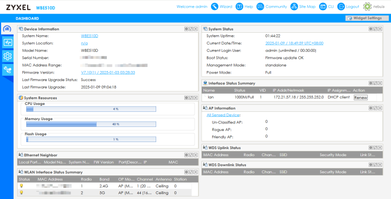

Standalone
When working in standalone mode, the Zyxel Device is configured with its built-in Web Configurator (preferred) or CLI. You can only connect to and set up one Zyxel Device at a time in this mode.
Web Configurator in Standalone Mode
See Standalone Configuration for detailed information about the standalone Web Configurator screens.

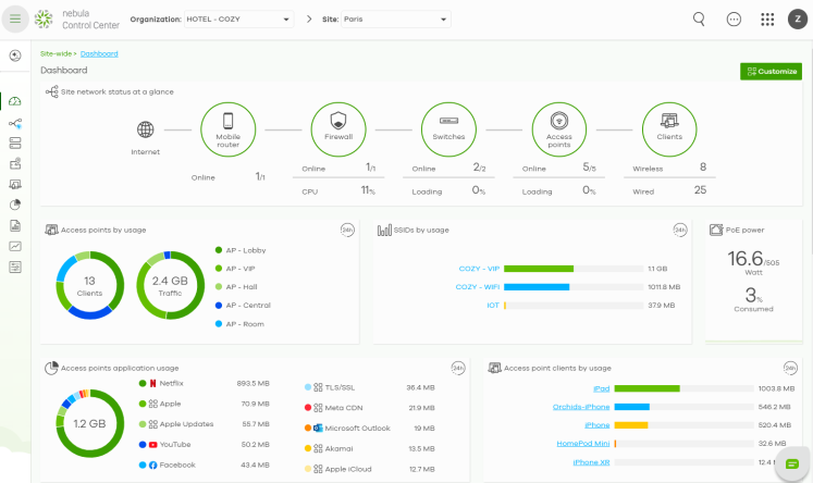

Nebula Control Center
In this mode, which is also called cloud managed mode, you can manage and monitor the Zyxel Device through the Zyxel Nebula cloud-based network management system. This means you can manage devices remotely without the need of connecting to each device directly. It offers many features to better manage and monitor not just the Zyxel Device, but your network as a whole, including supported switches and gateways. Your network can also be managed through your smartphone using the Nebula Mobile app. See Cloud Managed Mode for an example NCC managed network topology.
NCC Dashboard
Each Zyxel Device must belong to a site which must be in an organization. You can configure each Zyxel Device on its own or configure a set of Zyxel Devices together in a site. You can also monitor groups of sites in organizations.

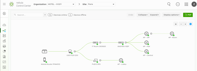

You can use the Topology in NCC which graphically presents your device and network statistics. It shows an overview of your network topology, as shown in the following figure. See the NCC User’s Guide for how to configure Nebula managed devices.
NCC Topology

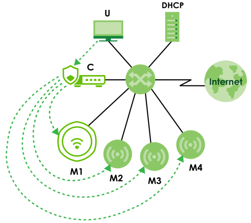

AP Controller (APC)
If the Zyxel Device supports management using an APC such as the ZyWALL ATP,or the USG FLEX series, and you have this APC in the same subnet, it can be managed by the APC automatically. To set the Zyxel Device to be managed by an APC in a different subnet or change between management modes, use the APC Discovery screen (see APC Discovery).
The following figure illustrates a wireless network managed by an APC. You (U) configure the APC (C), which then automatically updates the configurations of the managed APs (M1-M4).
Controller Managed AP Application
*Not all models support APC management. See Zyxel Device Product Feature Comparison for more information.
*If the Zyxel Device is already registered to NCC, the APC will be unable to manage it.

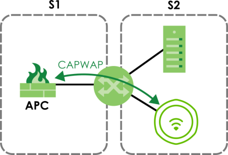

APC management and IP Subnets
An APC uses Control And Provisioning of Wireless Access Points (CAPWAP, see RFC 5415) to discover and configure multiple managed APs. By default, CAPWAP works only between Zyxel Devices with IP addresses in the same subnet.
However, you can configure the Zyxel Device and the APC to use CAPWAP with IP addresses in different subnets by doing the following.
Activate DHCP. Your network’s DHCP server must support option 138 defined in RFC 5415.
Configure DHCP option 138 with the IP address of the APC on your network.
DHCP Option 138 allows the management request (from the Zyxel Device) to reach the APC in a different subnet, as shown in the following figure.
CAPWAP and DHCP Option 138

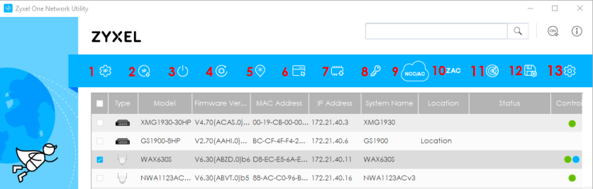

Zyxel One Network (ZON) Utility
ZON Utility is a program designed to help you deploy and manage a network more efficiently. It detects devices automatically and allows you to do basic settings on devices in the network without having to be near it.
The ZON Utility issues requests though Zyxel Discovery Protocol (ZDP) and in response to the query, the device responds back with basic information including IP address, firmware version, location, system and model name in the same broadcast domain. The information is then displayed in the ZON Utility screen and you can perform tasks like basic configuration of the devices and batch firmware upgrade in it. You can download the ZON Utility at www.zyxel.com and install it on your computer (Windows operating system).

Run the ZON Utility
1 Double-click the ZON Utility to run it.

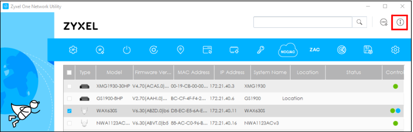

2 The first time you run the ZON Utility, you will see if your device and firmware version support the ZON Utility. Click the OK button to close this screen.
Supported Devices and Versions
If you want to check the supported models and firmware versions later, you can click the Show information about ZON icon in the upper right hand corner of the screen. Then select the Supported model and firmware version link. If your device is not listed here, see the device release notes for ZON Utility support. The release notes are in the firmware zip file on the Zyxel web site.
ZON Utility Screen
3 Select a network adapter to which your supported devices are connected.
Network Adapter

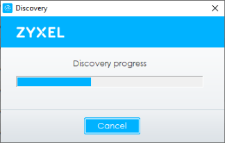

4 Click the Go button for the ZON Utility to discover all supported devices in your network.
Discovery
5 The ZON Utility screen shows the devices discovered.
ZON Utility Screen

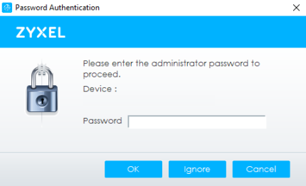

6 Select a device and then use the icons to perform actions. Some functions may not be available for your devices.
*You must know the selected device admin password before taking actions on the device using the ZON Utility icons. If the selected device is being managed or has been managed by the NCC, check Local credentials in the NCC's Site-wide > Configure > Site settings screen for the selected device's current password.
Password Prompt
The following table describes the icons numbered from left to right in the ZON Utility screen.
ZON Utility Icons
icon
DESCRIPTION
1 IP Configuration
Change the selected device’s IP address.
2 Renew IP Address
Update a DHCP-assigned dynamic IP address.
3 Reboot Device
Use this icon to restart the selected device(s). This may be useful when troubleshooting or upgrading new firmware.
4 Reset Configuration to Default
Use this icon to reload the factory-default configuration file. This means that you will lose all previous configurations.
5 Locator LED
Use this icon to locate the selected device by causing its Locator LED to blink.
6 Web GUI
Use this to access the selected device Web Configurator from your browser. You will need a username and password to log in.
7 Firmware Upgrade
Use this icon to upgrade new firmware to selected device(s) of the same model. Make sure you have downloaded the firmware from the Zyxel website to your computer and unzipped it in advance.
The ZON only supports a standalone mode AP for the firmware upgrade, it does not support to upgrade the firmware for a managed mode AP.
8 Change Password
Use this icon to change the admin password of the selected device. You must know the current admin password before changing to a new one.
9 Configure Controller Discovery and NCC Discovery
The option is available if the selected device supports AP controller (APC) discovery or Nebula Control Center (NCC) discovery. You must have Internet access to use this feature. Use this icon on the selected device to enable or disable the:
AP controller (APC) discovery feature
Nebula Control Center (NCC) discovery feature
If the feature is enabled, the selected device will try to connect to the APC or NCC. If the selected device has successfully connected to an APC, it will change to the controller managed mode. If the selected device has successfully connected to the NCC and is registered on the NCC, it will change to the cloud managed mode.
10 ZAC
Use this icon to run the Zyxel AP Configurator of the selected AP.
11 Clear and Rescan
Use this icon to clear the list and discover all devices on the connected network again.
12 Save Configuration
Use this icon to save configuration changes to permanent memory on a selected device.
13 Settings
Use this icon to select a network adapter for the computer on which the ZON utility is installed, and the utility language.
