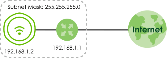

IP Setup
The figure above illustrates one possible setup of your Zyxel Device. The gateway IP address is 192.168.1.1 and the managed IP address of the Zyxel Device is 192.168.1.2 (default), but if the Zyxel Device is assigned an IP address by a DHCP server, the default (192.168.1.2) will not be used. The gateway and the Zyxel Device must belong in the same IP subnet to be able to communicate with each other.

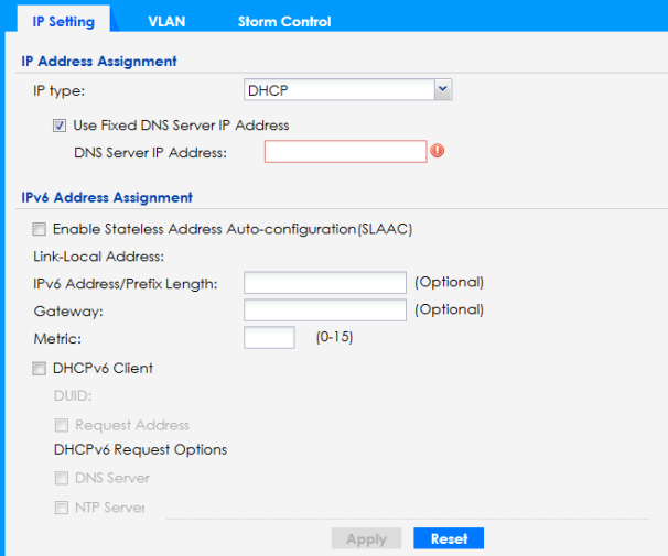

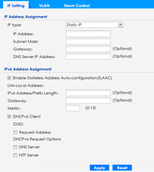

IP Setting
Use this screen to configure the IP address for your Zyxel Device. To access this screen, click Configuration > Network > IP Setting.
Configuration > Network > IP Setting (Static IP)
Configuration > Network > IP Setting (DHCP IP)
Each field is described in the following table.
Label
Description
IP Address Assignment
IP Type
Select DHCP to make the interface a DHCP client and automatically get the IP address, subnet mask, gateway and DNS Server IP address from a DHCP server.
Select Static IP to specify the IP address, subnet mask, gateway and DNS server IP address manually.
Use Fixed DNS Server IP Address
Select this if you have a preferred DNS server that you want to specify manually even if the IP type is DHCP. Setting a fixed DNS server IP address may help if you experience unreliable DNS resolution.
IP Address
Enter the IP address for this interface.
Subnet Mask
Enter the subnet mask of this interface in dot decimal notation. The subnet mask indicates what part of the IP address is the same for all computers in the network.
Gateway
Enter the IP address of the gateway. The Zyxel Device sends packets to the gateway when it does not know how to route the packet to its destination. The gateway should be on the same network as the interface.
Enter the IP address of the DNS server.
IPv6 Address Assignment
Enable Stateless Address Auto-configuration (SLAAC)
Select this to enable IPv6 stateless auto-configuration on the Zyxel Device. The Zyxel Device will generate an IPv6 address itself from a prefix obtained from an IPv6 router in the network.
Link-Local Address
This displays the IPv6 link-local address and the network prefix that the Zyxel Device generates itself for the LAN interface.
IPv6 Address/Prefix Length
Enter the IPv6 address and the prefix length for the LAN interface if you want to use a static IP address. This field is optional.
The prefix length indicates what the left-most part of the IP address is the same for all computers in the network, that is, the network address.
Gateway
Enter the IPv6 address of the default outgoing gateway using colon (:) hexadecimal notation.
Metric
Enter the priority of the gateway (if any) on the LAN interface. The Zyxel Device decides which gateway to use based on this priority. The lower the number, the higher the priority. If two or more gateways have the same priority, the Zyxel Device uses the one that was configured first. Enter zero to set the metric to 1024 for IPv6.
DHCPv6 Client
Select this option to set the Zyxel Device to act as a DHCPv6 client.
DUID
This field displays the DHCP Unique IDentifier (DUID) of the Zyxel Device, which is unique and used for identification purposes when the Zyxel Device is exchanging DHCPv6 messages with others. See IPv6 for more information.
Request Address
Select this option to get an IPv6 address from the DHCPv6 server.
DHCPv6 Request Options
Select the following DHCPv6 options to determine what additional information to get from the DHCPv6 server.
DNS Server
Select this option to obtain the IP address of the DNS server.
NTP Server
Select this option to obtain the IP address of the NTP server.
Apply
Reset
Click Reset to return the screen to its last-saved settings.

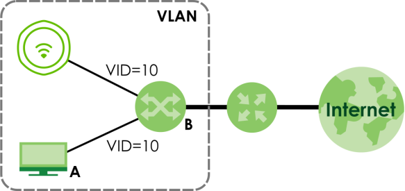

Management VLAN Setup
In the figure above, to access and manage the Zyxel Device from computer A, the Zyxel Device and switch B’s ports to which computer A and the Zyxel Device are connected should be in the same VLAN.
A Virtual Local Area Network (VLAN) allows a physical network to be partitioned into multiple logical networks. Devices on a logical network belong to one group. A device can belong to more than one group. With VLAN, a device cannot directly talk to or hear from devices that are not in the same group(s); the traffic must first go through a router.
VLAN also increases network performance by limiting broadcasts to a smaller and more manageable logical broadcast domain. In traditional switched environments, all broadcast packets go to each and every individual port. With VLAN, all broadcasts are confined to a specific broadcast domain.

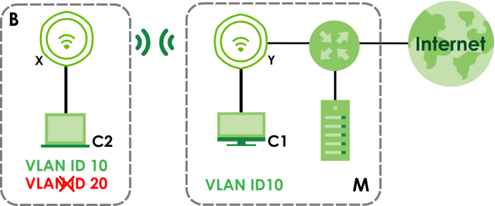

Wireless Bridge VLAN ID
Wireless bridge VLAN allows you to have clients in different WiFi networks appear to be in the same virtual network using VLAN IDs. VLAN IDs are sent across the wireless bridge so that only clients with the same VLAN ID receive that network traffic. See Zyxel Device Roles for more information on the wireless bridge.
In the figure below, a client (C2) in the branch office (B) wants to connect to the main office (M). The branch office client (C2) can connect to the main office network using the VLAN ID 10. However, the branch office client (C2) cannot connect to the to the main office network using the VLAN ID 20 because that VLAN ID does not exist in the main office network. To bridge the branch office network and the main office network, the VLAN IDs you set on the Zyxel Device (X) should be the same as the VLAN IDs you set on the root AP (Y).
Wireless Bridge VLAN ID Example

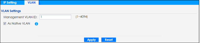

Use this screen to configure the VLAN settings for your Zyxel Device. To access this screen, click Configuration > Network > VLAN.
Configuration > Network > VLAN (for Zyxel Device with multiple Ethernet ports)
Configuration > Network > VLAN (for Zyxel Device with one Ethernet port)
Label
Description
VLAN Settings
Management VLAN ID
Enter a VLAN ID for the Zyxel Device. The range is 1–4094.
As Native VLAN
Select this option to treat the Management VLAN ID as a VLAN created on the Zyxel Device and not one assigned to it from outside the network. Outbound traffic transmitted through the Zyxel Device Ethernet port will NOT be tagged with the Management VLAN ID.
Clear this option to have the Zyxel Device add the Management VLAN ID tag to outbound traffic transmitted through the Zyxel Device Ethernet port. The uplink device connected to the Zyxel Device Ethernet port needs to have the same VLAN ID configured to receive traffic from the Zyxel Device.

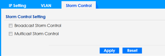

Storm Control
Traffic storm control limits the number of broadcast and/or multicast packets the Zyxel Device receives on the ports. When the maximum number of allowable broadcast and/or multicast packets is reached, the subsequent packets are discarded. Enable this feature to reduce broadcast and/or multicast packets in your network.
*Not all Zyxel Device models support the storm control feature. See the feature comparison table in Zyxel Device Product Feature Comparison.
*The maximum traffic rate can be changed using the CLI (see the CLI Reference Guide).
To access this screen, click Configuration > Network > Storm Control.
label
description
Broadcast Storm Control
Select the checkbox to enable broadcast storm control on the Zyxel Device. Enabling this will drop ingress broadcast traffic in the physical Ethernet port if it exceeds the maximum traffic rate.
Multicast Storm Control
Select the checkbox to enable multicast storm control on the Zyxel Device. Enabling this will drop ingress multicast traffic in the physical Ethernet port if it exceeds the maximum traffic rate.
Apply
Reset
