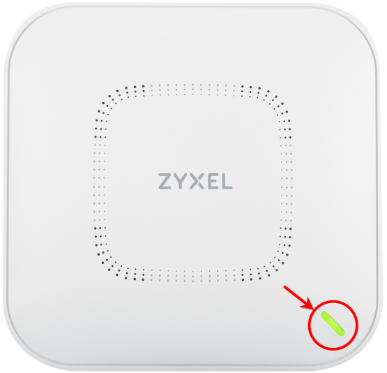

The following are the LED descriptions for the Zyxel Device.
Zyxel Device LEDs
Color
status
description
Amber
Blinks between amber and green alternately (300 milliseconds interval).
The Zyxel Device is booting up.
Green
Amber
Blinks between amber and green alternately (1 second interval).
The Zyxel Device is discovering the NCC.
Green
Amber
Blinks between amber and green alternately 3 times and then turns solid green for 3 seconds.
The Zyxel Device is managed by the NCC but fails to connect with NCC, and is reconnecting with the NCC.
Green
Green
Slow Blinking (On for 1 second, Off for 1 second)
The wireless module of the Zyxel Device is disabled or fails, the Zyxel Device is using default WiFi settings, and/or the Zyxel Device is configured to be managed by the NCC but is not yet registered with the NCC.
Green
Steady On
The Zyxel Device is ready for use, the Zyxel Device’s wireless interface is activated, and WiFi clients are connected to the Zyxel Device.
Bright Blue
Steady On
The Zyxel Device’s wireless interface is activated, but there are no WiFi clients connected.
White
Slow Blinking (On for 100 ms per second)
Locator LED is on. It switches off automatically after the configured amount of time (1-60 min). Default duration is 10 minutes.
*The color of the white LED may have slight differences (for example, very light purple) on different models.
Blue
Slow Blinking (Blink for 1 time, Off for 1 second)
The Zyxel Device is performing a Channel Availability Check (CAC) with Dynamic Frequency Selection (DFS) to monitor a channel for radar signals.
Red
On
The Zyxel Device failed to boot up or is experiencing system failure.
Fast Blinking (On for 50 milliseconds, Off for 50 milliseconds)
The Zyxel Device is undergoing firmware upgrade.
Slow Blinking (Blink for 3 times, Off for 3 seconds)
The uplink of the Zyxel Device is disconnected.

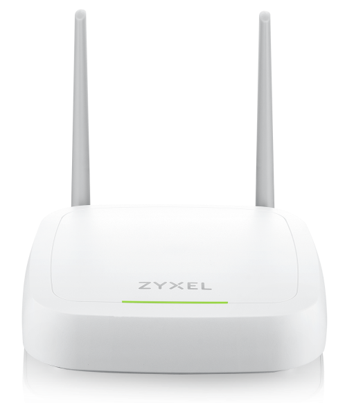

The System LED is located on the upper cover of the Zyxel Device.

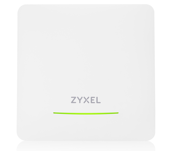

The following are the system LED indicator descriptions for the Zyxel Device.
Zyxel Device System LED
Color
status
description
Amber
Green
Amber
Green
Amber
Green
Green
Green
Steady On
Bright Blue
Steady On
White
Blue
Red
On

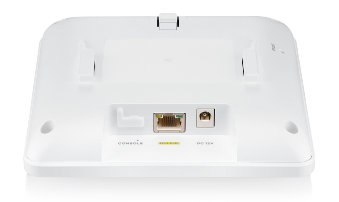

NWA50AX/NWA90AX/NWA50AX PRO/NWA90AX PRO
The following are the items on the ports panels for your Zyxel Device.
Ports and Buttons
label
description
POWER
Connect the power adapter and press the ON/OFF button to start the device
UPLINK
Connect the port to a router, a switch, or another access point (AP) to connect the Zyxel Device to the backbone of your network.
LAN
Connect computers or other Ethernet devices to Ethernet ports for Internet access.
CONSOLE
You can use the console port to manage the Zyxel Device using CLI commands. You will be prompted to enter your user name and password. See the Command Reference Guide for more information about the CLI.
When configuring using the console port, you need a computer equipped with communications software configured to the following parameters:
• Speed 115200 bps
• Data Bits 8
• Parity None
• Stop Bit 1
• Flow Control Off
RESET
Press the button for more than 5 seconds to return the Zyxel Device to the factory defaults.

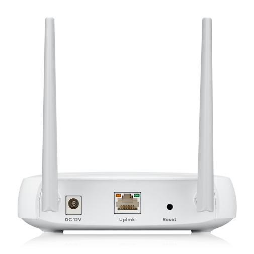

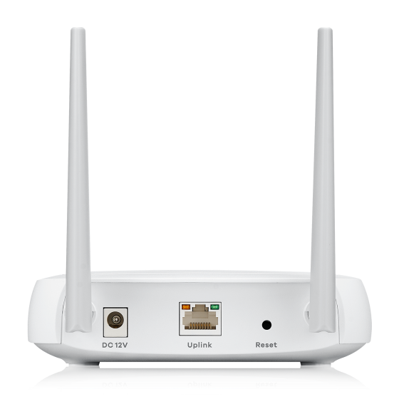

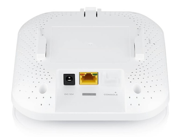

NWA30BE
Place the Zyxel Device with the ports and antennas facing you.
NWA30BE
Ports and Buttons
label
description
UPLINK
POWER
Connect the power adapter and press the ON/OFF button to start the device.
RESET
NWA50BE, NWA90BE, NWA50BE PRO, and NWA90BE PRO
Place the Zyxel Device with the ports facing you.
NWA50BE/NWA90BE/NWA50BE PRO/NWA90BE PRO
Ports and Buttons
label
description
CONSOLE
• Speed 115200 bps
• Data Bits 8
• Parity None
• Stop Bit 1
• Flow Control Off
UPLINK
POWER
RESET
NWA55BE
Place the Zyxel Device with the antennas facing you.
NWA55BE
Ports and Buttons
label
description
LAN
POWER
RESET

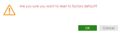

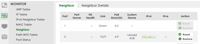

Web Configurator of the Zyxel Device Gateway
You can use this method if the Zyxel Device is connected to a Zyxel Switch with a Neighbor Reset function.
1 Log into the Zyxel switch’s Web Configurator. Go to Monitor > Neighbor, and then click the Restore button to reset the Zyxel Device to its factory default settings.
2 A pop-up window asks you to confirm that you want to reset the Zyxel Device to factory default. Click OK to proceed with reset. A count down starts.

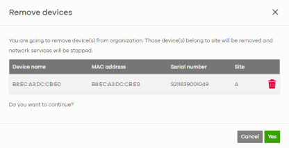

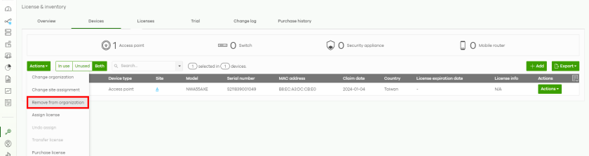

Nebula Control Center
If your Zyxel Device is registered with NCC, you can unregister it to reset it to its factory default settings.
1 Go to Organization-wide > License & inventory > Devices tab in the NCC portal.
2 Select the Zyxel Device you want to remove, then click Actions > Remove from organization.
3 Click the Yes button to confirm.

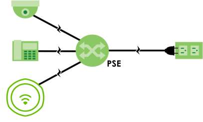

The following example shows a Power Sourcing Equipment (PSE) supplying power and transmitting data to the Zyxel Device, along with other Powered Devices (PDs) such as an IP camera and an IP telephone.
PoE Example Application - PSE

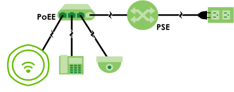

The following example shows a PSE using a PoE Extender (PoEE) to supply power and transmit data to the Zyxel Device, along with other PDs such as an IP camera and an IP telephone.
PoE Example Application - PSE with PoE Extender

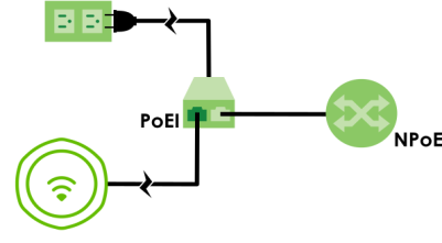

The following example shows the PoE Injector (PoEI) delivering power from the power outlet and transmitting data from the non-PoE (NPoE) device to the Zyxel Device.
PoE Example Application - PoE Injector
