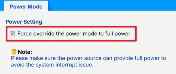

The Zyxel Device does not turn on. None of the LEDs turn on.
If you are using a power adapter to power the Zyxel Device:
1 Make sure you are using a compatible power adapter.
2 Make sure the power adapter is securely connected to the Zyxel Device and plugged into an appropriate power source.
3 Make sure the power adapter is functional.
4 If the problem persists, contact Zyxel technical support.

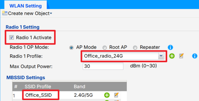

I want to set up multiple Access Points (APs).
Avoid positioning APs in direct line of sight of each other, as this can cause interference and reduce the overall performance of your WiFi network.
In case, it may be necessary to position APs in direct line of sight of each other, you can:
• Adjust the transmit power of each AP in the CONFIGURATION > Wireless > AP Management screen, so that they are not using too much power and overlapping too much with each other.
• Configure the APs to operate on non-overlapping channels, such as channels 1, 6, and 11 in the 2.4 GHz band, 5 GHz band or 6 GHz band's channels or enabling DCS to let APs scan the best channel to use. This can help to minimize co-channel interference between the APs.

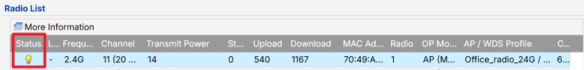

3 Go to Monitor > Wireless > AP Information to check the status of each radio band. A gray lightbulb in the Status column indicates that this radio band is inactive.

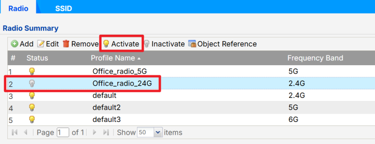

4 Go to Configuration > Object > AP Profile > Radio to activate the Radio Profile that you assign to the affected radio band. Click Apply.
5 Go to Configuration > Wireless > AP Management, and check the following:
• Select the Radio Activate check box to activate this radio band.
• Select the Radio Profile that you activated earlier. If you select an inactive Radio Profile, this radio band will remain inactive even if the Radio Activate check box is selected.
• Select the SSID Profile that you want to use.
• Click Apply.
If the SSID is not assigned to any radio, it is not broadcast. In MBSSID Settings, make sure the SSID is assigned to at least one 2.4 GHz, 5 GHz, or 6 GHz radio.
6 The radio band should now be active. Go to Monitor > Wireless > AP Information and check the Status column. A yellow lightbult indicates that this radio band is active.

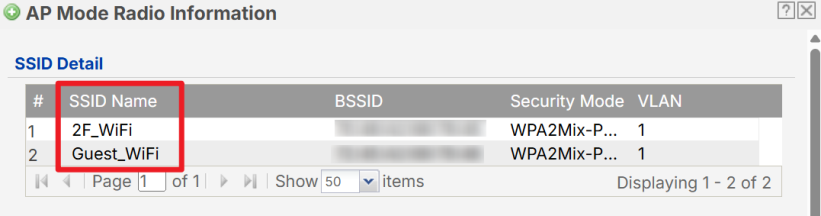

7 Select the radio band and click More Information to see the SSID Name.

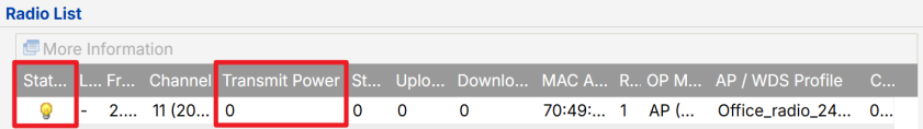

9 Go to Monitor > Wireless > AP Information and check the Status column. If the Status lightbulb is yellow, but the Transmit Power is 0, it indicates that the radio band is active but is not transmitting WiFi traffic.

11 If the Zyxel Device still has no Transmit Power, and you are using a passive PoE injector that does not support IEEE 802.3at/bt PoE negotiation, go to Configuration > System > Power Mode, select Force override the power mode to full power, and click Apply.
*Do not enable this option when using an IEEE-compliant PoE switch or PoE injector, as the Zyxel Device automatically negotiates the required power.
