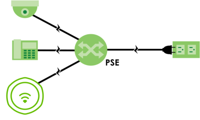

The following example shows a Power Sourcing Equipment (PSE) supplying power and transmitting data to the Zyxel Device, along with other Powered Devices (PDs) such as an IP camera and an IP telephone.
PoE Example Application - PSE

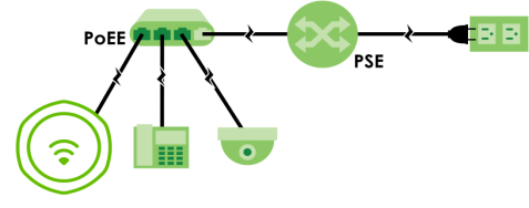

The following example shows a PSE using a PoE Extender (PoEE) to supply power and transmit data to the Zyxel Device, along with other PDs such as an IP camera and an IP telephone.
PoE Example Application - PSE with PoE Extender

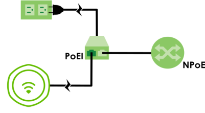

The following example shows the PoE Injector (PoEI) delivering power from the power outlet and transmitting data from the non-PoE (NPoE) device to the Zyxel Device.
PoE Example Application - PoE Injector
