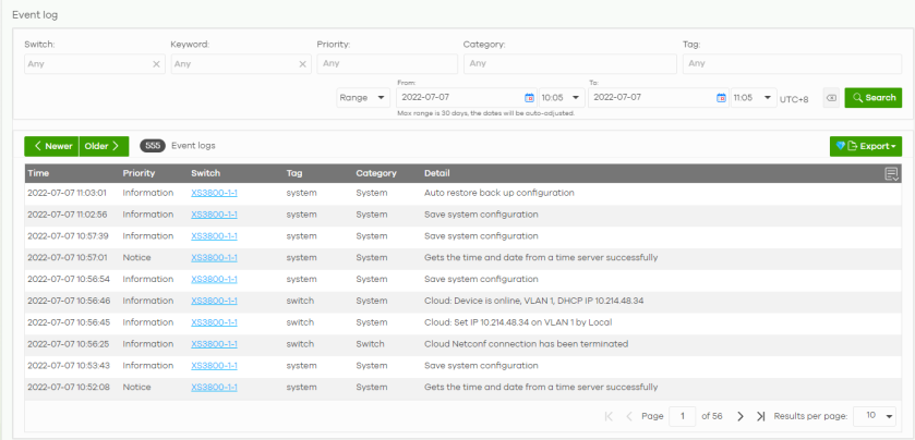

Event Log
Use this screen to view Nebula Device log messages. You can enter the Nebula Device name or a key word, select one or multiple event types, or specify a date/time or even a time range to display only the log messages related to it.
Click Site-wide > Monitor > Switches > Event log to access this screen.

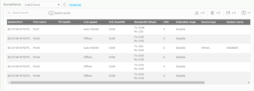

Surveillance
Use this screen to view information about Powered Devices (PDs) connected to ports on the Nebula Device.
Click Site-wide > Monitor > Switches > Surveillance to access this screen.
Label
Description
Search ports
Enter a keyword to filter the list of ports or devices.
N switch ports
This shows the number of Nebula Device ports (N) in the list.
This shows the number of connected PDs that did not respond to an automatic PD alive check.
This shows the number of ONVIF-compatible IP camera devices connected to Nebula Devices in the site.
This shows the number of ONVIF-compatible NVR devices connected to Nebula Devices in the site.
This shows the number of connected devices that did not respond to an ONVIF discovery query, or are of an unknown type.
Switch/Port
This shows the port number of the Nebula Device.
Port name
This shows the port description on the Nebula Device.
PD health
This shows the status of auto PD recovery on this port.
Red: The Nebula Device failed to get information from the PD connected to the port using LLDP, or the connected PD did not respond to the Nebula Device’s ping requests.
Yellow: The Nebula Device is restarting the connected PD by turning the power off and turning it on again.
Green: The Nebula Device successfully discovered the connected PD using LLDP or ping.
--: Auto PD Recovery is not enabled on the Nebula Device and/or the port, or the switch is not supplying power to the connected PD.
*For details on configuring auto PD recovery on a port, see Switch Ports.
Link speed
This shows the speed (either 10M for 10 Mbps, 100M for 100 Mbps, or 1G for 1 Gbps) and the duplex (F for full duplex or H for half). This field displays Down if the port is not connected to any device.
PoE draw(W)
This shows the total power that the connected PD draws from the port, in watts. This allows you to plan and use within the power budget of the Nebula Device.
Bandwidth (Kbps)
Tx shows the number of kilobytes per second transmitted on this port. Rx shows the number of kilobytes per second received on this port.
CRC
This shows the number of packets received with CRC (Cyclic Redundant Check) errors.
Extended range
This shows whether extended range is enabled on the port.
Device type
This shows the device type of the PD, as reported by ONVIF discovery.
System name
This shows the name of the connected PD, as reported by ONVIF or LLDP.
IP
This shows the IP address of the connected PD, as reported by ONVIF or LLDP.
Discovered devices
This shows how many devices are connected to the port.
Click the number to go to the Surveillance Port Details screen.

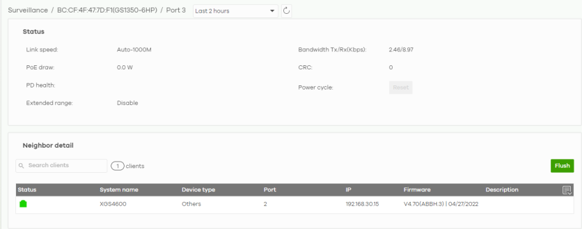

Use this screen to view detailed information about a port on the Surveillance screen.
Go to Site-wide > Monitor > Switches > Surveillance and click on a value in the Discovered Devices column to access this screen.
Site-wide > Monitor > Switches > Surveillance > Port Details
Label
Description
Status
Link speed
PoE draw
PD health
--: Auto PD Recovery is not enabled on the Nebula Device and/or the port, or the Nebula Device is not supplying power to the connected PD.
Extended range
Bandwidth Tx/Rx (%)
CRC
Power reset
Click Power reset to power off the PD connected to the port, by temporarily disabling then re-enabling PoE.
Neighbor detail
This section shows all clients connected to the port.
Search clients
Search for one or more clients in the list by keyword, status, system name, port, IP address, or firmware version.
clients
This shows the number of clients connected to this port.
Flush
Click this to remove all offline clients from the list.
Status
This shows whether the client is online (green) or offline (red), and whether the client is wired or wireless.
System name
This displays the system name of the Nebula Device.
Port
This displays the number of the Nebula Device port that is connected to the Nebula Device.
IP
This shows the IP address of the Nebula Device.
Firmware
This shows the firmware version currently installed on the Nebula Device.
Description
This shows the descriptive name of the Nebula Device.

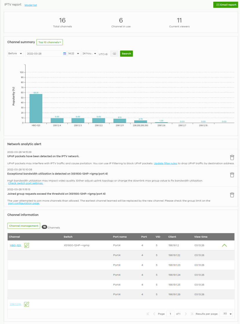

IPTV Report
Use this screen to view available IPTV channels and client information.
Click Site-wide > Monitor > Switches > IPTV report to access this screen.
Site-wide > Monitor > Switches > IPTV Report
Label
Description
IPTV report
Click Model list to show the Non-supported model list. Click See more to go to the Help > Support tools > Device function table screen.
Email report
Click this button to send channel summary report by email, change the report logo and set email schedules.
Total channels
This shows the total number of IPTV channels that match the search criteria.
Channel in use
This shows the number of channels that are being watched by IPTV clients.
Current viewers
This shows the number of clients who are watching the IPTV channels.
Channel Summary
Select to view the channels according to the ranking. Alternatively, select Select channels to choose specific channels and click Apply.
Search
Specify a date/time and select to view the channels available in the past day, week or month before the specified date/time after you click Search.
You can also select Range in the second field, set a time range and click Search to display only the channels available within the specified period of time.
y-axis
The y-axis represents the Popularity (%) of IPTV channels.
x-axis
The x-axis shows the name of the IPTV channel. It shows the channel’s multicast group address by default.
Network Analytic Alert
This shows the alerts the NCC generates when an error or something abnormal is detected on the IPTV network.
For example, the maximum number of the IGMP multicast groups (TV channels) a Nebula Device port can join is reached and new groups replace the earliest ones, UPnP packets are detected on the IPTV network and may interfere with IPTV traffic to cause TV pixelation, or high bandwidth usage on a certain Nebula Device port results in loss of video quality.

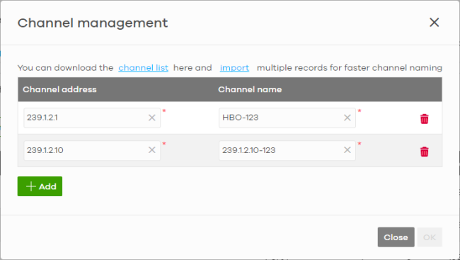

Channel Information
Channel Management
Download the channel list and import multiple records for faster channel naming. Click Add to add new channels.
Channel
This shows the name of the channel. Click the edit icon to change the channel name.
Click the channel name to display the channel’s client statistics. See Channel Information.

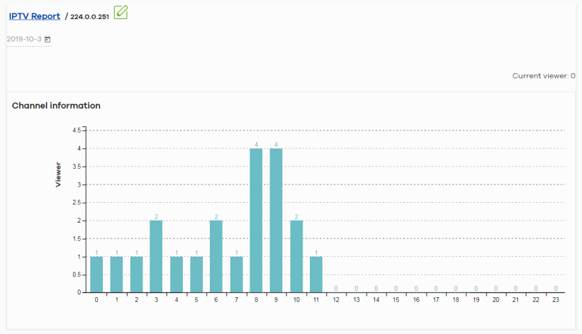

Channel Information
Use this screen to view the IPTV channel’s client information and statistics. To access this screen, click a channel name from the Channel Information list in the Site-wide > Monitor > Switches > IPTV Report screen.
Site-wide > Monitor > Switches > IPTV Report: Channel Information
Switches > Monitor > Switches > IPTV Report: Channel Information
Label
Description
Select a specific date to display only the clients who watch the IPTV channel on that day.
Current Viewer
This shows the number of clients who are currently watching the IPTV channel.
y-axis
The y-axis shows the number of clients watching the IPTV channel.
x-axis
The x-axis shows the hour of the day in 24-hour format.
Switch
This shows the name of the Nebula Device to which the client is connected.
Port Name
This shows the name of the Nebula Device port to which the client is connected.
Port
This shows the number of the Nebula Device port to which the client is connected.
VID
This shows the ID number of the VLAN to which the Nebula Device port belongs.
Client
This shows the IP address of the client who is watching the TV program on the channel.
View-time
This shows the amount of time the client has spent watching the IPTV channel.

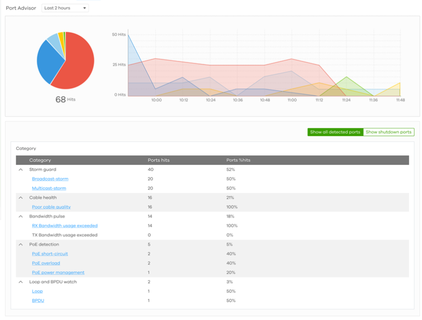

Port Advisor
Use this screen to monitor the following Nebula Switch port abnormalities:
Network loops and BPDU (Bridge Protocol Data Units) watch
PoE alerts
Cable health
Network traffic surge and storm protection
Port bandwidth monitoring
Click Site-wide > Monitor > Switches > Port advisor to access this screen.

Port advisor
Select to view which Nebula Device port has detected abnormalities in the Last hour, Last 12 hours, Last 24 hours, or Custom range. The maximum Custom range is 30 days within the past 365 days.
Show all detected ports
Click this to show all ports that have been online with detected abnormalities during the selected period.
Show shutdown ports
Click this to show all ports that were shut down to fix the abnormalities. This will show for 30 days.
Category
This shows the name of the category to which the abnormality belongs.
Ports hits
This shows the amount of hits on a specific abnormality category.
Ports % hits
This shows the percentage of the hit counts for the abnormality encountered by a specific category.
Storm guard

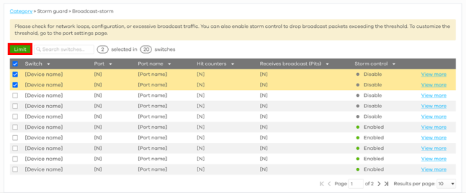

Storm guard limits the number of broadcast and multicast packets the Nebula Device receives per second on the ports. When the maximum number of allowable packets is reached per second, the event will be counted. Click the following categories to display the individual category statistics table.
Broadcast-storm – This shows the number of times the maximum number of broadcast packets per second that the Nebula Device accepts on the ports exceeds the threshold set in Site-wide > Configure > Switches > Port: Broadcast Limit (pps).
Click the Broadcast-storm link to view a list of the names of the switches, port numbers, port names that triggered the hit, number of hits, number of broadcast packets received, and Storm Control enabled/disabled. Select the port(s) and click Limit to set a custom broadcast/multicast limit (pps) to drop packets that exceed this threshold. This will override your setting in Site-wide > Configure > Switches > Port: Broadcast Limit (pps) for the specific port.
*You cannot set a custom broadcast/multicast limit on a port that is bound to a template or port profile.
Multicast-storm – This shows the number of times the maximum number of multicast packets per second that the Nebula Device accepts on the ports that exceed the threshold set in Site-wide > Configure > Switches > Port: Multicast Limit (pps).
Cable health
A Poor cable quality hit is triggered when Port advisor detects that the network cable may be damaged.
Click the Poor cable quality link to view a list of the names of the switches, port numbers, port names that triggered the hit, and the number of hits.
Bandwidth pulse
A hit is triggered when any of the following conditions are met.
RX bandwidth usage exceeded the specified threshold that you set in Site-wide > Configure > Alert settings: Port advisor: Bandwidth pulse.
TX bandwidth usage exceeded the specified threshold that you set in Site-wide > Configure > Alert settings: Port advisor: Bandwidth pulse.
PoE detection
PoE short-circuit – There is a short circuit detected between the port and the PD (powered device).
PoE overload – The PD requested more PoE power than the port allows.
PoE power management – The PD is unable to get PoE power based on its PoE priority setting in Site-wide > Configure > Switches > Switch ports.
Loop and BPDU watch
Loop – The loop guard feature detects that packets sent out on a port loop back to the Nebula Device.
BPDU – The BPDU guard feature allows you to prevent any new STP-aware (Spanning Tree Protocol) switch from connecting to an existing network and causing STP topology changes in the network.
Click the Loop or BPDU link to view a list of the names of the switches, port numbers, port names that triggered the hit, and the number of hits. Select the port(s) to shut down and click Shutdown.
*You cannot shut down a port that is bound to a template or port profile. The following screen appears. Click Close to exit.
