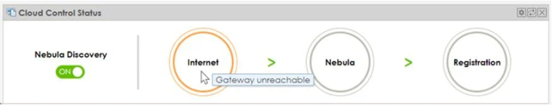

I cannot see my Nebula Devices in the NCC Dashboard or the corresponding Nebula Device monitor page.
Check the Nebula Device’s local Web Configurator’s Dashboard. The Cloud Control Status displays the status of the Nebula Device’s Internet and NCC connection and registration status. Make sure that the Nebula Device has NCC Discovery enabled.
If the Nebula Device cannot connect to the Internet or NCC, hover the mouse over the Internet circle to check the error message. Check your local network settings.

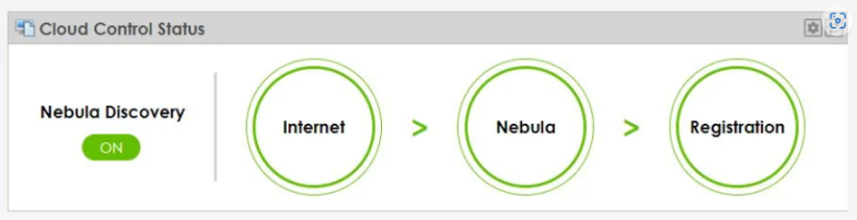

When the Nebula Device is online in NCC, all circles are green.

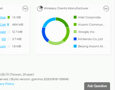

NCC Live Chat
Clicking the Ask Question button at the bottom of NCC window prompts you to search for a solution on the Zyxel forum, and then connects you to a Zyxel technical support agent. If a technical support agent is not available, you can fill in a form to send your question to Zyxel by email.
*This is an NCC Professional Pack feature.
Live chat might be limited to a certain number of hours per day. The time that live chat is available varies depending on your country.
