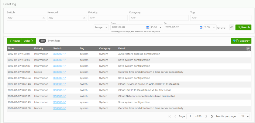

Event Log
Use this screen to view Nebula Device log messages. You can enter the Nebula Device name or a key word, select one or multiple event types, or specify a date/time or even a time range to display only the log messages related to it.
Click Site-wide > Monitor > Switches > Event log to access this screen.

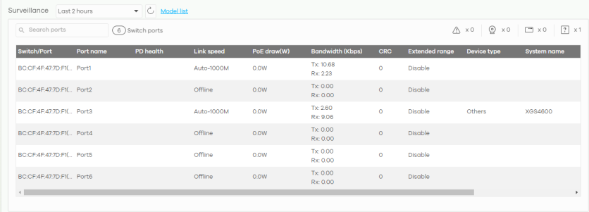

Surveillance
Use this screen to view information about Powered Devices (PDs) connected to ports on the Nebula Device.
Click Site-wide > Monitor > Switches > Surveillance to access this screen.
Label
Description
Search ports
Enter a keyword to filter the list of ports or devices.
N switch ports
This shows the number of Nebula Device ports (N) in the list.
This shows the number of connected PDs that did not respond to an automatic PD alive check.
This shows the number of ONVIF-compatible IP camera devices connected to Nebula Devices in the site.
This shows the number of ONVIF-compatible NVR devices connected to Nebula Devices in the site.
This shows the number of connected devices that did not respond to an ONVIF discovery query, or are of an unknown type.
Switch/Port
This shows the port number of the Nebula Device.
Port name
This shows the port description on the Nebula Device.
PD health
This shows the status of auto PD recovery on this port.
Red: The Nebula Device failed to get information from the PD connected to the port using LLDP, or the connected PD did not respond to the Nebula Device’s ping requests.
Yellow: The Nebula Device is restarting the connected PD by turning the power off and turning it on again.
Green: The Nebula Device successfully discovered the connected PD using LLDP or ping.
--: Auto PD Recovery is not enabled on the Nebula Device and/or the port, or the switch is not supplying power to the connected PD.
*For details on configuring auto PD recovery on a port, see Switch Ports.
Link speed
This shows the speed (either 10M for 10 Mbps, 100M for 100 Mbps, or 1G for 1 Gbps) and the duplex (F for full duplex or H for half). This field displays Down if the port is not connected to any device.
PoE draw(W)
This shows the total power that the connected PD draws from the port, in watts. This allows you to plan and use within the power budget of the Nebula Device.
Bandwidth (Kbps)
Tx shows the number of kilobytes per second transmitted on this port. Rx shows the number of kilobytes per second received on this port.
CRC
This shows the number of packets received with CRC (Cyclic Redundant Check) errors.
Extended range
This shows whether extended range is enabled on the port.
Device type
This shows the device type of the PD, as reported by ONVIF discovery.
System name
This shows the name of the connected PD, as reported by ONVIF or LLDP.
IP
This shows the IP address of the connected PD, as reported by ONVIF or LLDP.
Discovered devices
This shows how many devices are connected to the port.
Click the number to go to the Surveillance Port Details screen.

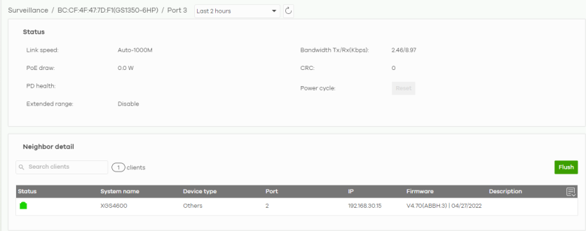

Use this screen to view detailed information about a port on the Surveillance screen.
Go to Site-wide > Monitor > Switches > Surveillance and click on a value in the Discovered Devices column to access this screen.
Site-wide > Monitor > Switches > Surveillance > Port Details
Label
Description
Status
Link speed
PoE draw
PD health
--: Auto PD Recovery is not enabled on the Nebula Device and/or the port, or the Nebula Device is not supplying power to the connected PD.
Extended range
Bandwidth Tx/Rx (%)
CRC
Power reset
Click Power reset to power off the PD connected to the port, by temporarily disabling then re-enabling PoE.
Neighbor detail
This section shows all clients connected to the port.
Search clients
Search for one or more clients in the list by keyword, status, system name, port, IP address, or firmware version.
clients
This shows the number of clients connected to this port.
Flush
Click this to remove all offline clients from the list.
Status
This shows whether the client is online (green) or offline (red), and whether the client is wired or wireless.
System name
This displays the system name of the Nebula Device.
Port
This displays the number of the Nebula Device port that is connected to the Nebula Device.
IP
This shows the IP address of the Nebula Device.
Firmware
This shows the firmware version currently installed on the Nebula Device.
Description
This shows the descriptive name of the Nebula Device.

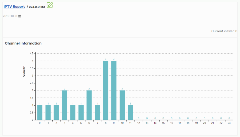

Channel Information

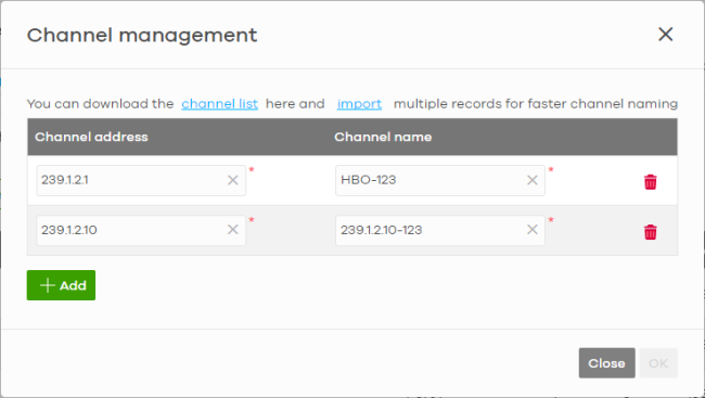

Channel Management
Download the channel list and import multiple records for faster channel naming. Click Add to add new channels.
Channel
This shows the name of the channel. Click the edit icon to change the channel name.
Click the channel name to display the channel’s client statistics. See Channel Information.
Switch
This shows the name of the Nebula Device to which the client is connected.
Port Name
This shows the name of the Nebula Device port to which the client is connected.
Port
This shows the number of the Nebula Device port to which the client is connected.
VID
This shows the ID number of the VLAN to which the Nebula Device port belongs.
Client
This shows the IP address of the client who is watching the TV program on the channel.
View-time
This shows the amount of time the client has spent watching the IPTV channel.

Channel Information
Use this screen to view the IPTV channel’s client information and statistics. To access this screen, click a channel name from the Channel Information list in the Site-wide > Monitor > Switches > IPTV Report screen.
Site-wide > Monitor > Switches > IPTV Report: Channel Information
Switches > Monitor > Switches > IPTV Report: Channel Information
Label
Description
Select a specific date to display only the clients who watch the IPTV channel on that day.
Current Viewer
This shows the number of clients who are currently watching the IPTV channel.
y-axis
The y-axis shows the number of clients watching the IPTV channel.
x-axis
The x-axis shows the hour of the day in 24-hour format.
Switch
Port Name
Port
VID
Client
View-time

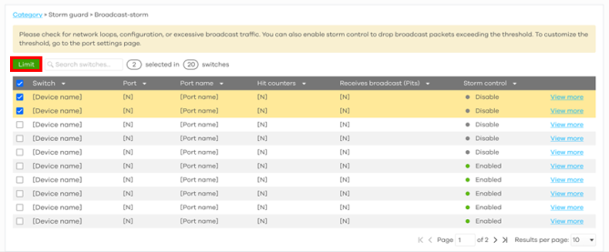

Storm guard limits the number of broadcast and multicast packets the Nebula Device receives per second on the ports. When the maximum number of allowable packets is reached per second, the event will be counted. Click the following categories to display the individual category statistics table.
Broadcast-storm – This shows the number of times the maximum number of broadcast packets per second that the Nebula Device accepts on the ports exceeds the threshold set in Site-wide > Configure > Switches > Port: Broadcast Limit (pps).
Click the Broadcast-storm link to view a list of the names of the switches, port numbers, port names that triggered the hit, number of hits, number of broadcast packets received, and Storm Control enabled/disabled. Select the port(s) and click Limit to set a custom broadcast/multicast limit (pps) to drop packets that exceed this threshold. This will override your setting in Site-wide > Configure > Switches > Port: Broadcast Limit (pps) for the specific port.

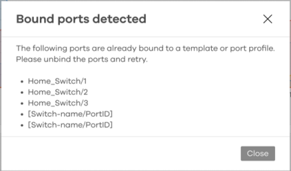

*You cannot set a custom broadcast/multicast limit on a port that is bound to a template or port profile.
Multicast-storm – This shows the number of times the maximum number of multicast packets per second that the Nebula Device accepts on the ports that exceed the threshold set in Site-wide > Configure > Switches > Port: Multicast Limit (pps).

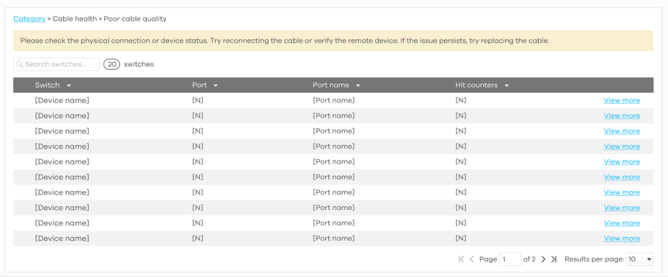

Cable health
A Poor cable quality hit is triggered when Port advisor detects that the network cable may be damaged.
Click the Poor cable quality link to view a list of the names of the switches, port numbers, port names that triggered the hit, and the number of hits.

*You cannot shut down a port that is bound to a template or port profile. The following screen appears. Click Close to exit.

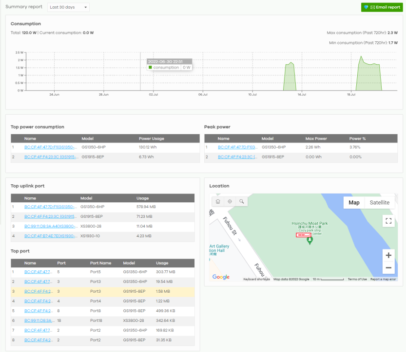

Summary Report
This screen displays network statistics for Nebula Devices of the selected site, such as bandwidth usage, top ports and/or top Nebula Devices.
Click Site-wide > Monitor > Switches > Summary Report to access this screen.
Label
Description
Switch – Summary report

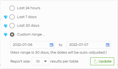

Select to view the report for the past day, week or month. Alternatively, select Custom range... to specify a time period the report will span. You can also select the number of results you want to view in a table.
Email report
Click this button to send summary reports by email, change the logo and set email schedules.
Consumption
Total
This shows the total power consumption of the Nebula Device ports.
Current Consumption
This shows the current power consumption of the Nebula Device ports.
Max Consumption
This shows the maximum power consumption of the Nebula Device ports.
Min Consumption
This shows the minimum power consumption of the Nebula Device ports.
y-axis
The y-axis shows how much power is used in Watts.
x-axis
The x-axis shows the time period over which the power consumption is recorded.
Top power consumption
This shows the ranking of the Nebula Device.
Name
Model
This shows the model number of the Nebula Device.
Power Usage
This shows the total amount of power consumed by the Nebula Device’s connected PoE devices during the specified period of time.
Peak Power
Name
Model
Max Power
This shows the maximum power consumption for the Nebula Device’s connected PoE devices during the specified period of time.
Power %
This shows what percentage of the Nebula Device’s total power budget has been consumed by connected PoE powered devices.
Top uplink port
Name
Model
Usage
This shows the amount of data that has been transmitted through the Nebula Device’s uplink port.
Top port
This shows the ranking of the Nebula Device port.
Name
Port
This shows the port number on the Nebula Device.
Model
Usage
This shows the amount of data that has been transmitted through the Nebula Device’s port.
Location
This shows the location of the Nebula Devices on the map.
