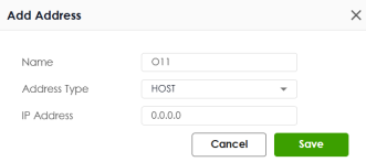

Criteria | |
Incoming | Select an interface or zone from the drop-down list to enforce the policy on the incoming traffic from the selected interface or zone interface member. Select any to enforce the policy on any incoming traffic from internal interfaces. |
Source Address | Select an object or group from the drop-down list to enforce the policy on traffic from the selected object or group members. Select any to apply the policy to all traffic from IPv4 addresses. |
Destination Address | Select an object or group from the drop-down list to enforce the policy on traffic to the selected object or group members. Select any to apply the policy to all traffic going to IPv4 addresses. |
Exempt List | Create a list to exempt specific traffic from the policy. You can exempt traffic by source IP address or service. Select an entry from the list to exempt specific traffic with that IP address or service from captive portal authentication. |
Add | Click this to create a new entry. |
Remove | Select an entry and click this to delete it. |

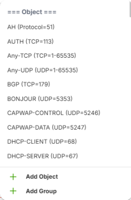

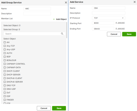

Type | Select the type of traffic: • Source IP: Exempts traffic with a specific source destination ports or IP protocol. • Service: Exempts traffic with a specific service port, such as 21 for FTP traffic. You may also select a service group. ![]() |
Object | Select an object of IP address or service you created. To create an object, click Add Object. Add a new object when you select Source IP as the Type: ![]() • Name: Enter the name of this object. It must begin with a letter and cannot exceed 31 characters. The valid characters are A-Z, a-z, 0-9, underscores (_), dashes (-), and dots (.). Spaces are not allowed. • Address Type: Select the address type of this object from the drop-down list. • IP Address: Enter the source IP address of the object. • Network: Enter an IPv4 address in CIDR notation, for example, 192.168.1.1/24. • Netmask: This field displays the subnet mask depends on the Network you entered. • Cancel: Click Cancel to close the window with changes unsaved. • Save: Click Save to save the entry. Add a new object or group when you select Service as the Type: ![]() • Name: Enter the name of this object. It must begin with a letter and cannot exceed 30 characters. The valid characters are A-Z, a-z, 0-9, underscores (_), dashes (-), and dots (.). Spaces are not allowed. • Description: Enter a description for the object. • IP Protocol: Select the IP portal of the object from the drop-down list. TCP and UDP: If you select TCP or UDP as the IP Protocol, enter the Starting Port and Ending Port from 1 to 65535. ICMP: If you select ICMP or ICMPv6 as the IP Protocol, select the ICMP Type from the drop-down list. User Defined: If you select User Defined as the IP Protocol, enter the IP Protocol No. from 1 to 255. • Cancel: Click Cancel to close the window with changes unsaved. • Save: Click Save to save the entry. |
Remove | Select an entry and click this icon to delete it. ![]() |

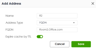

Enable Walled Garden | Slide the switch to the right to enable walled garden of the policy. Enable this and define one or more web site addresses that all clients can access without logging in. |

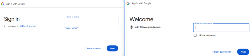

Trusted Identity Provider | If an OIDC server is used for user authentication, select the OIDC provider to enable the predefined walled garden list associated with that provider. See The Settings Screen for details on keeping this allow list up to date. See Add an OIDC Server for more information on OIDC. |
Walled Garden List | Select the object you created. The selected objects will be applied to the policy. This list allows you to specify walled garden web site links, which use a FQDN (Fully Qualified Domain Name, consist of a host name and a domain name), domain name, and IPv4 address for web sites that clients are allowed to access without logging in. |
Type | Select the type of traffic allowed in the walled garden: • Allows traffic to the specified fully qualified domain name (for example, host.example.com) without logging in. • Domain Name: Allows traffic to any host within the specified domain (for example, ‘example.com’ or ‘*.example.com’, which does not include ‘example.com’) without logging in. • IPv4 Address: Allows traffic to the specified IP address (for example, 192.168.1.10) without logging in. |
Object | Select an object you created. To create an object, click Add Object. ![]() • Name: Enter the name of this object. It must begin with a letter and cannot exceed 30 characters. The valid characters are A-Z, a-z, 0-9, underscores (_), dashes (-), and dots (.). Spaces are not allowed. • Address Type: Select the address type of the object you want to create from the drop-down list. • FQDN: Enter the FQDN of the of a web site. An FQDN starts with a host name and continues all the way up to the top-level domain name. For example, www.zyxel.com.tw is a fully qualified domain name, where “www” is the host, “zyxel” is the third-level domain, “com” is the second-level domain, and “tw” is the top level domain. Underscores are not allowed. Use "*" as a prefix in the FQDN for a wildcard domain name (for example, *.example.com). • Expire cache by TTL: Slide the switch to refresh the data in the cache when it expires based on the Time-to-Live (TTL). The cached data remains valid for the specified TTL duration before it is refreshed or discarded. • Cancel: Click Cancel to close the window with changes unsaved. • Save: Click Save to save the entry. |

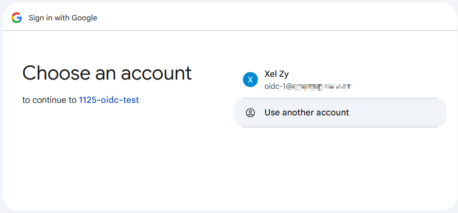

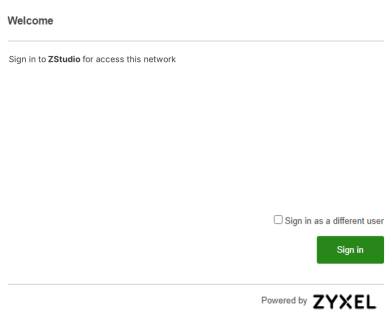

Sign-in Method | Use this to configure how clients authenticate or acknowledge terms before accessing the network. |
Click-to-continue | Select this to block network access until clients agree to the user agreement policy. |
Sign-on With | Select this and choose an authentication policy you configured in User & Authentication > User Authentication > AAA Server to block network access until a client authenticates. • local: Use the default authentication policy on the Zyxel Device. • Nebula cloud authentication: Use the NCAS (Nebula Cloud Authentication Server). |
Portal Type | Use this to configure a portal that clients are directed to for network access. |
Internal | Select this to use the Default web page on the Zyxel Device or a custom web page you configured on Nebula. • Default: Use the default web page on the Zyxel Device, or the default Nebula web page if the Zyxel Device is managed through Nebula. • (Custom Theme Name): Use the custom web page configured on Nebula if the Zyxel Device is managed through Nebula. |
External | Select this and enter the URL of an external portal. You can configure the look and feel of the web portal page. Specify the login page’s URL; for example, http://IIS server IP Address/login.asp. The Internet Information Server (IIS) is the web server on which the web portal files are installed. |

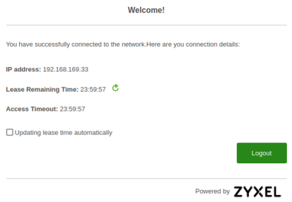

After the Captive Portal Page Where the User Should Go? | • Select Stay on Captive Portal Authenticated Successfully Page to keep users on the success page after a successful login. • Select Stay on Login Session Page to keep users on the login page after a successful login. • Select To promotion URL and specify an URL to redirect users to after a successful login. |
Redirect TCP Port 443 Traffic to Login Page | Slide the switch to the right to require that users use HTTPS for access to the captive portal. Users may see a certificate warning when they log into the captive portal. Refer to Redirect TCP Port 443 Traffic to Login Page for example scenarios. |
Idle Timeout | Slide the switch to the right and enter the number of minutes a user can remain logged in but without activity before being automatically logged out. |
