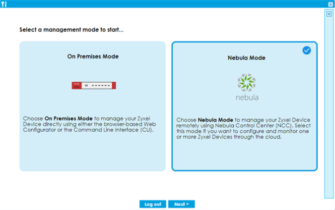

Nebula
Select Cloud Monitoring Mode to monitor your Zyxel Device using Nebula Control Center (NCC) but configure your Zyxel Device in On Premises Mode using the web configurator/CLI at the same time. You can allow remote access to the web configurator remotely using reverse SSH or HTTPS tunnel.
*You cannot set the Zyxel Device to Cloud Monitoring Mode if Device HA is enabled on the Zyxel Device.
Select Cloud Mode to manage your Zyxel Device using Nebula only. Use this mode to manage your Zyxel Device with accounts at different privilege levels. You can also manage your Zyxel Device licenses and check status through Nebula.
Your Zyxel Device uses Native Mode to register with Nebula. See Cloud Management Scenario A - Native Mode for more information on registering your Zyxel Device with Nebula using Native Mode.

Nebula Mode to Cloud Monitoring Mode
1 Remove the Zyxel Device from the organization and site.
2 If the Zyxel Device is connected to Nebula, the Zyxel Device will automatically reset after you remove the Zyxel Device from the organization and site. If the Zyxel Device is not connected to Nebula, press the reset button.
3 After the PWR LED turns steady green, log into the Zyxel Device, select On Premises Mode, go to Configuration > Mgmt. & Analytics > Nebula, select Cloud Monitoring Mode and then follow the screen prompts.
Cloud Monitoring Mode to Nebula Mode
1 Remove the Zyxel Device in cloud monitoring mode from the organization and site.
2 Back up your current configuration in Maintenance > File Manager > Configuration File.
3 Reset the Zyxel Device to the factory default by pushing the Reset button until the port connection LEDs turn off (after about 5 seconds). Your Zyxel Device will reboot to the factory defaults.
4 Log into the Zyxel Device. Run the wizard and choose Nebula Mode.
