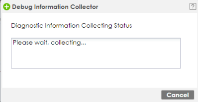

Collect Now
Click this to have the Zyxel Device run the uploaded script and create a new diagnostic file.
Wait while information is collected.
