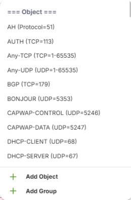

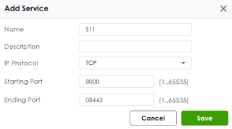

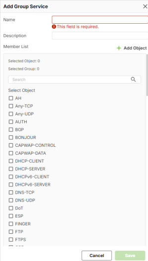

Type | Select the type of traffic: • Source IP: Exempts traffic with a specific source destination ports or IP protocol. • Service: Exempts traffic with a specific service port, such as 21 for FTP traffic. You may also select a service group. ![]() |

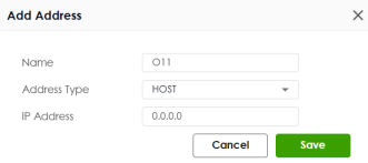

Object | Select an object of IP address or service you created. To create an object, click Add Object. Add a new object when you select Source IP as the Type: ![]() • Name: Enter the name of this object. It must begin with a letter and cannot exceed 31 characters. The valid characters are A-Z, a-z, 0-9, underscores (_), dashes (-), and dots (.). Spaces are not allowed. • Address Type: Select the address type of this object from the drop-down list. • IP Address: Enter the source IP address of the object. • Network: Enter an IPv4 address in CIDR notation, for example, 192.168.1.1/24. • Netmask: This field displays the subnet mask depends on the Network you entered. • Cancel: Click Cancel to close the window with changes unsaved. • Save: Click Save to save the entry. Add a new object or group when you select Service as the Type: ![]() • Name: Enter the name of this object. It must begin with a letter and cannot exceed 30 characters. The valid characters are A-Z, a-z, 0-9, underscores (_), dashes (-), and dots (.). Spaces are not allowed. • Description: Enter a description for the object. • IP Protocol: Select the IP portal of the object from the drop-down list. TCP and UDP: If you select TCP or UDP as the IP Protocol, enter the Starting Port and Ending Port from 1 to 65535. ICMP: If you select ICMP or ICMPv6 as the IP Protocol, select the ICMP Type from the drop-down list. User Defined: If you select User Defined as the IP Protocol, enter the IP Protocol No. from 1 to 255. • Cancel: Click Cancel to close the window with changes unsaved. • Save: Click Save to save the entry. |

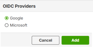

OIDC Providers | Choose an OIDC provider that can authenticate users to the walled garden web site. See Add an OIDC Server for more information on OIDC. ![]() |

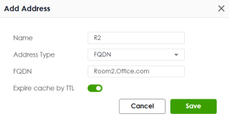

Object | Select an object you created. To create an object, click Add Object. ![]() • Name: Enter the name of this object. It must begin with a letter and cannot exceed 30 characters. The valid characters are A-Z, a-z, 0-9, underscores (_), dashes (-), and dots (.). Spaces are not allowed. • Address Type: Select the address type of the object you want to create from the drop-down list. • FQDN: Enter the FQDN of the of a web site. An FQDN starts with a host name and continues all the way up to the top-level domain name. For example, www.zyxel.com.tw is a fully qualified domain name, where “www” is the host, “zyxel” is the third-level domain, “com” is the second-level domain, and “tw” is the top level domain. Underscores are not allowed. Use "*" as a prefix in the FQDN for a wildcard domain name (for example, *.example.com). • Expire cache by TTL: Slide the switch to refresh the data in the cache when it expires based on the Time-to-Live (TTL). The cached data remains valid for the specified TTL duration before it is refreshed or discarded. • Cancel: Click Cancel to close the window with changes unsaved. • Save: Click Save to save the entry. |
