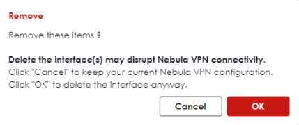

Remove | To remove a virtual interface, select it and click Remove. The Zyxel Device confirms you want to remove it before doing so. |

Remove | To remove a general interface, select it and click Remove. The Zyxel Device confirms you want to remove it before doing so. |

Remove | To remove a secondary IP address, select it and click Remove. The Zyxel Device confirms you want to remove it before doing so. |

Remove | To remove an interface from the bridge interface, select it and click Remove. The Zyxel Device confirms you want to remove it before doing so. |

Remove | Select an entry in this table and click this to delete it. |

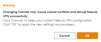

IP/Network Mask | This field is enabled if you select Use Fixed IP Address. Enter the IP address the subnet mask of this interface in dot decimal notation. The subnet mask indicates what part of the IP address is the same for all computers on the network.for this interface. |
IP/Netmask | Enter the secondary IP address and subnet mask to bind to this interface. |
