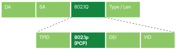

DA | Destination Address | TPID | Tag Protocol Identifier |
SA | Source Address | 802.1p (PCP) | 802.1p Priority |
802.1Q | 802.1Q Frame | DEI | Drop Eligible Indicator |
Type/ Len | Ethernet Type / Length | VID | VLAN ID |

802.1P Marking | Use 802.1P to prioritize outgoing traffic from a VLAN interface. Receiving devices will prioritize the traffic according to this tag. See 802.1p for details. |
Enable | Click to slide the switch to the right to enable 802.1P Marking. |
Priority Code | This is a 3-bit field within an 802.1Q VLAN tag that is used to prioritize associated outgoing VLAN traffic. "0" is the lowest priority level and "7" is the highest. The setting configured here overrides the existing priority settings on the VLAN interface. |
