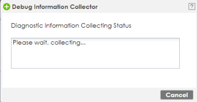

Diagnostics Collect Status | |
Status | This field displays the following states the Zyxel Device is in when collecting diagnostic data. • Standby: The Zyxel Device is ready to generate a diagnostic file or has just finished generating a diagnostic file. • Busy on AP: The Zyxel Device is generating a diagnostic file for the selected managed AP in Diagnostics > AP. • Busy on ZyWall: The Zyxel Device is generating a diagnostic file containing its own configuration and diagnostic information. |
General Setting | |
Filename | This is the name of the most recently created diagnostic file. |
Last modified | This is the date and time that the last diagnostic file was created. The format is yyyy-mm-dd hh:mm:ss. |
Size | This is the size of the most recently created diagnostic file. |
Copy the diagnostic file to USB storage (if ready) | Select this to have the Zyxel Device create an extra copy of the diagnostic file to a connected USB storage device. |
Diagnostic Collect by Script files | |
Script File | Select a script here to generate information about configuration and diagnostics of managed APs. See Scripts for more information on scripts. |
Upload Shell Script | |
File | Upload a script here to generate information about the Zyxel Device’s own configuration and diagnostics. Click Browse to find the location of the file you want to upload in this field. Click Upload to begin the upload process. This process may take a few minutes. |
Collect Now | Click this to have the Zyxel Device run the uploaded script and create a new diagnostic file. Wait while information is collected. ![]() |
