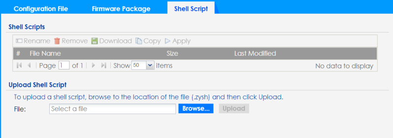

The Shell Script screen (Shell Script) stores, names, downloads, uploads and runs shell script files.

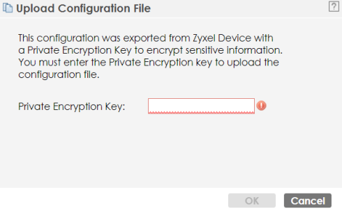

The Zyxel Device by default encrypts local admin and user account passwords for web configurator and CLI.
Enable Sensitive Data Protection to have the Zyxel Device use a private key to encrypt local admin and user account passwords for web configurator and CLI.
*You can only upload configuration files using FTP that are using the current private key of the Zyxel Device.

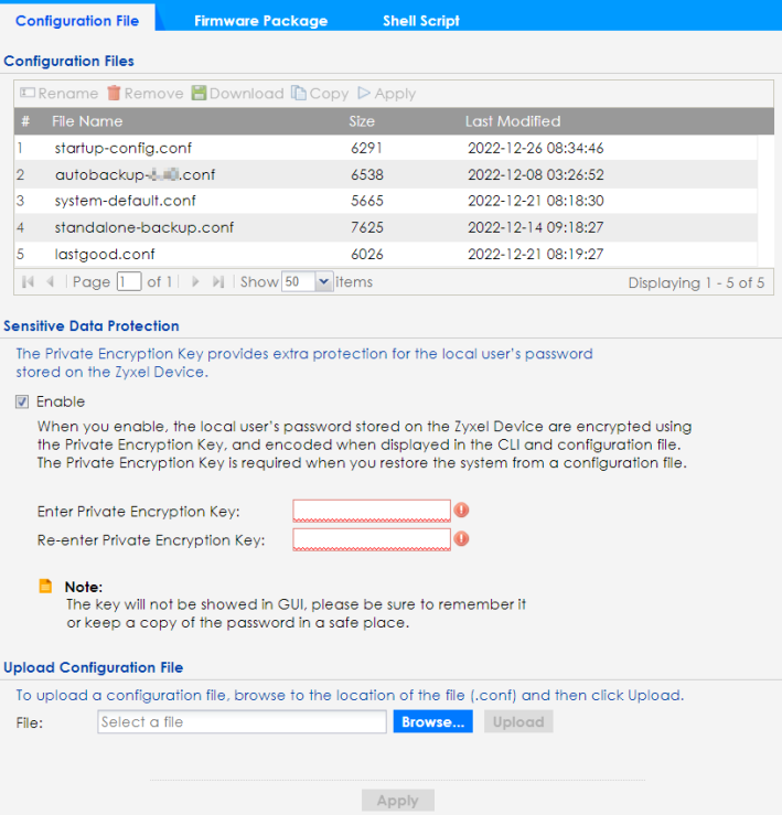

Configuration File
Click Maintenance > File Manager > Configuration File to open this screen. Use the Configuration File screen to store, run, and name configuration files. You can also download configuration files from the Zyxel Device to your computer and upload configuration files from your computer to the Zyxel Device.
Once your Zyxel Device is configured and functioning properly, it is highly recommended that you back up your configuration file before making further configuration changes. The backup configuration file will be useful in case you need to return to your previous settings.

Label
Description
Configuration Files

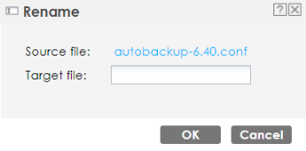

Rename
Use this button to change the label of a configuration file on the Zyxel Device. You can only rename manually saved configuration files. You cannot rename the lastgood.conf, system-default.conf and startup-config.conf files.
You cannot rename a configuration file to the name of another configuration file in the Zyxel Device.
Click a configuration file’s row to select it and click Rename to open the Rename File screen.
Specify the new name for the configuration file. Use up to 25 characters (including a-zA-Z0-9;‘~!@#$%^&()_+[]{}’,.=-).
Click OK to save the duplicate or click Cancel to close the screen without saving a duplicate of the configuration file.

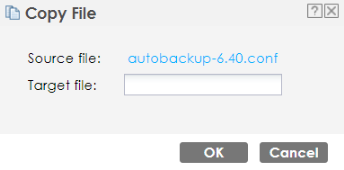

Copy
Use this button to save a duplicate of a configuration file on the Zyxel Device.
Click a configuration file’s row to select it and click Copy to open the Copy File screen.
Specify a name for the duplicate configuration file. Use up to 25 characters (including a-zA-Z0-9;‘~!@#$%^&()_+[]{}’,.=-).

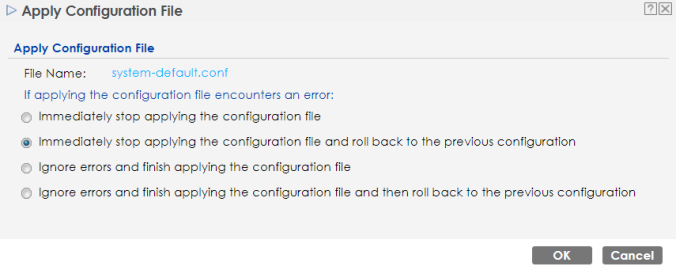

Apply
Use this button to have the Zyxel Device use a specific configuration file.
Click a configuration file’s row to select it and click Apply to have the Zyxel Device use that configuration file. The Zyxel Device does not have to restart in order to use a different configuration file, although you will need to wait for a few minutes while the system reconfigures.
The following screen gives you options for what the Zyxel Device is to do if it encounters an error in the configuration file.
Immediately stop applying the configuration file - this is not recommended because it would leave the rest of the configuration blank. If the interfaces were not configured before the first error, the console port may be the only way to access the Zyxel Device.
Immediately stop applying the configuration file and roll back to the previous configuration - this gets the Zyxel Device started with a fully valid configuration file as quickly as possible.
Ignore errors and finish applying the configuration file - this applies the valid parts of the configuration file and generates error logs for all of the configuration file’s errors. This lets the Zyxel Device apply most of your configuration and you can refer to the logs for what to fix.
Ignore errors and finish applying the configuration file and then roll back to the previous configuration - this applies the valid parts of the configuration file, generates error logs for all of the configuration file’s errors, and starts the Zyxel Device with a fully valid configuration file.
Click OK to have the Zyxel Device start applying the configuration file or click Cancel to close the screen.
This column displays the number for each configuration file entry. This field is a sequential value, and it is not associated with a specific address. The total number of configuration files that you can save depends on the sizes of the configuration files and the available flash storage space.
File Name
This column displays the label that identifies a configuration file.
You cannot delete the following configuration files or change their file names.
The system-default.conf file contains the Zyxel Device’s default settings. Select this file and click Apply to reset all of the Zyxel Device settings to the factory defaults. This configuration file is included when you upload a firmware package.
The startup-config.conf file is the configuration file that the Zyxel Device is currently using. If you make and save changes during your management session, the changes are applied to this configuration file. The Zyxel Device applies configuration changes made in the Web Configurator to the configuration file when you click Apply or OK. It applies configuration changes made through CLI commands when you use the write command.
The lastgood.conf is the most recently used (valid) configuration file that was saved when the Zyxel Device last restarted. If you upload and apply a configuration file with an error, you can apply lastgood.conf to return to a valid configuration.
Size
This column displays the size (in KB) of a configuration file.
Last Modified
This column displays the date and time that the individual configuration files were last changed or saved.
Enable
Select this to enable Sensitive Data Protection; see Overview for more information.
You need this key to upload configuration files. Write down the key you set and keep it in a safe place.
Upload Configuration File
Enter Private Encryption Key
Enter the encryption key in this field. The encryption key should be 4-8 single byte printable characters, including 0-9a-zA-Z`~!@#$%^&*()_-+={}|\;:'<,>./]|.
Re-enter Private Encryption Key
Enter the encryption key again in this field.

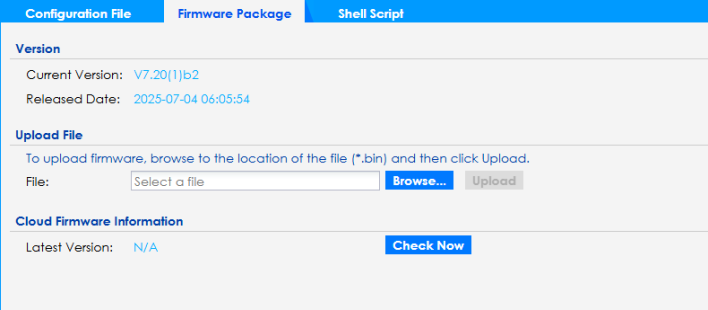

Click Maintenance > File Manager > Firmware Package to open this screen. Use the Firmware Package screen to check your current firmware version and upload firmware to the Zyxel Device.
*The Web Configurator is the recommended method for uploading firmware. You only need to use the command line interface if you need to recover the firmware. See the CLI Reference Guide for how to determine if you need to recover the firmware and how to recover it.

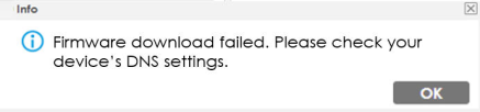

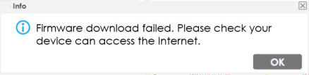

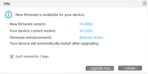

You can manually download the new firmware from the Zyxel website, or you can click Check Now to automatically find the latest firmware for your Zyxel Device (recommended).
The firmware update can take up to five minutes. Do not turn off or reset the Zyxel Device while the firmware update is in progress!

Current Version
This is the firmware version and the date created.
Released Date
This is the date that the version of the firmware was created.
File Path
Type in the location of the file you want to upload in this field or click Browse... to find it.
Browse...
Click Browse... to find the .bin file you want to upload. Remember that you must decompress compressed (.zip) files before you can upload them.
Upload
Click Upload to begin the upload process. This process may take up to two minutes.
Check now
Click Check now to view the firmware information. The following message appears when there is a new firmware version available for your Zyxel Device.
New firmware version
This is the new firmware version available for your Zyxel Device.
V6.60 is the firmware trunk version and the number in brackets is the release number. 0 is the first release of this version firmware. 1 is the next update release of this version firmware.
Your device current version
This is the current firmware version of your Zyxel Device.
Firmware enhancements
Click Release Notes to view the firmware release information of the new firmware, including new features, enhancements and bug fix.
Don’t remind for 7 days
Select this to stop receiving this notification for the next 7 days.
upgrade now
Click this to start upgrading your Zyxel Device to the new firmware version.
close
Click this to exit this screen without upgrading your Zyxel Device to the new firmware version.

Firmware download failed due to an Internet error. Refer to Internet Access for more information.
Firmware Download Failed. Check Internet Access.
Firmware download failed due to a DNS problem. Please check your device's DNS settings.
Firmware Download failed. Check DNS Settings.

Shell Script
Use shell script files to have the Zyxel Device use commands that you specify. Use a text editor to create the shell script files. They must use a “.zysh” filename extension.
Click Maintenance > File Manager > Shell Script to open this screen. Use the Shell Script screen to store, name, download, upload and run shell script files. You can store multiple shell script files on the Zyxel Device at the same time.
*You should include write commands in your scripts. If you do not use the write command, the changes will be lost when the Zyxel Device restarts. You could use multiple write commands in a long script.
Each field is described in the following table.
Label
Description
Shell Scripts
Rename
Use this button to change the label of a shell script file on the Zyxel Device.
You cannot rename a shell script to the name of another shell script in the Zyxel Device.
Click a shell script’s row to select it and click Rename to open the Rename File screen.
Specify the new name for the shell script file. Use up to 25 characters (including a-zA-Z0-9;‘~!@#$%^&()_+[]{}’,.=-).
Remove
Click a shell script file’s row to select it and click Delete to delete the shell script file from the Zyxel Device.
A pop-up window asks you to confirm that you want to delete the shell script file. Click OK to delete the shell script file or click Cancel to close the screen without deleting the shell script file.
Download
Click a shell script file’s row to select it and click Download to save the configuration to your computer.
Copy
Use this button to save a duplicate of a shell script file on the Zyxel Device.
Click a shell script file’s row to select it and click Copy to open the Copy File screen.
Specify a name for the duplicate file. Use up to 25 characters (including a-zA-Z0-9;‘~!@#$%^&()_+[]{}’,.=-).
Apply
Use this button to have the Zyxel Device use a specific shell script file.
Click a shell script file’s row to select it and click Apply to have the Zyxel Device use that shell script file. You may need to wait awhile for the Zyxel Device to finish applying the commands.
This column displays the number for each shell script file entry.
File Name
This column displays the label that identifies a shell script file.
Size
This column displays the size (in KB) of a shell script file.
Last Modified
This column displays the date and time that the individual shell script files were last changed or saved.
Upload Shell Script
The bottom part of the screen allows you to upload a new or previously saved shell script file from your computer to your Zyxel Device.
File
Browse...
Click Browse... to find the .zysh file you want to upload.
Upload
Click Upload to begin the upload process. This process may take up to several minutes.
