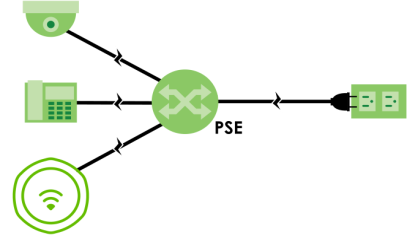

Power Over Ethernet (PoE) is a technology that allows Ethernet cables to supply power and transmit data simultaneously through a single Ethernet cable. You can use PoE when the Zyxel Device is hard to reach a power outlet or to simplify cabling.
The following example shows a Power Sourcing Equipment (PSE) supplying power and transmitting data to the Zyxel Device, along with other Powered Devices (PDs) such as an IP camera and an IP telephone.
PoE Example Application - PSE

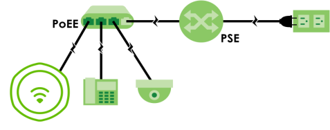

The following example shows a PSE using a PoE Extender (PoEE) to supply power and transmit data to the Zyxel Device, along with other PDs such as an IP camera and an IP telephone.
PoE Example Application - PSE with PoE Extender

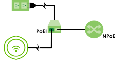

The following example shows the PoE Injector (PoEI) delivering power from the power outlet and transmitting data from the non-PoE (NPoE) device to the Zyxel Device.
PoE Example Application - PoE Injector

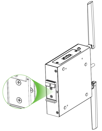

Attach the DIN-Rail Bracket to the Zyxel Device
1 Remove the two screws on the Zyxel Device and attach the DIN-Rail bracket to the Zyxel Device using the screws.
Attach the DIN-Rail bracket

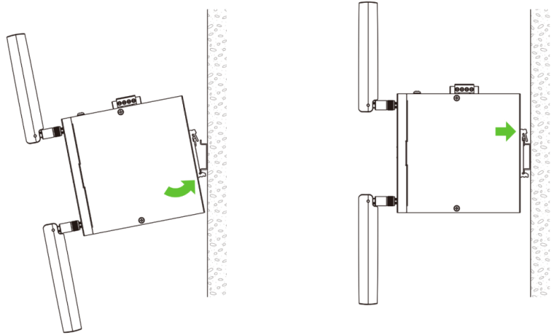

1 Place the lower bracket against a DIN-Rail.
2 Push the top of the Zyxel Device firmly but carefully to clip it in place.
Attach the Zyxel Device

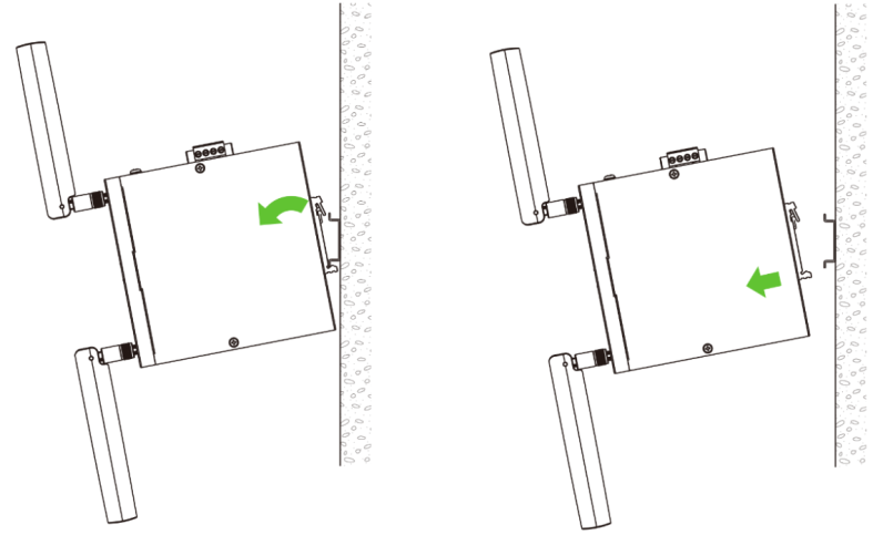

Remove the Zyxel Device from DIN-Rail
1 Carefully pull the Zyxel Device upward and backward to unclip it from a DIN-Rail.
2 Remove the Zyxel Device.
