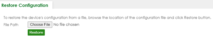

• Use the Restore Configuration screen (Restore Configuration) to upload a stored device configuration file.

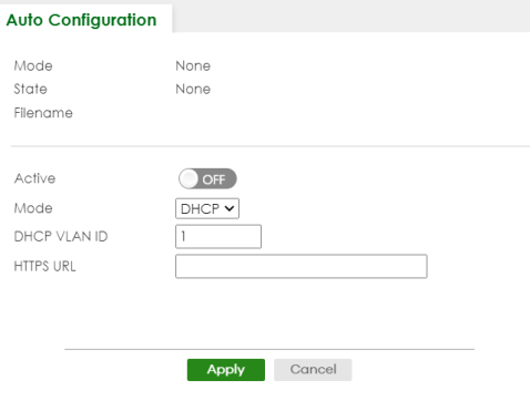

• Use the Auto Configuration screen (Auto Configuration) to overwrite the running configuration stored in the Switch’s RAM.

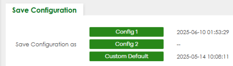

• Use the Save Configuration screen (Save Configuration) to save the current configuration settings to a specific configuration file on the Switch.

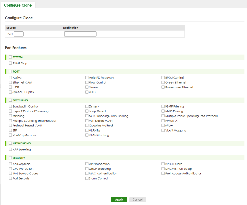

• Use the Configure Clone screen (Configure Clone) to copy the basic and advanced settings from a source port to a destination port or ports.

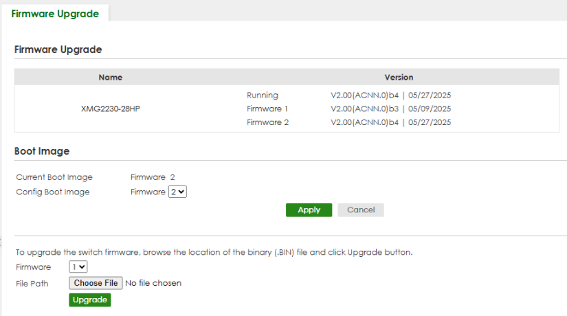

• Use the Firmware Upgrade screen (Firmware Upgrade) to upload the latest firmware.

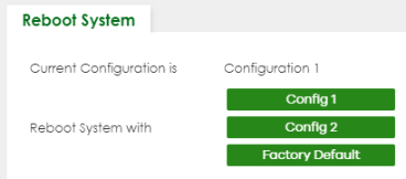

• Use the Reboot System screen (Reboot System) to restart the Switch without physically turning the power off and load a specific configuration file.

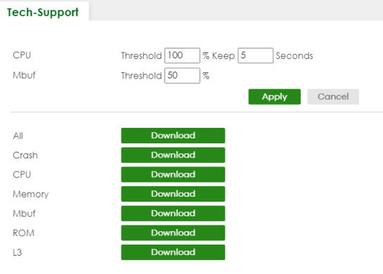

• Use the Tech-Support screen (Tech-Support) to create reports for customer support if there are problems with the Switch.

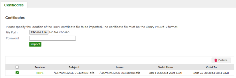

Certificates
The Switch can use HTTPS certificates that are verified by a third party to create secure HTTPS connections between your computer and the Switch. This way, you may securely access the Switch using the Web Configurator. See Section 65.7.2 on page 462 for more information about HTTPS.
Certificates are based on public-private key pairs. A certificate contains the certificate owner’s identity and public key. Certificates provide a way to exchange public keys for use in authentication.
Click MAINTENANCE > Certificates > Certificates to open the following screen. Use this screen to import the Switch's CA-signed certificates.
MAINTENANCE > Certificate > Certificates

File Path
Click Choose File or Browse to find the certificate file you want to upload.
Password
Enter the certificate file’s password that was created when the PKCS #12 file was exported. The password consists of up to 32 printable ASCII characters except [ ? ], [ | ], [ ' ], [ " ], or [ , ].
Import
Click this button to save the certificate that you have enrolled from a certification authority from your computer to the Switch.

Install Certificates
After buying the certificates from a trusted third-party Certificate Authorities (CA), (for example, DigiCert), install the certificates. See Importing a Certificate for more information.

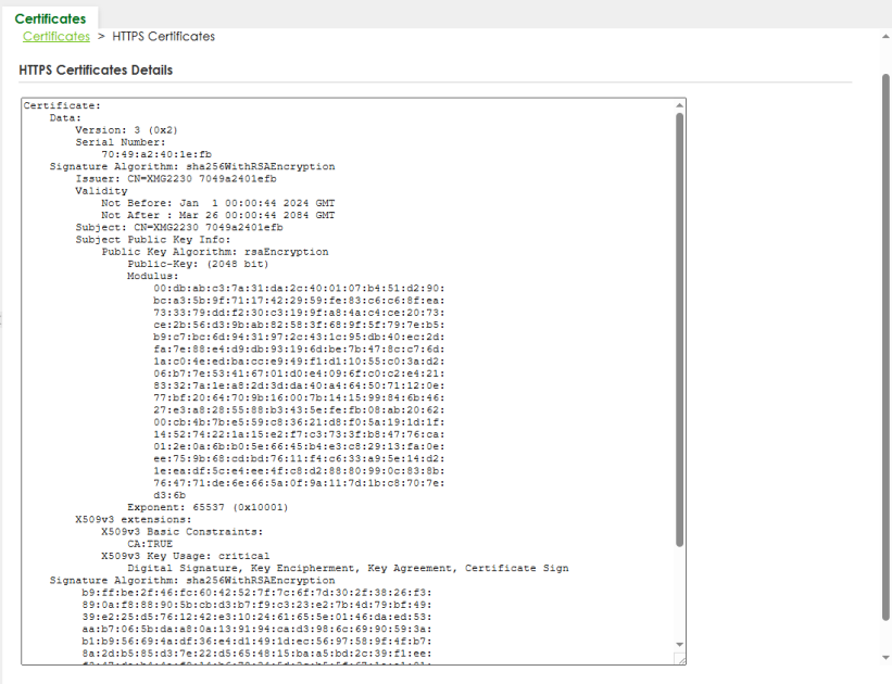

HTTPS Certificates
Use this screen to view the HTTPS certificate details. Click a hyperlink in the Service column in the MAINTENANCE > Certificates > Certificates screen to open the following screen.

You can store up to two images, or firmware files of the same device model, on the Switch. Only one image is used at a time.
• Run the boot image <1|2> command to specify which image is updated when firmware is loaded using the Web Configurator and to specify which image is loaded when the Switch starts up.
• You can also use FTP commands to upload firmware to any image.
The Switch supports dual firmware images, ras-0 and ras-1. You can switch from one to the other by using the boot image <index> command, where <index> is 1 (ras-0) or 2 (ras-1). See the CLI Reference Guide for more information about using commands. The system does not reboot after it switches from one image to the other.

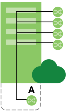

Cluster Management Overview
Cluster Management allows you to manage switches through one Switch, called the cluster manager. The switches must be directly connected and be in the same VLAN group so as to be able to communicate with one another.
Zyxel Clustering Management Specifications
Maximum number of cluster members
24
Cluster Member Models
Must be compatible with Zyxel cluster management implementation.
Cluster Manager
The Switch through which you manage the cluster member switches.
Cluster Members
The switches being managed by the cluster manager Switch.
In the following example, switch A in the basement is the cluster manager and the other switches on the upper floors of the building are cluster members.

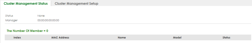

Cluster Management Status
Use this screen to view the role of the Switch within the cluster and to access a cluster member Switch’s Web Configurator.
Click MAINTENANCE > Cluster Management > Cluster Management Status in the navigation panel to display the following screen.
*A cluster can only have one manager.
label
Description
Status
This field displays the role of this Switch within the cluster.
Manager
Member (you see this if you access this screen in the cluster member Switch directly and not through the cluster manager)
None (neither a manager nor a member of a cluster)
Manager
This field displays the cluster manager Switch’s hardware MAC address.
The Number Of Member
This field displays the number of switches that make up this cluster. The following fields describe the cluster member switches.
Index
You can manage cluster member switches through the cluster manager Switch. Each number in the Index column is a hyperlink leading to the cluster member Switch’s Web Configurator.
MAC Address
This is the cluster member Switch’s hardware MAC address.
Name
This is the cluster member Switch’s System Name.
Model
This field displays the model name.
Status
This field displays:
Online (the cluster member Switch is accessible)
Error (for example the cluster member Switch password was changed or the Switch was set as the manager and so left the member list, and so on)
Offline (the Switch is disconnected – Offline shows approximately 1.5 minutes after the link between cluster member and manager goes down)

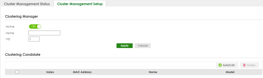

Clustering Management Setup
Use this screen to configure clustering management. Click MAINTENANCE > Cluster Management > Cluster Management Setup to display the next screen.
label
Description
Clustering Manager
The following fields relate to configuring the cluster manager.
Active
Enable the switch button to have this Switch become the cluster manager switch. A cluster can only have one manager. Other (directly connected) switches that are set to be cluster managers will not be visible in the Clustering Candidates list. If a Switch that was previously a cluster member is later set to become a cluster manager, then its Status is displayed as Error in the Cluster Management Status screen and a warning icon () appears in the member summary list below.
Name
Type a name to identify the Clustering Manager. You may use up to 32 printable ASCII characters except [ ? ], [ | ], [ ' ], [ " ], or [ , ]. (spaces are allowed).
VID
This is the VLAN ID and is only applicable if the Switch is set to 802.1Q VLAN. All switches must be directly connected and in the same VLAN group to belong to the same cluster. Switches that are not in the same VLAN group are not visible in the Clustering Candidates list. This field is ignored if the Clustering Manager is using Port-based VLAN.
Apply
Cancel
The next summary table shows the information for the clustering members configured.
Add/Edit
Click this button to create or configure a clustering candidate.
Delete
Click this button to remove the clustering candidate.
Select an entry’s checkbox to select a specific entry. Otherwise, select the checkbox in the table heading row to select all entries.
Index
This is the index number of a cluster member switch.
MAC Address
This is the cluster member switch’s hardware MAC address.
Name
This is the cluster member switch’s System Name.
Model
This is the cluster member switch’s model name.
Click the Add/Edit button to open the Add/Edit screen. Use this screen to configure a clustering candidate for the Switch.
MAINTENANCE > Cluster Management > Cluster Management Setup > Add/Edit

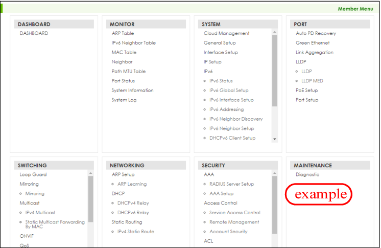

Cluster Member Switch Management
Go to the MAINTENANCE > Cluster Management > Clustering Management Status screen of the cluster manager switch and then select an Index hyperlink from the list of members to go to that cluster member switch's Web Configurator home page. This cluster member Web Configurator home page and the home page that you would see if you accessed it directly are different.
Cluster Management: Cluster Member Web Configurator Screen

User (192.168.0.1:(none)): admin
331 Enter PASS command
Password:
230 Logged in
ftp> ls
200 Port command okay
150 Opening data connection for LIST
--w--w--w- 1 owner group 3042210 Jul 01 12:00 ras
-rw-rw-rw- 1 owner group 393216 Jul 01 12:00 config
--w--w--w- 1 owner group 0 Jul 01 12:00 fw-00-a0-c5-01-23-46
-rw-rw-rw- 1 owner group 0 Jul 01 12:00 config-00-a0-c5-01-23-46
226 File sent OK
ftp: 297 bytes received in 0.00Seconds 297000.00Kbytes/sec.
ftp> bin
200 Type I OK
ftp> put 470ACAQ0.bin fw-00-a0-c5-01-23-46
150 Opening data connection for STOR fw-00-a0-c5-01-23-46
226 File received OK
ftp: 262144 bytes sent in 0.63Seconds 415.44Kbytes/sec.
ftp>
The following table explains some of the FTP parameters.
FTP Upload to Cluster Member Example
FTP Parameter
Description
User
Enter “admin”.
Password
The Web Configurator password default is on the back label of the Switch.
ls
Enter this command to list the name of cluster member switch’s firmware and configuration file.
470ACAQ0.bin
This is the name of the firmware file you want to upload to the cluster member switch.
This is the cluster member switch’s firmware name as seen in the cluster manager switch.
This is the cluster member switch’s configuration file name as seen in the cluster manager switch.
Use this screen to restore a previously saved configuration file (See Backup Configuration for more information on how to back up a configuration file) from your computer to the Switch.
Click MAINTENANCE > Configuration > Restore Configuration > Restore Configuration to access this screen.
1 Click Choose File or Browse to locate the configuration file you wish to restore.
2 After you have specified the file, click Restore.
The Switch will run on the restored configuration after the restore process.

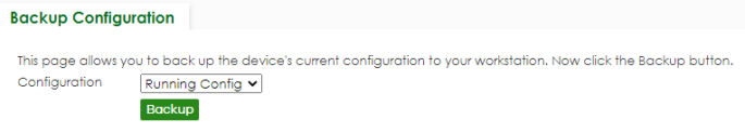

Backing up your Switch configurations allows you to create various “snap shots” of your device from which you may restore at a later date. Use this screen to back up your current Switch configuration to a computer.
To access this screen, click MAINTENANCE > Configuration > Backup Configuration > Backup Configuration in the navigation panel.
Follow the steps below to back up the current Switch configuration to your computer in this screen.
1 Select which Switch configuration file you want to download to your computer.
*Custom Default is only available in Standalone/Stacking mode.
2 Click Backup.
3 If the current configuration file is open and/or downloaded to your computer automatically, you can click File > Save As on your computer to save the file to a specific place.
If a dialog box pops up asking whether you want to open or save the file, click Save or Save File to download it to the default downloads folder on your computer. If a Save As screen displays after you click Save or Save File, choose a location to save the file on your computer from the Save in drop-down list box and type a descriptive name for it in the File name list box. Click Save to save the configuration file to your computer.
Auto Configuration
The Switch can download a pre-saved auto configuration file automatically when you reboot the Switch using the DHCP or HTTPS mode. This will overwrite the running configuration stored in the Switch’s RAM instead of the startup configuration stored in the Switch’s flash memory.
To access this screen, click MAINTENANCE > Configuration > Auto Configuration > Auto Configuration in the navigation panel.
label
description
Use this section to view the auto configuration status after you restarted the Switch.
Mode
This field shows the mode (DHCP or HTTPS) that is used for auto configuration after you enabled auto configuration and restarted the Switch.
It shows None if auto configuration was not enabled.
State
This field shows whether auto configuration was executed successfully the last time the Switch rebooted.
None – Auto configuration was disabled and not executed.
Success – An auto configuration file was downloaded successfully to the Switch.
Un-success – An auto configuration file was not downloaded to the Switch.
Filename
This field displays the name of the auto configuration file that was downloaded the last time the Switch rebooted.
It shows blank if auto configuration was not enabled or not executed successfully.
Use this section to enable auto configuration and select the mode that you want to use for auto configuration.
Active
Enable the switch button to enable auto configuration.
Mode
Select DHCP to have the Switch use the TFTP server IP address and auto configuration file name assigned by a DHCP server to download a pre-saved configuration file when the Switch reboots.
*The Switch should act as a DHCP client to send a DHCP request with DHCP option 60 so that it can get the TFTP server address and configuration file name from the DHCP server.
Select HTTPS to have the Switch use the URL you specified in the HTTPS URL field to access a web server and download the auto configuration file using HTTPS.
DHCP VLAN ID
Enter the VLAN ID of the DHCP server that assigns the TFTP server IP address and auto configuration file name to the Switch.
HTTPS URL
Enter the URL that can be used to access and download the auto configuration file from a web server using HTTPS. For example, https://webserverIPaddress/configfilename.cfg.
*You must fill in this field if you select HTTPS in the Mode field. Otherwise, auto configuration will not work.
Apply
Cancel

Save Configuration
To access this screen, click MAINTENANCE > Configuration > Save Configuration > Save Configuration in the navigation panel.
Click Config 1 to save the current configuration settings permanently to Configuration 1 on the Switch. These configurations are set up according to your network environment.
Click Config 2 to save the current configuration settings permanently to Configuration 2 on the Switch. These configurations are set up according to your network environment.
Click Custom Default to save the current configuration settings permanently to a customized default file on the Switch. If configuration changes cause the Switch to behave abnormally, click Custom Default (in the MAINTENANCE > Reboot System > Reboot System screen) to have the Switch automatically reboot and restore the saved Custom Default configuration file.
MAINTENANCE > Configuration > Save Configuration > Save Configuration (Standalone Mode)
*If a customized default file was not saved, clicking Custom Default in the MAINTENANCE > Reboot System > Reboot System screen loads the factory default configuration on the Switch.
Alternatively, click Save on the top right in any screen to save the configuration changes to the current configuration.
*Clicking the Apply button after making configuration does NOT save the changes permanently. All unsaved changes are erased after you reboot the Switch.
Configure Clone
Cloning allows you to copy the basic and advanced settings from a source port to a destination port or ports. Click MAINTENANCE > Configuration > Configure Clone > Configure Clone to open the following screen.
MAINTENANCE > Configuration > Configure Clone > Configure Clone (Standalone Mode)
label
Description
Configure Clone
Source/Destination
Port
Enter the source port under the Source label. This port’s attributes are copied.
Enter the destination port or ports under the Destination label. These are the ports which are going to have the same attributes as the source port. You can enter individual ports separated by a comma or a range of ports by using a dash.
Example:
2, 4, 6 indicates that ports 2, 4 and 6 are the destination ports.
2-6 indicates that ports 2 through 6 are the destination ports.
Port Features
Select a feature’s checkbox to select a specific feature. Otherwise, select the checkbox in the table heading row to select all features for a category.
SYSTEM
Select the system feature (you configured in the SYSTEM menus) to be copied to the destination ports. Otherwise, select the SYSTEM checkbox in the table heading row to select all features for a category.
PORT
Select which port features (you configured in the PORT menus) should be copied to the destination ports. Otherwise, select the PORT checkbox in the table heading row to select all features for a category.
SWITCHING
Select which switching features (you configured in the SWITCHING menus) should be copied to the destination ports. Otherwise, select the SWITCHING checkbox in the table heading row to select all features for a category.
NETWORKING
Select the networking feature (you configured in the NETWORKING menus) to be copied to the destination ports. Otherwise, select the NETWORKING checkbox in the table heading row to select all features for a category.
SECURITY
Select which security features (you configured in the SECURITY menus) should be copied to the destination ports. Otherwise, select the SECURITY checkbox in the table heading row to select all features for a category.
Apply
Cancel

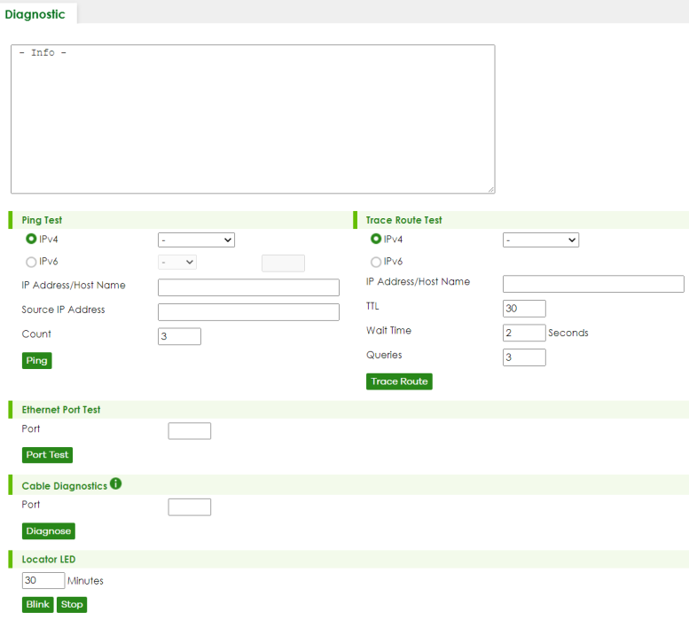

Diagnostic
Click MAINTENANCE > Diagnostic > Diagnostic in the navigation panel to open this screen. Use this screen to ping IP addresses, run a traceroute, perform port tests or show the Switch’s location between devices.
MAINTENANCE > Diagnostic > Diagnostic (Standalone Mode)
LABEL
DESCRIPTION
Ping Test
IPv4
Select this option if you want to ping an IPv4 address. Otherwise, select – to send ping requests to all VLANs on the Switch.
IPv6
Select this option if you want to ping an IPv6 address. You can also select vlan and specify the ID number of the VLAN to which the Switch is to send ping requests. Otherwise, select – to send ping requests to all VLANs on the Switch.
IP Address/Host Name
Type the IP address or host name of a device that you want to ping in order to test a connection.
Click Ping to have the Switch ping the IP address.
Source IP Address
Type the source IP address that you want to ping in order to test a connection.
Count
Enter the number of ICMP Echo Request (ping) messages the Switch continuously sends.
Trace Route Test
IPv4
Select this option if you want to trace the route packets taken to a device with an IPv4 address. Otherwise, select – to trace the path on any VLAN.
*The device to which you want to run a traceroute must belong to the VLAN you specify here.
IPv6
Select this option if you want to trace the route packets taken to a device with an IPv6 address.
Enter the IP address or host name of a device to which you want to perform a traceroute.
Click Trace Route to have the Switch perform the traceroute function. This determines the path a packet takes to the specified device.
TTL
Enter the Time To Live (TTL) value for the ICMP Echo Request packets. This is to set the maximum number of the hops (routers) a packet can travel through. Each router along the path will decrement the TTL value by one and forward the packets. When the TTL value becomes zero and the destination is not found, the router drops the packets and informs the sender.
Wait Time
Specify how many seconds the Switch waits for a response to a probe before running another traceroute.
Queries
Specify how many times the Switch performs the traceroute function.
Ethernet Port Test
Port
Enter a port number and click Port Test to perform an internal loopback test.
Cable Diagnostics
Port
Enter an Ethernet port number and click Diagnose to perform a physical wire-pair test of the Ethernet connections on the specified ports. The following fields display when you diagnose a port.
Locator LED
Enter a time interval (in minutes) and click Blink to show the actual location of the Switch between several devices in a rack.
The default time interval is 30 minutes.
Click Stop to have the Switch terminate the blinking locater LED.
Firmware Upgrade
You can upgrade the Switch’s firmware through Web Configurator or NCC.
Firmware Upgrade Through NCC
In cloud management mode, NCC will first check if the firmware on the Switch needs to be upgraded. If it does, the Switch will upgrade the firmware immediately. If the firmware does not need to be upgraded, but there is newer firmware available for the Switch, then it will be upgraded according to the firmware upgrade schedule for the Switch on the NCC.
On the NCC web portal, go to Site-wide > Configure > Firmware management > Firmware management to schedule the firmware upgrade time.
*While the Switch is rebooting, do NOT turn off the power.
Firmware Upgrade Through the Web Configurator
Use the following screen to upgrade your Switch to the latest firmware. The Switch supports dual firmware images, Firmware 1 and Firmware 2. Use this screen to specify which image is updated when firmware is uploaded using the Web Configurator and to specify which image is loaded when the Switch starts up.
*Make sure you have downloaded (and unzipped) the correct model firmware and version to your computer before uploading to the device.
Click MAINTENANCE > Firmware Upgrade > Firmware Upgrade to view the screen as shown next.
MAINTENANCE > Firmware Upgrade > Firmware Upgrade (Standalone Mode)
The top of the screen shows which firmware version is currently Running on the Switch. Click Choose File or Browse to locate the firmware file you wish to upload to the Switch in the File Path field. Click Upgrade to load the new firmware. The Switch does not apply the uploaded firmware immediately. Firmware upgrades are only applied after you reboot the Switch using the uploaded firmware.
Click the Config Boot Image drop-down list box to select the boot image (Firmware1 or Firmware2) you want the Switch to use when rebooting, click Apply. Restart the Switch (manually or using the MAINTENANCE > Reboot System > Reboot System screen) to apply the firmware image you selected.
After the process is complete, see the DASHBOARD screen to verify your current firmware version number.
label
description
Name
This is the name of the Switch that you are configuring.
Version
The Switch has 2 firmware sets, Firmware 1 and Firmware 2, residing in flash.
• Running shows the version number (and model code) and MM/DD/YYYY creation date of the firmware currently in use on the Switch (Firmware 1 or Firmware 2). The firmware information is also displayed at System Information in Basic Setting.
• Firmware 1 shows its version number (and model code) and MM/DD/YYYY creation date.
• Firmware 2 shows its version number (and model code) and MM/DD/YYYY creation date.
Boot Image
Current Boot Image
This displays which firmware is currently in use on the Switch (Firmware 1 or Firmware 2).
Config Boot Image
Select which firmware (Firmware 1 or Firmware 2) should load, click Apply and reboot the Switch to see changes, you will also see changes in the Current Boot Image field above as well.
Apply
Cancel
Firmware
Choose to upload the new firmware to (Firmware) 1 or (Firmware) 2.
File Path
Click Choose File or Browse to locate the firmware file you wish to upload to the Switch.
Upgrade
Click Upgrade to load the new firmware. Firmwares are only applied after a reboot. To reboot, go to MAINTENANCE > Reboot System > Reboot System and click Config 1, Config 2 or Factory Default (Config 1, Config 2, Factory Default, and Custom Default are the configuration files you want the Switch to use when it restarts).

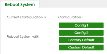

Reboot System
Reboot System allows you to restart the Switch without physically turning the power off. It also allows you to load configuration one (Config 1), configuration two (Config 2), a Custom Default or the Factory Default configuration when you reboot. Follow the steps below to reboot the Switch.
Click MAINTENANCE > Reboot System > Reboot System to view the screen as shown next.
MAINTENANCE > Reboot System > Reboot System (Standalone Mode)
MAINTENANCE > Reboot System > Reboot System (Cloud Mode)

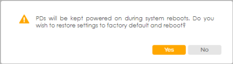

1 Click the Config 1, Config 2, Factory Default, or Custom Default button to reboot and load that configuration file. The confirmation screen displays.
Reboot Confirmation
2 Click YES and then wait for the Switch to restart. This takes up to 2 minutes.
Click Config 1 and follow steps 1 to 2 to reboot and load configuration one on the Switch.
Click Config 2 and follow steps 1 to 2 to reboot and load configuration two on the Switch.
Click Factory Default and follow steps 1 to 2 to reboot and load Zyxel factory default configuration settings on the Switch.
Click Custom Default and follow steps 1 to 2 to reboot and load a customized default file on the Switch. This will save the custom default configuration settings to both Configuration 1 and Configuration 2.
*If a customized default file was not saved, clicking Custom Default loads the factory default configuration on the Switch.

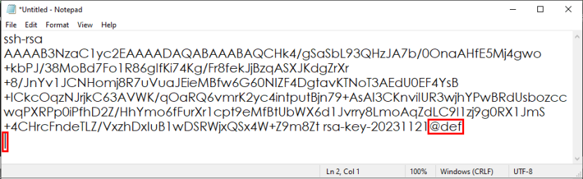

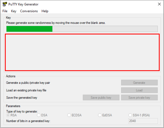

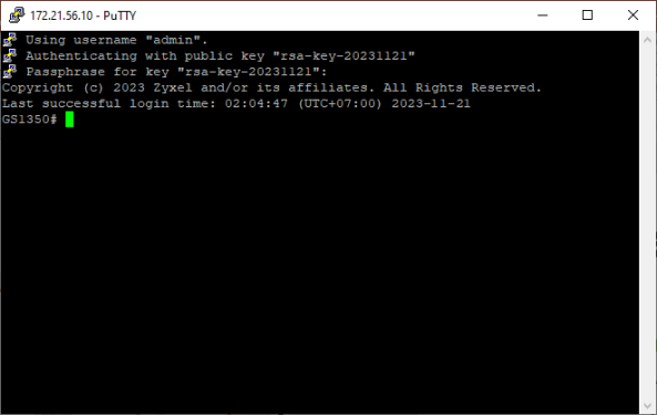

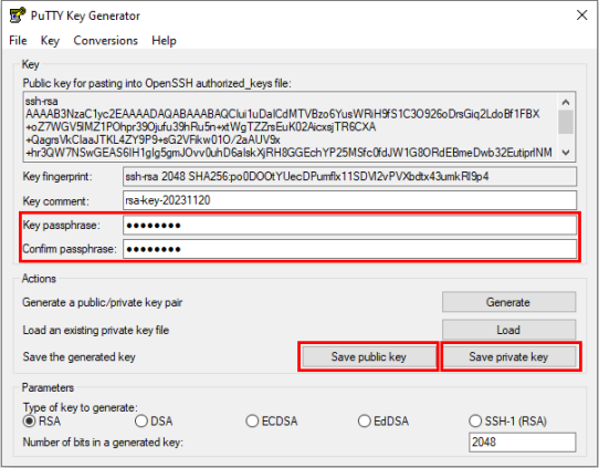

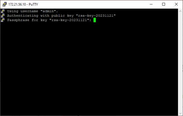

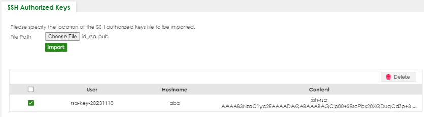

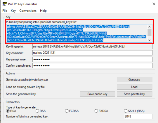

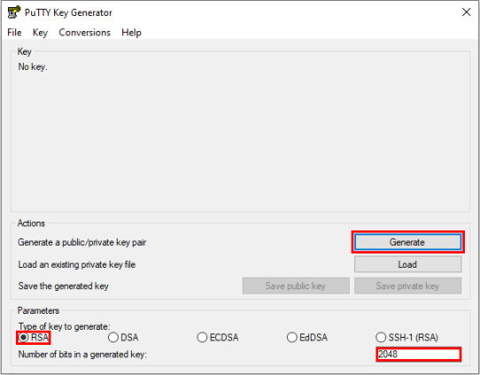

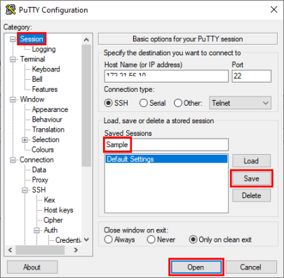

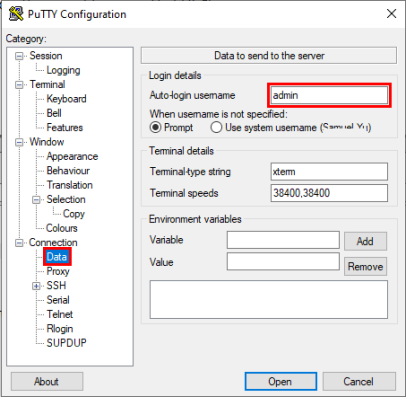

SSH Authorized Keys

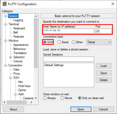

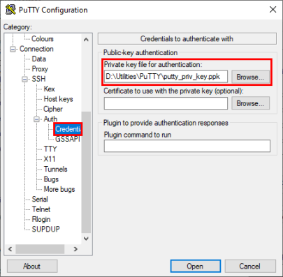

The Switch can use SSH-authorized keys to authenticate secure SSH connections between a client computer and the Switch (also called the server) without needing a password to connect to the Switch. You can use a third-party utility to generate a private and public key for SSH, for example:
• In Windows, use the PuTTY terminal emulator
• In Linux Ubuntu, use the “ssh-keygen” command.
The Switch and the client computer should have a unique set of private and public keys for encryption/decryption. See Section 65.7.1 on page 461 for more information about SSH.
Click MAINTENANCE > SSH Authorized Keys > SSH Authorized Keys to open the following screen. Use this screen to import the client computer’s public key into the Switch.
label
description
File Path
Click Choose File or Browse to find the authorized key file you want to upload.
Import
Click this button to save the authorized key file you want to import from your computer to the Switch.
Select an entry’s checkbox to select a specific key.
User
This field displays the user name of the authorized key file (up to 32 characters).
Hostname
This field displays the hostname of the authorized key file (up to 32 characters only).
Content
This field displays the actual encryption key’s text string (up to 64 characters).
Delete
After selecting an entry’s checkbox, click this button to delete the authorized key file.

1 Run PuTTYgen.
2 Select RSA in the Type of key to generate. RSA (Rivest-Shamir-Adleman) is an asymmetric encryption scheme that generates its keys by multiplying two pseudo-random prime numbers. Enter 2048 in the Number of bits in a generated key. SSH keys with encryption lower than 2048 are considered insecure. Then click Generate.
3 Move the mouse back and forth over the blank area to complete the key generation.
4 (Optional) The Key passphrase and Confirm passphrase fields allow you to set a passphrase for your key. Use the passphrase to encrypt the key on your computer. When set, you need to enter the passphrase to use the key. See step 5 on Run PuTTY for SSH Connections on Windows for more information.
5 Click Save public key and Save private key to save the generated keys in your computer.
6 Copy the text on the generated public key into a text editor app like Notepad.
7 At the end of the text string, enter “@(Hostname)”. This will appear in the Hostname field in the MAINTENANCE > SSH Authorized Keys > SSH Authorized Keys screen. Press Enter to add a line break, then save the text file. Import the text file into the Switch using the SSH Authorized Keys screen.
*The Switch only supports one SSH-authorized key at a time. Only one client computer can authenticate without entering a password using an SSH connection.
To use PuTTY to connect to the Switch through SSH, the following are the steps at the time of writing:
1 Run PuTTY. In the Session screen, enter the IP address of the Switch and “22” for the Port. Select SSH for the Connection type.
2 In the Data screen, enter admin for Auto-login username. The Switch only supports the admin login for the SSH-authorized key.
3 In the Credentials screen, click Browse to locate the generated private key.
4 In the Session screen, you can save the PuTTY configuration by entering a name (for example, “Sample”) in the Saved Sessions, then click Save. Click Open to start the SSH connection.
5 Enter the Passphrase for key if you configured the Key passphrase in step 4 of using the PuTTY Key Generator.

Tech-Support
The Tech-Support feature is a log enhancement tool that logs useful information such as CPU utilization history, memory and Mbuf (Memory Buffer) log and crash reports for issue analysis by customer support should you have difficulty with your Switch. The Tech Support menu eases your effort in obtaining reports and it is also available in CLI command by entering the “Show tech-support” command.
Click MAINTENANCE > Tech-Support > Tech-Support to see the following screen.
You may need WordPad or similar software to see the log report correctly. The table below describes the fields in the above screen.
Label
description
CPU
Type a number ranging from 50 to 100 in the CPU threshold box, and type another number ranging from 5 to 60 in the seconds box then click Apply.
For example, 80 for CPU threshold and 5 for seconds means a log will be created when CPU utilization reaches over 80% and lasts for 5 seconds.
The log report holds 7 days of CPU log data and is stored in volatile memory (RAM). The data is lost if the Switch is turned off or in event of power outage. After 7 days, the logs wrap around and new ones and replace the earliest ones.
The higher the CPU threshold number, the fewer logs will be created, and the less data technical support will have to analyze and vice versa.
Mbuf
Type a number ranging from 50 to 100 in the Mbuf (Memory Buffer) threshold box. The Mbuf log report is stored in flash (permanent) memory.
For example, Mbuf 50 means a log will be created when the Mbuf utilization is over 50%.
The higher the Mbuf threshold number, the fewer logs will be created, and the less data technical support will have to analyze and vice versa.
Apply
Cancel
All
Click Download to see all the log report and system status. This log report is stored in flash memory. If the All log report is too large, you can download the log reports separately below.
Crash
Click Download to see the crash log report. The log will include information of the last crash and is stored in flash memory.
CPU
Click Download to see the CPU history log report. The 7-days log is stored in RAM and you will need to save it, otherwise it will be lost when the Switch is shutdown or during power outage.
Memory
Click Download to see the memory section log report. This log report is stored in flash memory.
Mbuf
Click Download to see the Mbuf (Memory Buffer) log report. This log report is stored in flash memory.
ROM
Click Download to see the Read Only Memory (ROM) log report. This report is stored in flash memory.
L3
Click Download to see the layer-3 Switch log report. The log only applies to the layer-3 Switch models. This report is stored in flash memory.

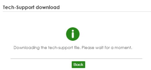

Tech-Support Download
When you click Download to save your current Switch configuration to a computer, the following screen appears. When the log report has downloaded successfully, click Back to return to the previous screen.
MAINTENANCE > Tech-Support > Tech-Support: Download
