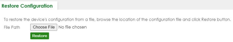

Restore Configuration
Use this screen to restore a previously saved configuration file from your computer to the Switch.
Click MAINTENANCE > Configuration > Restore Configuration > Restore Configuration to access this screen.
1 Click Choose File or Browse to locate the configuration file you wish to restore.
2 After you have specified the file, click Restore.
The Switch will run on the restored configuration after the restore process.

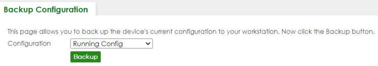

Backup Configuration
Backing up your Switch configurations allows you to create various “snap shots” of your device from which you may restore at a later date. Use this screen to back up your current Switch configuration to a computer.
To access this screen, click MAINTENANCE > Configuration > Backup Configuration > Backup Configuration in the navigation panel.
Follow the steps below to back up the current Switch configuration to your computer in this screen.
1 Select which Switch configuration file you want to download to your computer.
*Custom Default is only available in Standalone/Stacking mode.
2 Click Backup.
3 If the current configuration file is open and/or downloaded to your computer automatically, you can click File > Save As on your computer to save the file to a specific place.
If a dialog box pops up asking whether you want to open or save the file, click Save or Save File to download it to the default downloads folder on your computer. If a Save As screen displays after you click Save or Save File, choose a location to save the file on your computer from the Save in drop-down list box and type a descriptive name for it in the File name list box. Click Save to save the configuration file to your computer.

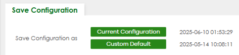

Save Configuration
To access this screen, click MAINTENANCE > Configuration > Save Configuration > Save Configuration in the navigation panel.
Click Current Configuration to save the current configuration settings permanently to the Switch. This configuration is set up according to your network environment.
Click Custom Default to save the current configuration settings permanently to a customized default file on the Switch.
Maintenance > Configuration > Save Configuration > Save Configuration
*If a customized default file was not saved, clicking Custom Default loads the factory default configuration on the Switch.
Alternatively, click Save on the top right in any screen to save the configuration changes to the current configuration.
*Clicking the Apply button after making configuration does NOT save the changes permanently. All unsaved changes are erased after you reboot the Switch.

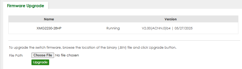

Firmware Upgrade
Use the following screen to upgrade your Switch to the latest firmware.
*Make sure you have downloaded (and unzipped) the correct model firmware and version to your computer before uploading to the device.
Click MAINTENANCE > Firmware Upgrade > Firmware Upgrade to view the screen as shown next.
Click Choose File or Browse to locate the firmware file you wish to upload to the Switch. Firmware upgrades are only applied after a reboot. Click Upgrade to load the new firmware.
After the firmware upgrade process is complete, see the MONITOR > System Information > System Information screen to verify your current firmware version number.
label
description
Name
This is the name of the Switch that you are configuring.
Version
This is the version number (and model code) and MM/DD/YYYY creation date of the firmware currently in use on the Switch. The firmware information is also displayed in MONITOR > System Information > System Information.
File Path
Upgrade
Click Upgrade to load the new firmware. Firmware upgrades are only applied after a reboot. To reboot, go to MAINTENANCE > Reboot System > Reboot System and click Current Configuration, Factory Default, or Custom Default (Current Configuration, Factory Default, and Custom Default are the configuration files you want the Switch to use when it restarts).

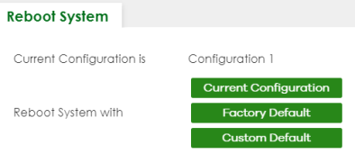

Reboot System
Reboot System allows you to restart the Switch without physically turning the power off. It also allows you to load the Current Configuration, a Custom Default or the Factory Default configuration when you reboot. Follow the steps below to reboot the Switch.
Click MAINTENANCE > Reboot System > Reboot System to view the screen as shown next.
1 Click the Current Configuration, Factory Default, or Custom Default button to reboot and load that configuration file. The confirmation screen displays.
Reboot Confirmation Example: Factory Default
2 Click YES and then wait for the Switch to restart. This takes up to 2 minutes.
Click Current Configuration and follow steps 1 to 2 to reboot and load configuration one on the Switch.
Click Factory Default and follow steps 1 to 2 to reboot and load Zyxel factory default configuration settings on the Switch.
Click Custom Default and follow steps 1 to 2 to reboot and load a customized default file on the Switch.

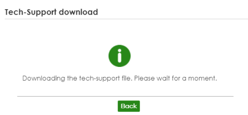

Tech-Support Download
When you click Download to save your current Switch configuration to a computer, the following screen appears. When the log report has downloaded successfully, click Back to return to the previous screen.
MAINTENANCE > Tech-Support > Tech-Support: Download
