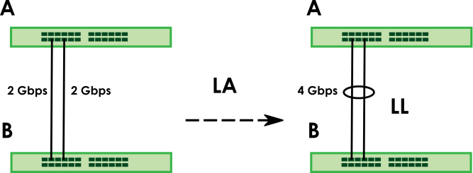

Link Aggregation
This section shows you how to logically aggregate physical links to form one logical, higher-bandwidth link.
Link aggregation (LA) (trunking) is the grouping of physical ports into one logical higher-capacity link (LL). You may want to trunk ports if for example, it is cheaper to use multiple lower-speed links than to under-utilize a high-speed, but more costly, single-port link. However, the more ports you aggregate then the fewer available ports you have. A trunk group is one logical link containing multiple ports.
The beginning port of each trunk group must be physically connected to form a trunk group.

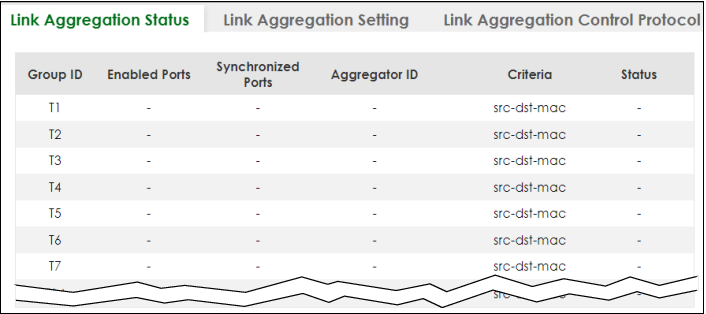

Link Aggregation Status
Use the Link Aggregation Status screen to view ports you have configured to be in the trunk group, ports that are currently transmitting data as one logical link in the trunk group and so on.
Click PORT > Link Aggregation > Link Aggregation Status in the navigation panel to display the screen as shown.
LABEL
DESCRIPTION
Group ID
This field displays the group ID to identify a trunk group, that is, one logical link containing multiple ports.
Enabled Ports
These are the ports you have configured in the Link Aggregation Setting screen to be in the trunk group.
The port numbers displays only when this trunk group is activated and there is a port belonging to this group.
Synchronized Ports
These are the ports that are currently transmitting data as one logical link in this trunk group.
Aggregator ID
Link Aggregator ID consists of the following: system priority, MAC address, key, port priority and port number.
The ID displays only when there is a port belonging to this trunk group and LACP is also enabled for this group.
Criteria
This shows the outgoing traffic distribution algorithm used in this trunk group. Packets from the same source and/or to the same destination are sent over the same link within the trunk.
src-mac means the Switch distributes traffic based on the packet’s source MAC address.
dst-mac means the Switch distributes traffic based on the packet’s destination MAC address.
src-dst-mac means the Switch distributes traffic based on a combination of the packet’s source and destination MAC addresses.
src-ip means the Switch distributes traffic based on the packet’s source IP address.
dst-ip means the Switch distributes traffic based on the packet’s destination IP address.
src-dst-ip means the Switch distributes traffic based on a combination of the packet’s source and destination IP addresses.
Status
This field displays how these ports were added to the trunk group. It displays:
• Static – if the ports are configured as static members of a trunk group.
• LACP – if the ports are configured to join a trunk group through LACP.

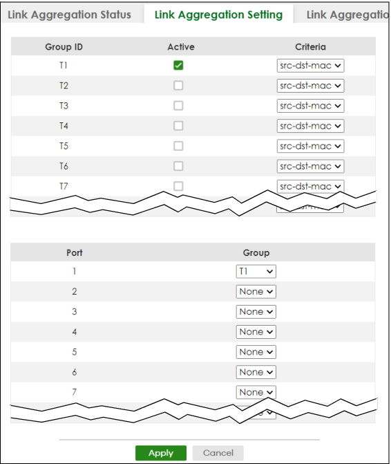

Use the Link Aggregation Setting screen to enable static link. Link aggregation (trunking) is the grouping of physical ports into one logical higher-capacity link. You may want to trunk ports if for example, it is cheaper to use multiple lower-speed links than to under-utilize a high-speed, but more costly, single-port link. However, the more ports you aggregate then the fewer available ports you have. A trunk group is one logical link containing multiple ports.
Click PORT > Link Aggregation > Link Aggregation Setting to display the screen shown next.
PORT> Link Aggregation > Link Aggregation Setting
LABEL
DESCRIPTION
This is the only screen you need to configure to enable static link aggregation.
Group ID
The field identifies the link aggregation group, that is, one logical link containing multiple ports.
Active
Select this to activate a trunk group.
Criteria
Select the outgoing traffic distribution type. Packets from the same source and/or to the same destination are sent over the same link within the trunk. By default, the Switch uses the src-dst-mac distribution type. If the Switch is behind a router, the packet’s destination or source MAC address will be changed. In this case, set the Switch to distribute traffic based on its IP address to make sure port trunking can work properly.
Select src-mac to distribute traffic based on the packet’s source MAC address.
Select dst-mac to distribute traffic based on the packet’s destination MAC address.
Select src-dst-mac to distribute traffic based on a combination of the packet’s source and destination MAC addresses.
Select src-ip to distribute traffic based on the packet’s source IP address.
Select dst-ip to distribute traffic based on the packet’s destination IP address.
Select src-dst-ip to distribute traffic based on a combination of the packet’s source and destination IP addresses.
Port
This field displays the port number.
Group
Select the trunk group to which a port belongs.
*When you enable the port security feature on the Switch and configure port security settings for a port, you cannot include the port in an active trunk group.
Apply
Cancel

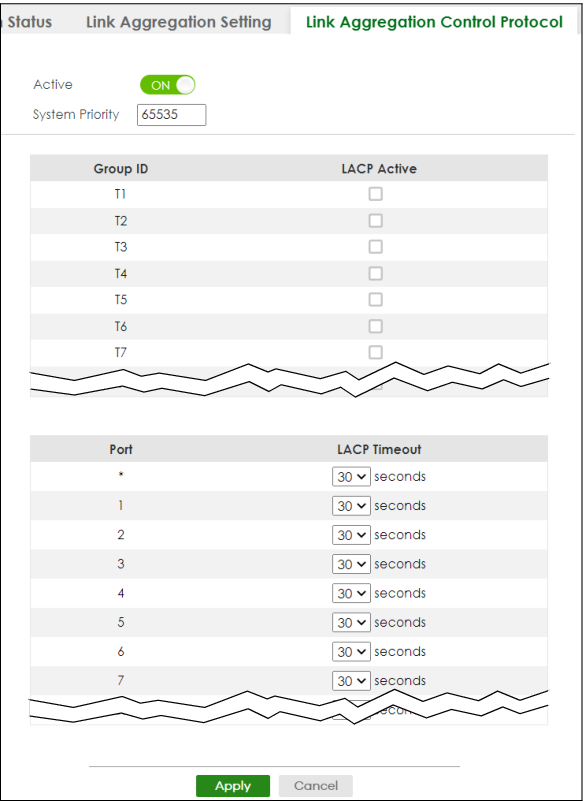

Link Aggregation Control Protocol
When you enable LACP link aggregation on a port, the port can automatically negotiate with the ports at the remote end of a link to establish trunk groups. LACP also allows port redundancy, that is, if an operational port fails, then one of the “standby” ports become operational without user intervention.
Click PORT > Link Aggregation > Link Aggregation Control Protocol to display the screen shown next.
*Do NOT configure this screen unless you want to enable dynamic link aggregation.
LABEL
DESCRIPTION
Active
Enable the switch button to enable Link Aggregation Control Protocol (LACP).
System Priority
LACP system priority is a number between 1 and 65535. The switch with the lowest system priority (and lowest port number if system priority is the same) becomes the LACP “server”. The LACP “server” controls the operation of LACP setup. Enter a number to set the priority of an active port using Link Aggregation Control Protocol (LACP). The smaller the number, the higher the priority level.
Use this section to enable LACP on trunks.
Group ID
LACP Active
Select this option to enable LACP for a trunk.
Use this section to configure LACP timeout on ports.
Port
Use this row only if you want to make some settings the same for all ports. Use this row first to set the common settings and then make adjustments on a port-by-port basis.
*Changes in this row are copied to all the ports as soon as you make them.
LACP Timeout
Timeout is the time interval between the individual port exchanges of LACP packets in order to check that the peer port in the trunk group is still up. If a port does not respond after three tries, then it is deemed to be “down” and is removed from the trunk. Set a short timeout (1 second) for busy trunked links to ensure that disabled ports are removed from the trunk group as soon as possible.
Select either 1 second or 30 seconds.
Apply
Cancel

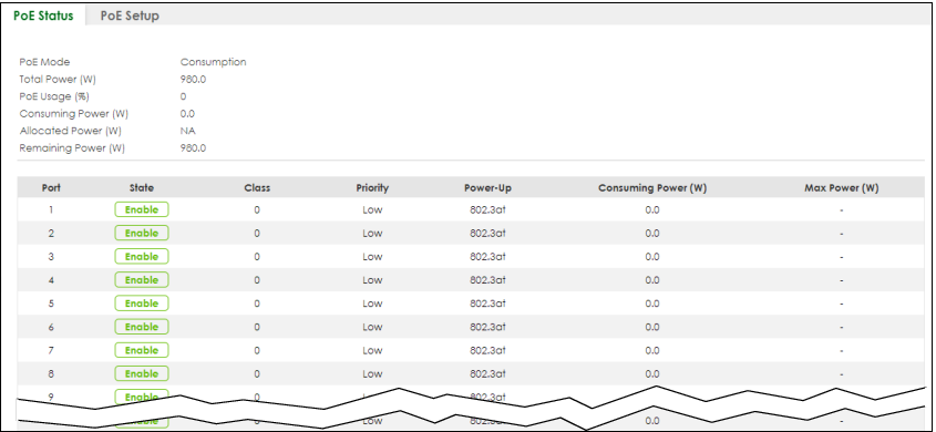

PoE Status
A powered device (PD) is a device such as an access point or a switch, that supports PoE (Power over Ethernet) so that it can receive power from another device through an Ethernet port.
You can also set priorities so that the Switch is able to reserve and allocate power to certain PDs.
*The PoE (Power over Ethernet) devices that supply or receive power and their connected Ethernet cables must all be completely indoors.
PoE Example Application
To view the current amount of power that PDs are receiving from the Switch, click PORT > PoE Setup > PoE Status.
label
description
PoE Mode
This field displays the power management mode used by the Switch, whether it is in Classification or Consumption mode.
Total Power (W)
This field displays the total power the Switch can provide to the connected PoE-enabled devices on the PoE ports.
PoE Usage (%)
This field displays the amount of power currently being supplied to connected PoE devices (PDs) as a percentage of the total PoE power the Switch can supply.
When PoE usage reaches 100%, the Switch will shut down PDs one-by-one according to the PD priority which you configured in PORT > PoE Setup > PoE Setup.
Consuming Power (W)
This field displays the amount of power the Switch is currently supplying to the connected PoE-enabled devices.
Allocated Power (W)
This field displays the total amount of power the Switch (in classification mode) has reserved for PoE after negotiating with the connected PoE devices. It shows NA when the Switch is in consumption mode.
Consuming Power (W) can be less than or equal but not more than the Allocated Power (W).
Remaining Power (W)
This field displays the amount of power the Switch can still provide for PoE.
*The Switch must have at least 16 W of remaining power in order to supply power to a PoE device, even if the PoE device needs less than 16 W.
Port
This is the port index number.
State
This field shows which ports can receive power from the Switch. You can set this in PoE Setup.
• Disable – The PD connected to this port cannot get power supply.
• Enable – The PD connected to this port can receive power.
Class
This shows the power classification of the PD. Each PD has a specified maximum power that fall under one of the classes.
The Class is a number from 0 to 6, where each value represents the range of power that the Switch provides to the PD.
Each class corresponds to a default maximum power that can be extended in Port > PoE Setup > PoE Setup to the following values.
• Class 0 – default: 0.44 W to 15.4 W.
• Class 1 – default: 0.44 W to 4 W.
• Class 2 – default: 0.44 W to 7 W.
• Class 3 – default: 0.44 W to 15.4 W.
• Class 4 – default: 0.44 W to 30 W.
• Class 5 – default: 0.45 W to 45 W.
• Class 6 – default: 0.45 W to 60 W.
• Class 7 – default: 0.468 W to 75 W.
• Class 8 – default: 0.468 W to 90 W.
Priority
When the total power requested by the PDs exceeds the total PoE power budget on the Switch, you can set the PD priority to allow the Switch to provide power to ports with higher priority first.
• Critical has the highest priority.
• High has the Switch assign power to the port after all critical priority ports are served.
• Low has the Switch assign power to the port after all critical and high priority ports are served.
Power-Up
This field displays the PoE setting the Switch uses to provide power on this port.
Consuming Power (W)
This field displays the current amount of power consumed by the PD from the Switch on this port.
Max Power (W)
This field displays the maximum amount of power the PD could use from the Switch on this port.

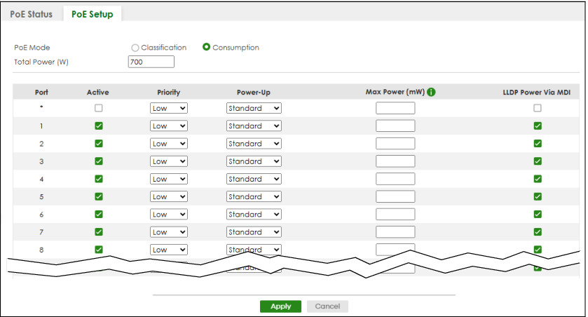

PoE Setup
Use this screen to set the PoE power management mode, priority levels, power-up mode and the maximum amount of power for the connected PDs.
Click PORT > PoE Setup > PoE Setup, the following screen opens.
label
description
PoE Mode
Select the power management mode you want the Switch to use.
• Classification – Select this if you want the Switch to reserve the maximum power for each PD according to the PD’s power class and priority level. If the total power supply runs out, PDs with lower priority do not get power to function. In this mode, the maximum power is reserved based on what you configure in Max Power or the standard power limit for each class.
• Consumption – Select this if you want the Switch to supply the actual power that the PD needs. The Switch also allocates power based on a port’s Max Power and the PD’s power class and priority level. The Switch puts a limit on the maximum amount of power the PD can request and use. In this mode, the default maximum power that can be delivered to the PD is 33 W (IEEE 802.3at Class 4) or 22 W (IEEE 802.3af Classes 0 to 3).
Total Power (W)
By default, this field displays the total power the Switch can provide to the connected PoE-enabled devices on the PoE ports
• XMG2230-28HP: 700 W (default). Enter a number ranging from 1 to 1440 W to set the maximum PoE power the PD(s) could use from this Switch.
• XMG2230-52HP: 960 W (default). Enter a number ranging from 1 to 2400 W to set the maximum PoE power the PD(s) could use from this Switch.
*This field is only for configuration when the Switch is powered up by DC power.
Port
Active
Select this to provide power to a PD connected to the port.
If left unchecked, the PD connected to the port cannot receive power from the Switch.
Priority
When the total power requested by the PDs exceeds the total PoE power budget on the Switch, you can set the PD priority to allow the Switch to provide power to ports with higher priority.
Select Critical to give the highest PD priority on the port.
Select High to set the Switch to assign the remaining power to the port after all critical priority ports are served.
Select Low to set the Switch to assign the remaining power to the port after all critical and high priority ports are served.
Power-Up
Set how the Switch provides power to a connected PD at power-up.
Standard – the Switch follows the IEEE 802.3 Power over Ethernet standard to supply power to the connected PDs during power-up.
Compatible – the Switch provides PD with power on the port without performing PoE classification. Select this if the connected PD does not comply with any PoE standard.
*When you change the Power-Up mode, you need to do any of the following:
• Click Reset on the Action field of the port supplying PoE power to the connected PD in PORT > PoE Setup > PoE Status, or
• Disconnect and reconnect the Ethernet cable supplying PoE power from the port to the connected PD.
Max Power (mW)
Specify the maximum amount of power the PD could use from the Switch on this port. If you leave this field blank, the Switch refers to the standard or default maximum power for each class.
LLDP Power Via MDI
Select this to have the Switch negotiate PoE power with the PD connected to the port by transmitting LLDP Power Via MDI TLV frames. This helps the Switch allocate less power to the PD on this port. The connected PD must be able to request PoE power through LLDP.
The Power Via MDI TLV allows PoE devices to advertise and discover the MDI power support capabilities of the sending port on the remote device.
• Port Class
• MDI Supported
• MDI Enabled

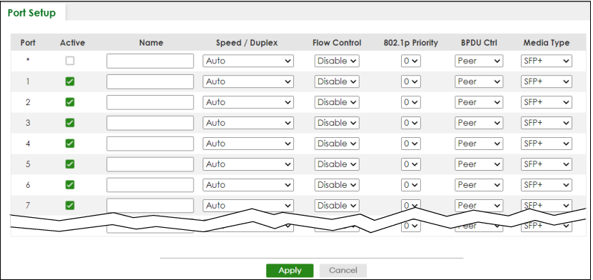

Port Setup
Use this screen to configure Switch port settings. Click PORT > Port Setup > Port Setup in the navigation panel to display the configuration screen.
label
description
Port
Active
Select this checkbox to enable a port. The factory default for all ports is enabled. A port must be enabled for data transmission to occur.
Name
Type a descriptive name that identifies this port. You can enter up to 128 printable ASCII characters except [ ? ], [ | ], [ ' ], or [ " ].
*Due to space limitations, the port name may be truncated in some Web Configurator screens.
Speed/Duplex
Select the speed and the duplex mode of the connection on this port.
For an Ethernet port, the choices are Auto, Auto-1G, 10-an (10M/auto-negotiation), 10M / Full Duplex, 100-an (100M/auto-negotiation), 2.5G / Full Duplex, 5G / Full Duplex, and 100M / Full Duplex for a 100Base-T connection. 1G / Full Duplex is supported by both 1000Base-T and 1000Base-X connections. 10G / Full Duplex is supported by the 10 Gigabit Ethernet connections on the Switch that has a 10 Gigabit interface.
For an SFP+ interface, the choices are Auto, Auto-1G, 1G / Full Duplex, and 10G / Full Duplex.
Selecting Auto-1G or Auto (auto-negotiation) allows one port to negotiate with a peer port automatically to obtain the connection speed and duplex mode that both ends support. When auto-negotiation is turned on, a port on the Switch negotiates with the peer automatically to determine the connection speed and duplex mode. If the peer port does not support auto-negotiation or turns off this feature, the Switch determines the connection speed by detecting the signal on the cable and using half duplex mode. When the Switch’s auto-negotiation is turned off, a port uses the pre-configured speed and duplex mode when making a connection, therefore requiring you to make sure that the settings of the peer port are the same in order to connect.
Flow Control
A concentration of traffic on a port decreases port bandwidth and overflows buffer memory causing packet discards and frame losses. Flow Control is used to regulate transmission of signals to match the bandwidth of the receiving port.
The Switch uses IEEE 802.3x flow control in full duplex mode.
IEEE 802.3x flow control is used in full duplex mode to send a pause signal to the sending port, causing it to temporarily stop sending signals when the receiving port memory buffers fill.
Select Tx Rx to allow the Switch port to send pause signal to the connected device, and for the connected device to send a pause signal to the Switch. The Switch will temporarily stop sending signals after receiving pause signal.
Select Tx to allow the Switch port to send pause signal to the connected device.
Select Rx to allow the connected device to send a pause signal to the Switch. The Switch will temporarily stop sending signals.
Otherwise, select Disable.
802.1p Priority
This priority value is added to incoming frames without a (802.1p) tag.
BPDU Ctrl
Configure the way to treat BPDUs received on this port. You must activate Bridging Control Protocol Transparency in the SYSTEM > Switch Setup screen first.
Select Peer to process any BPDU (Bridge Protocol Data Units) received on this port.
Select Tunnel to forward BPDUs received on this port.
Select Discard to drop any BPDU received on this port.
Select Network to process a BPDU with no VLAN tag and forward a tagged BPDU.
Media Type
You can insert either an SFP+ transceiver or an SFP+ Direct Attach Copper (DAC) cable into the 10 Gigabit interface of the Switch.
Select the media type (Auto / SFP+ / DAC10G) of the SFP+ module that is attached to the 10 Gigabit interface. The default setting is Auto. When Auto is selected, the Switch chooses SFP+ or DAC10G mode based on the DDMI information.
*Auto is only available for Zyxel transceivers and the Speed/Duplex field is set at Auto or 10G / Full Duplex.
Apply
Cancel
