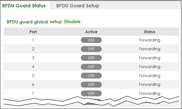

BPDU Guard Status
Use this screen to view whether BPDU guard is enabled on the Switch and the port status. Click SECURITY > BPDU Guard > BPDU Guard Status to view the following screen.
SECURITY > BPDU Guard > BPDU Guard Status (Standalone Mode)
The following table describes the fields in the above screen.
label
description
BPDU guard global setup
This field displays whether BPDU guard is activated on the Switch.
Port
This field displays the port number.
Active
This shows whether BPDU guard is activated on the port.
Status
This shows whether the port is shut down (Err-disable) or able to transmit packets (Forwarding).

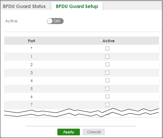

BPDU Guard Setup
Use this screen to turn on the BPDU guard feature on the Switch and ports.
Click SECURITY > BPDU Guard > BPDU Guard Setup to display the configuration screen as shown.
SECURITY > BPDU Guard > BPDU Guard Setup (Standalone Mode)
label
description
Active
Enable the switch button to enable BPDU guard on the Switch.
Port
Use this row only if you want to make some settings the same for all ports. Use this row first to set the common settings and then make adjustments on a port-by-port basis.
*Changes in this row are copied to all the ports as soon as you make them.
Active
Select this checkbox to enable the BPDU guard feature on this port. The Switch shuts down this port if there is any BPDU received on the port.
Clear this checkbox to disable the BPDU guard feature.
Apply
Cancel
