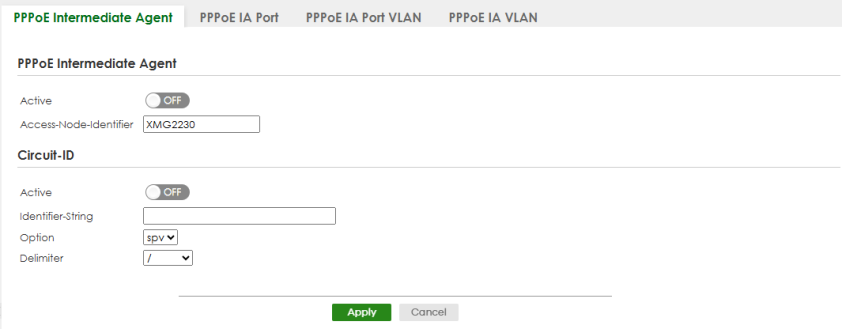

PPPoE Intermediate Agent
Use this screen to configure the Switch to give a PPPoE termination server additional subscriber information that the server can use to identify and authenticate a PPPoE client.
Click SWITCHING > PPPoE Intermediate Agent > PPPoE Intermediate Agent to display the screen as shown.
label
description
Active
Enable the switch button to enable the PPPoE intermediate agent globally on the Switch.
Access-Node-Identifier
Enter up to 20 ASCII printable characters (except [ ? ], [ | ], [ ' ], [ " ], or [ , ]) to identify the PPPoE intermediate agent. Hyphens (-) and spaces are also allowed. The default is the Switch’s host name.
Circuit-ID
Use this section to configure the Circuit ID field in the PADI and PADR packets.
The Circuit ID you configure for a specific port (in the SWITCHING > PPPoE Intermediate Agent > PPPoE IA Port screen) or for a specific VLAN on a port (in the SWITCHING > PPPoE Intermediate Agent > PPPoE IA Port VLAN screen) has priority over this. That means, if you also want to configure PPPoE IA Per-Port or Per-Port Per-VLAN setting, leave the fields here empty and configure circuit-id and remote-id in the Per-Port or Per-Port Per-VLAN screen.
Active
Enable the switch button to have the Switch add the user-defined identifier string and variables (specified in the Option field) to PADI or PADR packets from PPPoE clients.
If you leave this option unselected and do not configure any Circuit ID string (using CLI commands) on the Switch, the Switch will use the string specified in the Access-Node-Identifier field.
Identifier-String
Specify a string that the Switch adds in the Agent Circuit ID sub-option. You can enter up to 53 printable ASCII characters (except [ ? ], [ | ], [ ' ], [ " ], or [ , ]). Spaces are allowed.
Option
Select the variables that you want the Switch to generate and add in the Agent Circuit ID sub-option. The variable options include sp, sv, pv and spv which indicate combinations of slot-port, slot-VLAN, port-VLAN and slot-port-VLAN respectively. The Switch enters a zero into the PADI and PADR packets for the slot value.
Delimiter
Select a delimiter to separate the identifier-string, slot ID, port number and/or VLAN ID from each other. You can use a pound key (#), semi-colon (;), period (.), comma (,), forward slash (/) or space.
Apply
Cancel

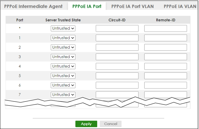

PPPoE IA Port
Use this screen to specify whether individual ports are trusted or untrusted ports and have the Switch add extra information to PPPoE discovery packets from PPPoE clients on a per-port basis.
*The Switch will drop all PPPoE packets if you enable the PPPoE Intermediate Agent on the Switch and there are no trusted ports.
Click the SWITCHING > PPPoE Intermediate Agent > PPPoE IA Port screen to display the screen as shown.
SWITCHING > PPPoE Intermediate Agent > PPPoE IA Port (Standalone Mode)
label
description
Port
This field displays the port number. * means all ports.
Use this row to make the setting the same for all ports. Use this row first and then make adjustments on a port-by-port basis.
Changes in this row are copied to all the ports as soon as you make them.
Server Trusted State
Select whether this port is a trusted port (Trusted) or an untrusted port (Untrusted).
Trusted ports are uplink ports connected to PPPoE servers.
If a PADO (PPPoE Active Discovery Offer), PADS (PPPoE Active Discovery Session-confirmation), or PADT (PPPoE Active Discovery Terminate) packet is sent from a PPPoE server and received on a trusted port, the Switch forwards it to all other ports.
If a PADI or PADR packet is sent from a PPPoE client but received on a trusted port, the Switch forwards it to other trusted ports.
Untrusted ports are downlink ports connected to subscribers.
If a PADI, PADR, or PADT packet is sent from a PPPoE client and received on an untrusted port, the Switch adds a vendor-specific tag to the packet and then forwards it to the trusted ports.
The Switch discards PADO and PADS packets which are sent from a PPPoE server but received on an untrusted port.
Circuit-ID
Enter a string of up to 63 ASCII characters (except [ ? ], [ | ], [ ' ], [ " ], or [ , ]) that the Switch adds into the Agent Circuit ID sub-option for PPPoE discovery packets received on this port. Spaces are allowed.
The Circuit ID you configure for a specific VLAN on a port (in the SWITCHING > PPPoE Intermediate Agent > PPPoE IA Port VLAN screen) has the highest priority.
Remote-ID
Enter a string of up to 63 ASCII characters (except [ ? ], [ | ], [ ' ], [ " ], or [ , ]) that the Switch adds into the Agent Remote ID sub-option for PPPoE discovery packets received on this port. Spaces are allowed.
If you do not specify a string here or in the Remote-ID field for a VLAN on a port, the Switch automatically uses the PPPoE client’s MAC address.
The Remote ID you configure for a specific VLAN on a port (in the SWITCHING > PPPoE Intermediate Agent > PPPoE IA Port VLAN screen) has the highest priority.
Apply
Cancel

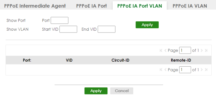

PPPoE IA Port VLAN
Use this screen to configure PPPoE IA settings that apply to a specific VLAN on a port.
Click SWITCHING > PPPoE Intermediate Agent > PPPoE IA Port VLAN to display the screen as shown.
SWITCHING > PPPoE Intermediate Agent > PPPoE IA Port VLAN (Standalone Mode)
label
description
Show Port
Port
Enter a port number to show the PPPoE Intermediate Agent settings for the specified VLANs on the port.
Show VLAN
Use this section to specify the VLANs you want to configure in the section below.
Start VID
Enter the lowest VLAN ID you want to configure in the section below.
End VID
Enter the highest VLAN ID you want to configure in the section below.
Apply
Click Apply to display the specified range of VLANs in the section below.
Port:
This field displays the port number specified above.
VID
This field displays the VLAN ID of each VLAN in the range specified above. If you configure the * VLAN, the settings are applied to all VLANs.
Use this row to make the setting the same for all VLANs. Use this row first and then make adjustments on a VLAN-by-VLAN basis.
Changes in this row are copied to all the VLANs as soon as you make them.
Circuit-ID
Enter a string of up to 63 ASCII characters (except [ ? ], [ | ], [ ' ], [ " ], or [ , ]) that the Switch adds into the Agent Circuit ID sub-option for this VLAN on the specified port. Spaces are allowed.
The Circuit ID you configure here has the highest priority.
Remote-ID
Enter a string of up to 63 ASCII characters (except [ ? ], [ | ], [ ' ], [ " ], or [ , ]) that the Switch adds into the Agent Remote ID sub-option for this VLAN on the specified port. Spaces are allowed.
If you do not specify a string here or in the Remote-ID field for a specific port, the Switch automatically uses the PPPoE client’s MAC address.
The Remote ID you configure here has the highest priority.
Apply
Cancel

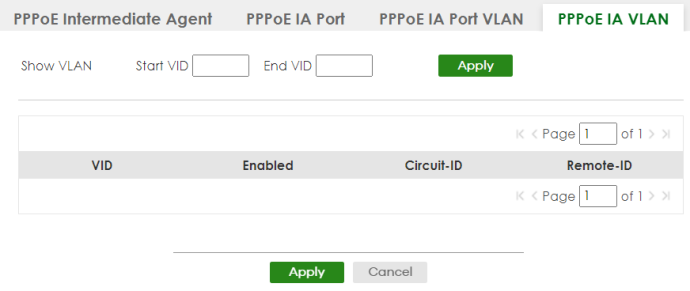

PPPoE IA VLAN
Use this screen to set whether the PPPoE Intermediate Agent is enabled on a VLAN and whether the Switch appends the Circuit ID and/or Remote ID to PPPoE discovery packets from a specific VLAN.
Click SWITCHING > PPPoE Intermediate Agent > PPPoE IA VLAN to display the screen as shown.
label
description
Show VLAN
Start VID
End VID
Apply
VID
Enabled
Select this option to turn on the PPPoE Intermediate Agent on a VLAN.
Circuit-ID
Select this option to make the Circuit ID settings for a specific VLAN take effect.
Remote-ID
Select this option to make the Remote ID settings for a specific VLAN take effect.
Apply
Cancel
