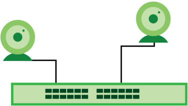

Auto PD Recovery Application
The PD may stop responding to the Switch’s detection over ping or LLDP during firmware upgrade. Disable the Auto PD Recovery function to prevent damage to the PD caused by a power cutoff during firmware upgrade.

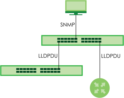

LLDP Overview
The LLDP (Link Layer Discovery Protocol) is a layer 2 protocol. It allows a network device to advertise its identity and capabilities on the local network. It also allows the device to maintain and store information from adjacent devices which are directly connected to the network device. This helps an administrator discover network changes and perform necessary network reconfiguration and management. The device information is encapsulated in the LLDPDUs (LLDP data units) in the form of TLV (Type, Length, Value). Device information carried in the received LLDPDUs is stored in the standard MIB.
The Switch supports these basic management TLVs.
End of LLDPDU (mandatory)
Chassis ID (mandatory)
Port ID (mandatory)
Time to Live (mandatory)
Port Description (optional)
System Name (optional)
System Description (optional)
System Capabilities (optional)
Management Address (optional)
The Switch also supports the IEEE 802.1 and IEEE 802.3 organizationally-specific TLVs.
IEEE 802.1 specific TLVs:
Port VLAN ID TLV (optional)
Port and Protocol VLAN ID TLV (optional)
IEEE 802.3 specific TLVs:
MAC/PHY Configuration/Status TLV (optional)
Power via MDI TLV (optional, For PoE models only)
Link Aggregation TLV (optional)
Maximum Frame Size TLV (optional)
The optional TLVs are inserted between the Time To Live TLV and the End of LLDPDU TLV.

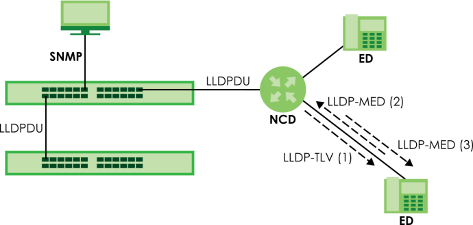

LLDP-MED Overview
LLDP-MED (Link Layer Discovery Protocol for Media Endpoint Devices) is an extension to the standard LLDP developed by the Telecommunications Industry Association (TIA) TR-41.4 subcommittee which defines the enhanced discovery capabilities, such as VoIP applications, to enable network administrators manage their network topology application more efficiently. Unlike the traditional LLDP, which has some limitations when handling multiple application devices, the LLDP-MED offers display of accurate physical topology, interoperability of devices, and easy trouble shooting for mis-configured IP addresses. There are three classes of endpoint devices that the LLDP-MED supports:
Class I: IP Communications Controllers or other communication related servers
Class II: Voice Gateways, Conference Bridges or Media Servers
Class III: IP-Phones, PC-based Softphones, End user Communication Appliances supporting IP Media

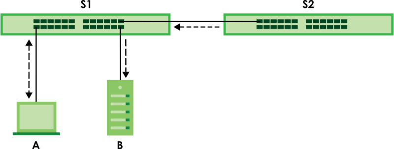

The following figure shows that with the LLDP-MED, network connectivity devices (NCD) like Switches and Routers will transmit LLDP TLV to endpoint device (ED) like IP Phone first (1), to get its device type and capabilities information, then it will receive that information in LLDP-MED TLV back from endpoint devices (2), after that the network connectivity devices will transmit LLDP-MED TLV (3) to provision the endpoint device to such that the endpoint device’s network policy and location identification information is updated. Since LLDPDU updates status and configuration information periodically, network managers may check the result of provision through remote status. The remote status is updated by receiving LLDP-MED TLVs from endpoint devices.
LLDP-MED Overview

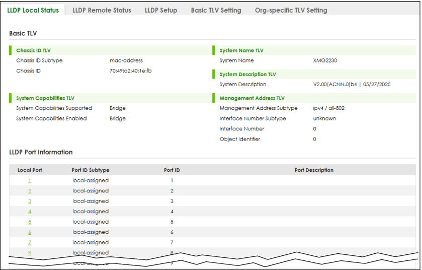

LLDP Local Status
This screen displays a summary of LLDP status on this Switch.
PORT > LLDP > LLDP > LLDP Local Status (Standalone Mode)
label
description
Basic TLV
Chassis ID TLV
This displays the chassis ID of the local Switch, that is the Switch you are configuring. The chassis ID is identified by the chassis ID subtype.
Chassis ID Subtype – This displays how the chassis of the Switch is identified.
Chassis ID – This displays the chassis ID of the local Switch.
System Name TLV
System Name – This shows the host name of the Switch.
System Description TLV
System Description – This shows the firmware version of the Switch.
System Capabilities TLV
This shows the System Capabilities enabled and supported on the local Switch.
System Capabilities Supported – Bridge
System Capabilities Enabled – Bridge
Management Address TLV
The Management Address TLV identifies an address associated with the local LLDP agent that may be used to reach higher layer entities to assist discovery by network management. The TLV may also include the system interface number and an object identifier (OID) that are associated with this management address.
This field displays the Management Address settings on the specified ports.
Management Address Subtype – ipv4 or all-802
Interface Number Subtype – unknown
Interface Number – 0 (not supported)
Object Identifier – 0 (not supported)
LLDP Port Information
This displays the local port information.
Local Port
This displays the number of the Switch port which receives the LLDPDU from the remote device. Click a port number to view the detailed LLDP status on this port in the LLDP Local Port Status Details screen.
Port ID Subtype
This indicates how the port ID field is identified.
Port ID
This is an alpha-numeric string that contains the specific identifier for the port from which this LLDPDU was transmitted.
Port Description
This shows the port description that the Switch will advertise from this port.

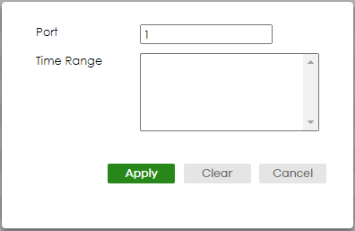

Add/Edit LLDP-MED Network Policy
To access this screen, click the Add/Edit button or select an entry from the list and click the Add/Edit button.
PORT > LLDP > LLDP MED > LLDP-MED Network Policy > Add/Edit
label
description
Port
Enter the port number to set up the LLDP-MED network policy. You can enter multiple ports separated by (no space) comma (“,”) or hyphen (“-”) for a range. For example, enter “3-5” for ports 3, 4, and 5. Enter “3,5,7” for ports 3, 5, and 7.
Application Type
Select the type of application used in the network policy.
voice
voice-signaling
guest-voice
guest-voice-signaling
softphone-voice
video-conferencing
streaming-video
video-signaling
Tag
Select to tag or untag in the network policy.
tagged
untagged
VLAN
Enter the VLAN ID number. It should be from 1 to 4094. For priority tagged frames, enter “0”.
DSCP
Enter the DSCP value of the network policy. The value is defined from 0 through 63 with the 0 representing use of the default DSCP value.
Priority
Enter the priority value for the network policy.
Apply
Clear
Click Clear to clear the fields to the factory defaults.
Cancel
Click Cancel to not save the configuration you make and return to the last screen.

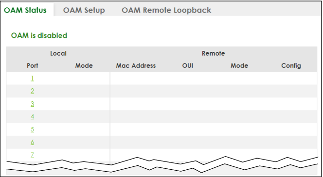

OAM Status
Use this screen to view the configuration of ports on which Ethernet OAM is enabled.
PORT > OAM > OAM Status (Standalone Mode)
The following table describes the fields in the above screen.
label
description
Local
This section displays information about the ports on the Switch.
Port
This field displays the port number.
Mode
This field displays the operational state of the port when OAM is enabled on the port.
Active – Allows the port to issue and respond to Ethernet OAM commands.
Passive – Allows the port to respond to Ethernet OAM commands.
Remote
This section displays information about the remote device.
Mac Address
This field displays the MAC address of the remote device.
OUI
This field displays the OUI (first 3 bytes of the MAC address) of the remote device.
Mode
Config
This field displays the capabilities of the Switch and remote device.

OAM Setup
Use this screen to turn on Ethernet OAM on the Switch and ports and configure the related settings.
PORT > OAM > OAM Setup
label
description
Active
Enable the switch button to enable Ethernet OAM on the Switch.
Port
Use this row only if you want to make some settings the same for all ports. Use this row first to set the common settings and then make adjustments on a port-by-port basis.
*Changes in this row are copied to all the ports as soon as you make them.
Active
Select this checkbox to enable Ethernet OAM on this port.
Clear this checkbox to disable Ethernet OAM on the port.
Mode
Specify the OAM mode on the port.
Select Active to allow the port to issue and respond to Ethernet OAM commands.
Select Passive to allow the port to respond to Ethernet OAM commands.
Remote Loopback Supported
Select this checkbox to enable the remote loopback feature on the port. Otherwise, clear the checkbox to disable it.
Remote Loopback Ignore-Rx
Select this checkbox to set the Switch to process loopback commands received on the port. Otherwise, clear the checkbox to have the Switch ignore loopback commands received on the port.
Apply
Cancel

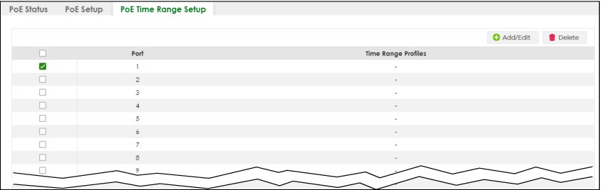

PoE Time Range Setup
Use this screen to apply a schedule to the ports on the Switch. You must first configure a schedule in the SYSTEM > Time Range > Time Range screen.
PORT > PoE Setup > PoE Time Range Setup (Standalone Mode)
label
description
Port
This field displays the index number of the port. Click a port number to change the schedule settings.
Time Range Profiles
This field displays the name of the schedule which is applied to the port.
PoE is enabled at the specified time or date.
Select an entry’s checkbox to select a specific entry. Otherwise, select the checkbox in the table heading row to select all entries.
Add/Edit
Click Add/Edit to add a new rule or edit a selected one.
Delete
Check the rules that you want to remove and then click the Delete button.
Add/Edit PoE Time Range
PORT > PoE Setup > PoE Time Range Setup > Add/Edit (Standalone Mode)
label
description
Port
Enter the number of the port to which you want to apply a schedule.
Time Range
This field displays the name of the schedule that you have created using the SYSTEM > Time Range > Time Range screen.
Select a pre-defined schedule to control when the Switch enables PoE to provide power on the port. To select more than one schedule, press [SHIFT] and select the choices at the same time.
Apply
Clear
Cancel

ZULD Overview
A unidirectional link is a connection where the link is up on both ends, but only one end can receive packets. This may happen if OAM was initially enabled but then disabled, there are mis-configured transmitting or receiving lines or the hardware is malfunctioning. Zyxel Unidirectional Link Detection (ZULD) is a layer-2 protocol that can detect and disable these physical one-way links before they cause loops or communication malfunction.
In the figure below, S1A is a bidirectional link as both ends can send packets to each other. S1B is unidirectional as B cannot send packets to S1 (although the S1B link is up). Similarly, S2S1 is unidirectional as S1 cannot send packets to S2 (although the S1S2 link is up).
ZULD Overview
What You Need to Know
ZULD must be enabled on the Switch and the ports in order to detect unidirectional links by monitoring OAMPDUs.
Ports advertise their unidirectional link detection capability using OAMPDUs, so all connected devices must support OAM as well as ZULD. You need to enable OAM on the Switch by going to PORT > OAM > OAM Setup and enable the switch in the Active field. OAM must be enabled on other connected devices too. If OAM is not enabled initially, ZULD will not work.
If OAM is enabled initially and later disabled on one end of a link, the link will be unidirectional as that end cannot send OAMPDUs.
OAM discovery, the sending of OAMPDUs to other ports, is initiated by an active port.
When ZULD detects a unidirectional link, it sends a syslog and SNMP trap and may shut down the affected port (Aggressive Mode).
If a port on the Switch is shut down by ZULD, and you want to recover it, then do one of the following:
Go to PORT > Port Setup > Port Setup. Clear Active and click Apply. Then select Active and click Apply again.
Go to SECURITY > Errdisable > Errdisable Recovery and set the interval for ZULD. After the interval expires, the closed ports will become active and start receiving packets again.
Use the command port no inactive.
Refer to the ZULD logs to see when a unidirectional link is detected and when it is recovered to a bidirectional link.
ZULD Status
Use this screen to see details of unidirectional and bidirectional links discovered by ZULD.
PORT > ZULD > ZULD Status
label
description
ZULD is....
This shows whether ZULD is enabled or disabled on the Switch.
Port
Active
This field displays whether ZULD is enabled on the port or not. ZULD must be enabled to detect an unidirectional link by monitoring OAMPDUs.
Mode
This field indicates what ZULD will do when a unidirectional link is detected. In Normal mode, ZULD only sends a syslog and trap when it detects a unidirectional link. In Aggressive mode, ZULD shuts down the port (puts it into an ErrDisable state) as well as sends a syslog and trap when it detects a unidirectional link.
Probe Time
Probe time is the length of time that ZULD waits before declaring that a link is unidirectional. When the probe time expires, and one port (either on the Switch or the connected device) still has not received an OAMPDU, then ZULD declares that the link is unidirectional.
Link State
This field shows the following link states:
Linkdown: This is an initialization state, where the port is not yet up.
Probe: This indicates that ZULD is discovering the connected device on this link.
Bidirectional: Traffic sent by the Switch is received by the connected device on this link, and traffic from the connected device on this link is received by the Switch.
Unidirectional: The state of the link between the port and its connected port cannot be determined either because no ZULD message was received, or one port is not capable of sending traffic.
Shutdown: The port has been shut down because its link with the connected device is unidirectional and ZULD is in Aggressive mode.
Remote Operation
This field displays whether ZULD is enabled or disabled on the connected device on this link. ZULD must be enabled on the connected device and on the port that is connecting to the Switch.
Remote MAC Addr
This is the MAC address of the port on the connected device to which the port of the Switch is connected.
Remote Port
This is the port number of the port on the connected device to which the port of the Switch is connected.
