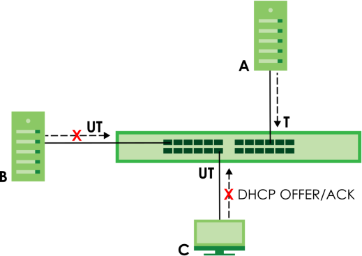

DHCP Snooping Overview
DHCP snooping filters unauthorized DHCP server packets. The Switch allows only the authorized DHCP server on a trusted port to assign IP addresses. Clients on your network will only receive DHCP packets from the authorized DHCP server.
The Switch also builds a DHCP snooping binding table dynamically by snooping DHCP packets (dynamic bindings). A DHCP snooping binding table contains the IP binding information the Switch learns from DHCP packets in your network. A binding contains these key attributes:
MAC address
VLAN ID
IP address
Port number
The following settings demonstrates DHCP snooping on the Switch.
An authorized DHCP server (A) on a snooped VLAN from the trusted port (T)
An unauthorized DHCP server (B) on a snooped VLAN from an untrusted port (UT)
DHCP clients (C) on the untrusted ports (UT).
With DHCP snooping, the Switch blocks all DHCP server packets (DHCP OFFER/ACK) coming from the untrusted ports (UT). The Switch only forwards the DHCP server packets from the trusted port (T). This assures that DHCP clients on your network only receive IP addresses assigned by the authorized DHCP server (A).
DHCP Snooping Example Application

IPv6 DHCP Trust Setup
Use this screen to specify which ports are trusted for DHCPv6 snooping.
*DHCPv6 solicit packets are sent from a DHCPv6 client to a DHCPv6 server. Reply packets from a DHCPv6 server connected to an untrusted port are discarded.
Use port * to have all ports be Untrusted or Trusted.
SECURITY > IPv6 Source Guard > DHCPv6 Trust Setup
label
description
Trust Setting
Active
Enable the switch button to specify whether ports are trusted or untrusted ports for DHCP snooping. If you do not select this then IPv6 DHCP Trust is not used and all ports are automatically trusted.
Port Setting
Port
This field displays the port number.
Use this row only if you want to make some settings the same for all ports. Use this row first to set the common settings and then make adjustments on a port-by-port basis.
*Changes in this row are copied to all the ports as soon as you make them.
Trusted State
Select whether this port is a trusted port (Trusted) or an untrusted port (Untrusted).
Trusted ports are connected to DHCPv6 servers or other switches.
Untrusted ports are connected to subscribers, and the Switch discards DHCPv6 packets from untrusted ports in the following situations:
The packet is a DHCPv6 server packet (for example, ADVERTISE, REPLY, or RELAY-REPLY).
The source MAC address and source IP address in the packet do not match any of the current bindings.
Apply
Cancel
Click this to reset the values in this screen to their last-saved values.

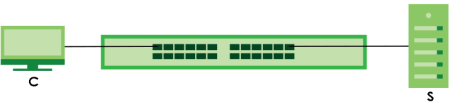

Port Authentication Overview
IEEE 802.1x – An authentication server validates access to a port based on a user name and password provided by the user. A user that fails an authentication server can still access the port, but traffic from the user is forwarded to the guest VLAN port.
MAC Authentication – An authentication server validates access to a port based on the MAC address and password of the client.
Guest VLAN – In either mode, if authentication fails the Switch can still allow the client to access the network on a Guest VLAN.
Compound Authentication – An authentication server validates access to a port based on combination of IEEE 802.1x and MAC Authentication. There are two modes:
Loose: The client authenticates using either IEEE 802.1x authentication or MAC Authentication.
Strict: The client authenticates using both IEEE 802.1x authentication and MAC Authentication.
*All types of authentication use the RADIUS (Remote Authentication Dial In User Service, RFC 2138, 2139) protocol to validate users. You must configure a RADIUS server before enabling port authentication.
*If you enable IEEE 802.1x authentication and MAC authentication on the same port, the Switch performs IEEE 802.1x authentication and MAC authentication. If a user fails to authenticate either through the IEEE 802.1x or MAC authentication method, then access to the port is denied.
*IEEE 802.1x is not supported by all user operating systems. For details on compatibility, see your operating system documentation. If your operating system does not support 802.1x, you must install 802.1x client software.
*To enable port authentication, first activate the port authentication methods (both on the Switch and the ports), then configure the RADIUS server settings in the SECURITY> AAA > RADIUS Server Setup > RADIUS Server Setup screen.
