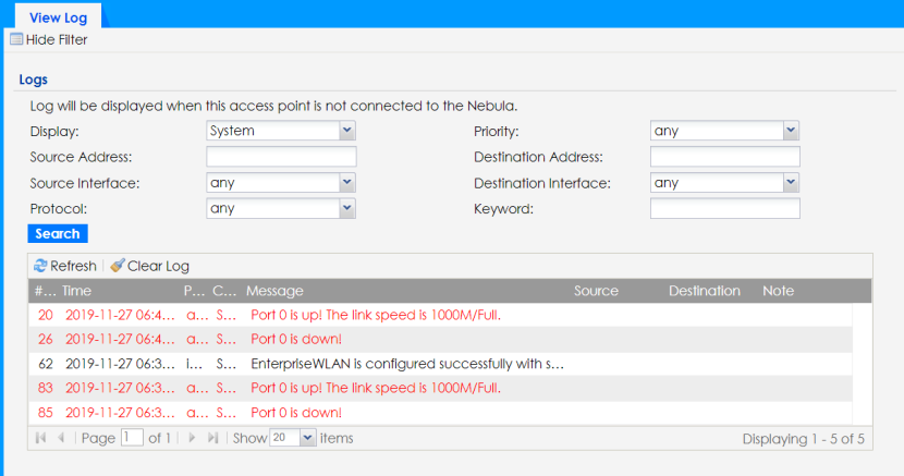

• The Log > View Log screen (View Log) displays the Root (Plus)’s current log messages when it is disconnected from the NCC.

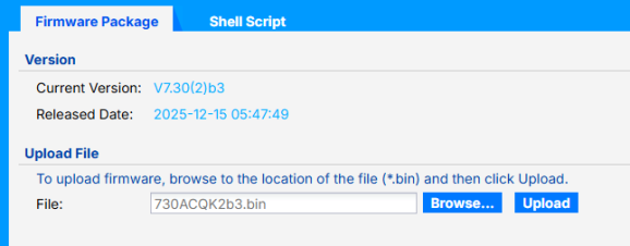

Firmware Package
Click Maintenance > File Manager > Firmware Package to open this screen. Use the Firmware Package screen to check your current firmware information and upload firmware to the Root (Plus). You can manually download the new firmware from the Zyxel website.
*The Web Configurator is the recommended method for uploading firmware. You only need to use the command line interface if you need to recover the firmware. See the CLI Reference Guide for how to determine if you need to recover the firmware and how to recover it.
The firmware update can take up to five minutes. Do not turn off or reset the Root (Plus) while the firmware update is in progress!
Label
Description
Version
Current Version
This is the firmware version.
Released Date
This is the date that the version of the firmware was created.
Upload File
File Path
Enter the location of the file you want to upload in this field or click Browse... to find it.
Browse...
Click Browse... to find the .bin file you want to upload. Remember that you must decompress compressed (.zip) files before you can upload them.
Upload
Click Upload to begin the upload process. This process may take up to two minutes.

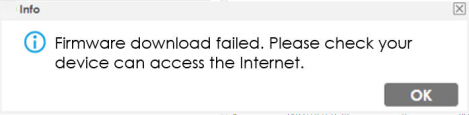

Firmware Download Failed
The following pop-up messages display the causes and solutions for firmware download failure.
Firmware download failed due to an Internet error. Refer to Internet Access for more information.
Firmware Download Failed. Check Internet Access

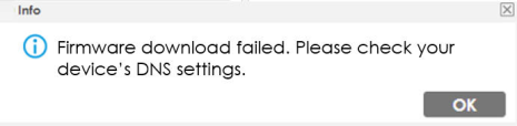

Firmware download failed due to a DNS problem. Please check your device's DNS settings.
Firmware Download failed. Check DNS Setting

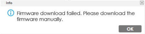

Firmware download failed. Download the new firmware manually from the Zyxel website. Then, go to the Maintenance > File Manager > Firmware Package screen to upload the new firmware.
Firmware Download Failed. Download Manually

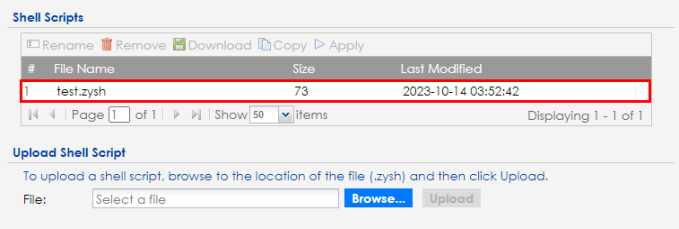

Shell Script

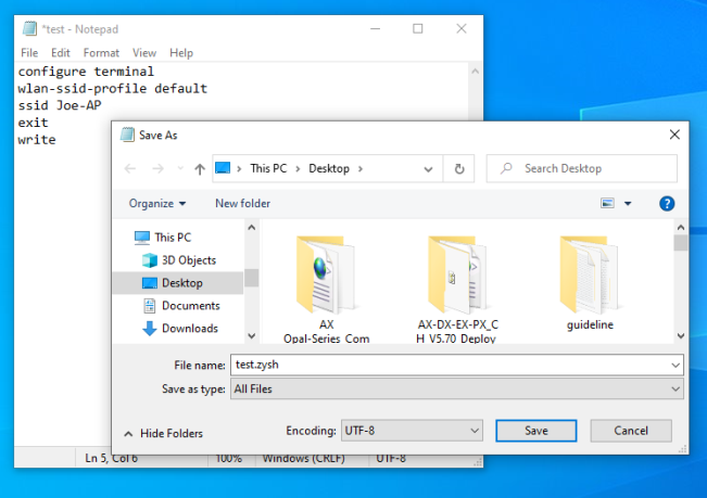

A shell script is a list of commands to manage the Root (Plus). Use a text editor to create the shell script files. They must use a “.zysh” filename extension. For example, test.zysh.

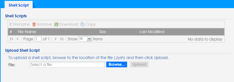

Click Maintenance > File Manager > Shell Script to open this screen. Use the Shell Script screen to store, name, download, and upload shell script files. You can store multiple shell script files on the Root (Plus) at the same time.

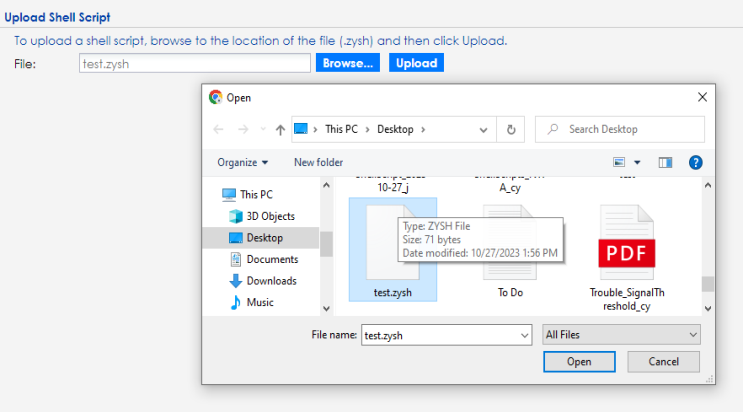

1 In the text editor, save the shell script with a .zysh filename extension. Select All Files as the file type.
2 Go to the Maintenance > File Manager > Shell Script screen. Click Browse... to upload the .zysh file.
3 Click Upload. The uploaded shell script will be shown in the Shell Scripts field.
Each field is described in the following table.
Label
Description
Shell Scripts
Rename
Use this button to change the label of a shell script file on the Root (Plus).
You cannot rename a shell script to the name of another shell script in the Root (Plus).
Click a shell script’s row to select it and click Rename to open the Rename File screen.
Specify the new name for the shell script file. Use up to 25 characters, including the following characters inside the square brackets [a-zA-Z0-9;‘~!@#$%^&()_+[]{}’,.=-)].
Click OK to save the renamed file or click Cancel to close the screen without saving a renamed file.
Remove
Click a shell script file’s row to select it and click Delete to delete the shell script file from the Root (Plus).
A pop-up window asks you to confirm that you want to delete the shell script file. Click OK to delete the shell script file or click Cancel to close the screen without deleting the shell script file.
Download
Click a shell script file’s row to select it and click Download to save the configuration to your computer.
Copy
Use this button to save a duplicate of a shell script file on the Root (Plus).
Click a shell script file’s row to select it and click Copy to open the Copy File screen.
Specify a name for the duplicate file. Use up to 25 characters, including the following characters inside the square brackets [a-zA-Z0-9;‘~!@#$%^&()_+[]{}’,.=-)].
Click OK to save the duplicate or click Cancel to close the screen without saving a duplicate of the configuration file.
Apply
Use this button to have the Root (Plus) use a specific shell script file.
Click a shell script file’s row to select it and click Apply to have the Root (Plus) use that shell script file. You may need to wait awhile for the Root (Plus) to finish applying the commands.
This column displays the number for each shell script file entry.
File Name
This column displays the label that identifies a shell script file.
Size
This column displays the size (in KB) of a shell script file.
Last Modified
This column displays the date and time that the individual shell script files were last changed or saved.
Upload Shell Script
File
Browse...
Click Browse... to find the .zysh file you want to upload.
Upload
Click Upload to begin the upload process. This process may take up to several minutes.

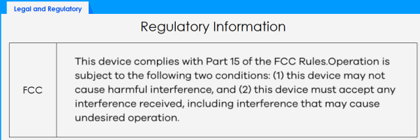

Legal and Regulatory
Use this screen to view the information on legal and regulatory. This screen may not display depending on the Root (Plus) model you are using.
Maintenance > Legal and Regulatory > Legal and Regulatory

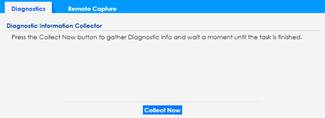

Diagnostics
This screen provides an easy way for you to generate a file containing the Root (Plus)’s configuration and diagnostic information. You may need to generate this file and send it to customer support during troubleshooting, as they may require information in these screens. All categories of settings and shell script files stored on the Root (Plus) will be included in the diagnostic file.
Click Maintenance > Diagnostics > Diagnostics to open the Diagnostics screen. Click Collect Now to have the Root (Plus) create a new diagnostic file.

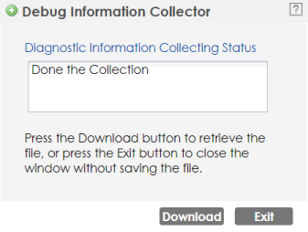

The Debug Information Collector screen then displays showing whether the collection is in progress, was successful, or has failed. When the data collection is done, click Download to save the most recent diagnostic file to a computer.
Maintenance > Diagnostics > Diagnostics: Debug Information Collector

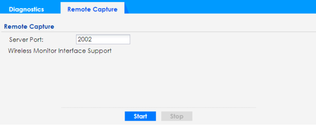

Remote Capture
Use this screen to capture network traffic going through the Root (Plus) and output the captured packets to a packet analyzer (also known as network or protocol analyzer) such as Wireshark. If the Root (Plus) is connected to the Zyxel gateway or ZyWALL, you might need to configure the Zyxel gateway or ZyWALL to allow remote capture on the Root (Plus). Customer support may require access to troubleshoot remotely.
Click Maintenance > Diagnostics > Remote Capture to open the Remote Capture screen.
Label
Description
Server Port
Enter the number of the server port you want the packet analyzer to connect to in order to capture traffic going through the Root (Plus). The default port number is 2002.
Start
Click this button to allow the packet analyzer to start capturing traffic going through the Root (Plus).
Stop
Click this button to stop the packet analyzer from capturing traffic going through the Root (Plus).
View Log
The NCC periodically gathers log files from the devices being managed by it. Before the NCC pulls logs from the Root (Plus) or when the Root (Plus) is disconnected from the NCC, you can use this screen to view its current log messages. To access this screen, click Maintenance > Log > View Log.
*When a log reaches the maximum number of log messages, new log messages automatically overwrite existing log messages, starting with the oldest existing log message first.
Events that generate an alert (as well as a log message) display in red. Regular logs display in black. Click a column’s heading cell to sort the table entries by that column’s criteria. Click the heading cell again to reverse the sort order.
Label
Description
Show Filter / Hide Filter
Click this button to show or hide the filter settings.
If the filter settings are hidden, the Display field is available.
If the filter settings are shown, the Display, Priority, Source Address, Destination Address, Source Interface, Destination Interface, Protocol, Keyword, and Search fields are available.
Display
Select the category of log message(s) you want to view. You can also view All Logs at one time, or you can view the Debug Log.
Priority
This displays when you show the filter. Select the priority of log messages to display. The log displays the log messages with this priority or higher. Choices are: any, emerg, alert, crit, error, warn, notice, and info, from highest priority to lowest priority. This field is read-only if the Display is Debug Log.
Source Address
This displays when you show the filter. Enter the source IP address of the incoming packet that generated the log message. Do not include the port in this filter.
Destination Address
This displays when you show the filter. Enter the IP address of the destination of the incoming packet when the log message was generated. Do not include the port in this filter.
Source Interface
This displays when you show the filter. Select the source interface of the packet that generated the log message.
This displays when you show the filter. Select the destination interface of the packet that generated the log message.
Protocol
This displays when you show the filter. Select a service protocol whose log messages you would like to see.
Keyword
This displays when you show the filter. Enter a keyword to look for in the Message, Source, Destination and Note fields. If a match is found in any field, the log message is displayed. You can use up to 63 alphanumeric characters and the underscore, as well as punctuation marks ()’ ,:;?! +-*/= #$% @ ; the period, double quotes, and brackets are not allowed.
Search
This displays when you show the filter. Click this button to update the log using the current filter settings.
Refresh
Click this to update the list of logs.
Clear Log
Click this button to clear the whole log, regardless of what is currently displayed on the screen.
This field is a sequential value, and it is not associated with a specific log message.
Time
This field displays the time the log message was recorded.
Priority
This field displays the priority of the log message. It has the same range of values as the Priority field above.
Category
This field displays the log that generated the log message. It is the same value used in the Display and (other) Category fields.
Message
This field displays the reason the log message was generated. The text “[count=x]”, where x is a number, appears at the end of the Message field if log consolidation is turned on and multiple entries were aggregated to generate into this one.
Source
This field displays the source IP address and the port number in the event that generated the log message.
Source Interface
This field displays the source interface of the packet that generated the log message.
Destination
This field displays the destination IP address and the port number of the event that generated the log message.
This field displays the destination interface of the packet that generated the log message.
Protocol
This field displays the service protocol in the event that generated the log message.
Note
This field displays any additional information about the log message.

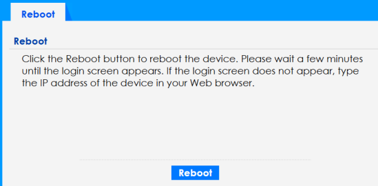

Reboot
This screen allows users to restart the Root (Plus) remotely. To access this screen, click Maintenance > Reboot > Reboot.
Reboot is different from reset; reset returns the Root (Plus) to its default configuration.
You may reboot your Root (Plus) when the Internet connection is slow or intermittent.
Label
Description
Reboot
Click Reboot then click Yes to restart the Root (Plus) immediately.
After the Root (Plus) reboots, wait a few minutes until the login screen appears. If the login screen does not appear, type the IP address of the Root (Plus) in your Web browser.
