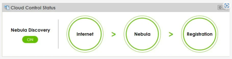

I cannot see my Nebula Devices in the NCC Dashboard.

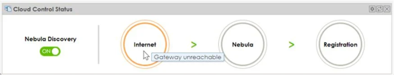

• Check the Nebula Device’s Web Configurator’s Dashboard. The Cloud Control Status displays the status of the Nebula Device’s Internet and NCC connection and registration status. Make sure that the Nebula Device has NCC Discovery enabled.
• If the Nebula Device cannot connect to the Internet or NCC, hover the mouse over the Internet circle to check the error message. Check your local network settings.
• Make sure that your Nebula Device can connect to the NCC by checking your network’s firewall/security settings. The following ports must be allowed:
• TCP: 22, 443, 4335 and 6667
• UDP: 123
*Go to Help > Support tools > Firewall information to find the latest port information.
• Make sure that you have registered your Nebula Devices with the NCC. See License & Inventory Overview Screen.
• Make sure that you have created an organization and site and added the Nebula Devices to the site. See Create Organization.
• When the Nebula Device is online in NCC, all circles are green.

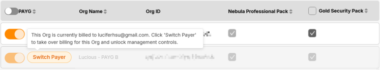

I am the organization owner. I cannot deactivate, delete, or change the organization access privileges of a delegated administrator.
You cannot deactivate, delete, or downgrade a delegated administrator who is responsible for PAYG management and payment of a PAYG organization. In this case, you or another delegated administrator must first take over PAYG management and billing on the Zyxel Circle website. See the Circle User's Guide for more information about account registration, sign-in, and billing when the PAYG payer changes.
1 Log in to Circle and go to My Devices > On-cloud > Pay As You Go.
2 Hover over to your PAYG organization to know the current PAYG payer. If the delegated administrator is the current PAYG payer, click Switch Payer to take over PAYG management and billing.
Once the payer has been changed, you can deactivate, delete, or downgrade the delegated admin Organization-wide > Administrators in Nebula.

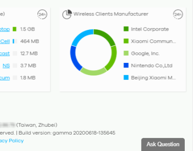

NCC Live Chat
Clicking the Ask Question button at the bottom of NCC window prompts you to search for a solution on the Zyxel forum, and then connects you to a Zyxel technical support agent. If a technical support agent is not available, you can fill in a form to send your question to Zyxel by email.
*This is an NCC Professional Pack feature.
Live chat might be limited to a certain number of hours per day. The time that live chat is available varies depending on your country.
