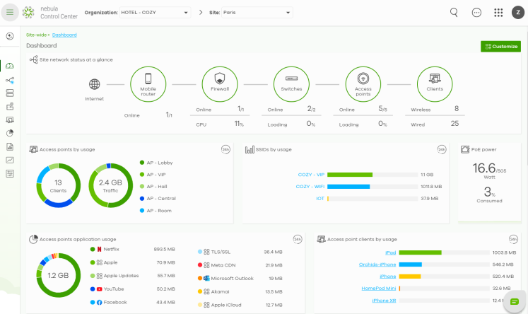

NCC Dashboard
Each Zyxel Device must belong to a site which must be in an organization. You can configure each Zyxel Device on its own or configure a set of Zyxel Devices together in a site. You can also monitor groups of sites in organizations.

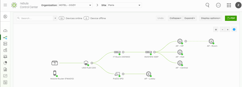

You can use the Topology in NCC which graphically presents your device and network statistics. It shows an overview of your network topology, as shown in the following figure. See the NCC User’s Guide for how to configure Nebula managed devices.
NCC Topology
*Make sure your network firewall allows TCP ports 443, 4335, and 6667 as well as UDP port 123 so the Zyxel Device can connect to and sync with the NCC.

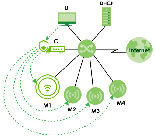

The following figure illustrates a wireless network managed by an APC. You (U) configure the APC (C), which then automatically updates the configurations of the managed APs (M1-M4).
Controller Managed AP Application
*Not all models support APC management. See Zyxel Device Product Feature Comparison for more information.
*If the Zyxel Device is already registered to NCC, the APC will be unable to manage it.

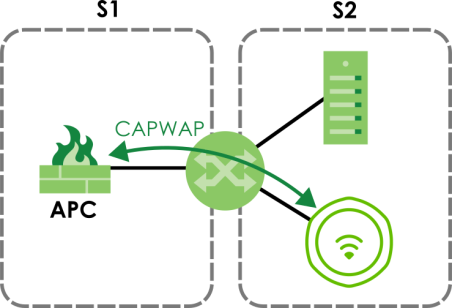

APC management and IP Subnets
An APC uses Control And Provisioning of Wireless Access Points (CAPWAP, see RFC 5415) to discover and configure multiple managed APs. By default, CAPWAP works only between Zyxel Devices with IP addresses in the same subnet.
However, you can configure the Zyxel Device and the APC to use CAPWAP with IP addresses in different subnets by doing the following.
• Activate DHCP. Your network’s DHCP server must support option 138 defined in RFC 5415.
• Configure DHCP option 138 with the IP address of the APC on your network.
DHCP Option 138 allows the management request (from the Zyxel Device) to reach the APC in a different subnet, as shown in the following figure.
CAPWAP and DHCP Option 138

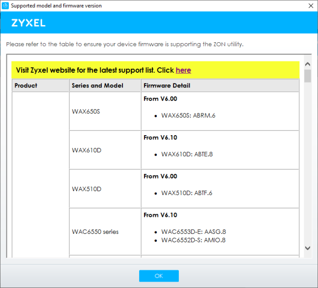

2 The first time you run the ZON Utility, you will see if your device and firmware version support the ZON Utility. Click the OK button to close this screen.
Supported Devices and Versions
If you want to check the supported models and firmware versions later, you can click the Show information about ZON icon in the upper right hand corner of the screen. Then select the Supported model and firmware version link. If your device is not listed here, see the device release notes for ZON Utility support. The release notes are in the firmware zip file on the Zyxel web site.
