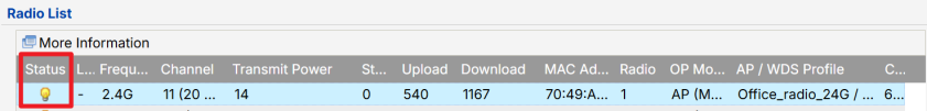

3 Go to Monitor > Wireless > AP Information to check the status of each radio band. A gray lightbulb in the Status column indicates that this radio band is inactive.

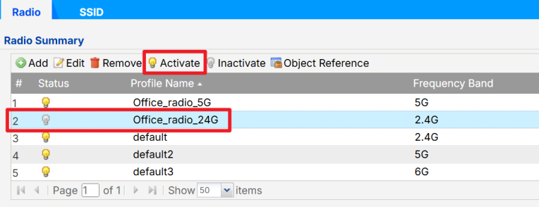

4 Go to Configuration > Object > AP Profile > Radio to activate the Radio Profile that you assign to the affected radio band. Click Apply.

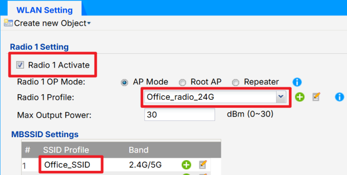

5 Go to Configuration > Wireless > AP Management, and check the following:
• Select the Radio Activate check box to activate this radio band.
• Select the Radio Profile that you activated earlier. If you select an inactive Radio Profile, this radio band will remain inactive even if the Radio Activate check box is selected.
• Select the SSID Profile that you want to use.
• Click Apply.
If the SSID is not assigned to any radio, it is not broadcast. In MBSSID Settings, make sure the SSID is assigned to at least one 2.4 GHz, 5 GHz, or 6 GHz radio.

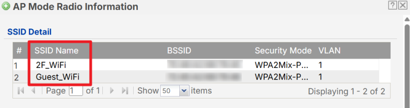

6 The radio band should now be active. Go to Monitor > Wireless > AP Information and check the Status column. A yellow lightbult indicates that this radio band is active.
7 Select the radio band and click More Information to see the SSID Name.

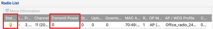

Insufficient power supply
9 Go to Monitor > Wireless > AP Information and check the Status column. If the Status lightbulb is yellow, but the Transmit Power is 0, it indicates that the radio band is active but is not transmitting WiFi traffic.

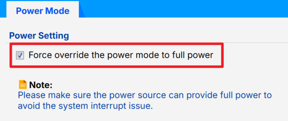

10 Verity that the Zyxel Device is connected to a supported power source. Use a compatible PoE switch or PoE injector to ensure the Zyxel Device receives sufficient power. See Supported PoE Standards for your Zyxel Device.
11 If the Zyxel Device still has no Transmit Power, and you are using a passive PoE injector that does not support IEEE 802.3at/bt PoE negotiation, go to Configuration > System > Power Mode, select Force override the power mode to full power, and click Apply.
*Do not enable this option when using an IEEE-compliant PoE switch or PoE injector, as the Zyxel Device automatically negotiates the required power.
